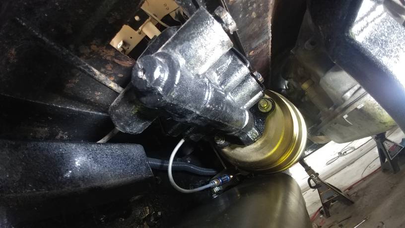

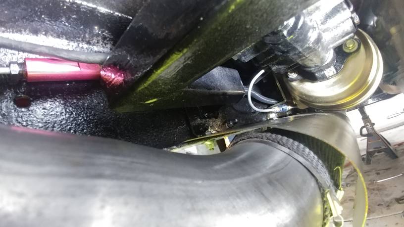

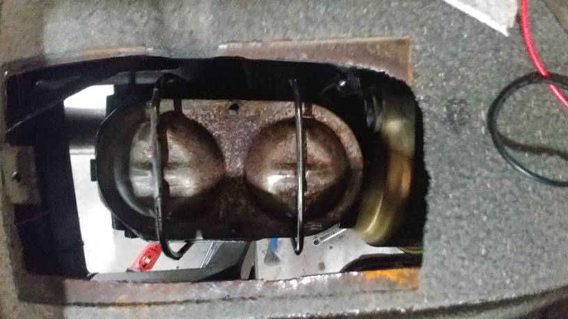

  10. phoenix5x
    Joined: Dec 26, 2007
    Posts: 241
    phoenix5x
    from Ohio
    Heres some pics..
    So the master cylinder is under the cab of the truck and the master cylinder booster combo is facing toward the front of the truck. In the pic that booster is toward the front..So when I say dual resevoir I got a single master cylinder with 2 reservoirs..simple plumbing where a single line comes from the front res into a 2psi valve and the rear res goes to another valve. So unkess I misunderstand the workings of a master cylinder the front circuit and rear circuit are separate...
    When I bleed the rear the pedal goes to the floor as it should
    When I bleed the front calipers I push the pedal and,then crack a bleeder and the pedal Only goes about an inch and stops...fluid comes out of the front bleeder until the pedal stop but I still got anither 2 to 3 inches before the pedal would hit the floor.
    Now in writting this I should mention this MC was on this truck without a booster and worked fine...in rebuilding the truck I added the booster...now it was under the floor as well but never paid attention to which res was plumbed to which side of the vehicle. Could this MC need the rear res plumbed to the front as if it were mounted on the firewall?
    Sent from my VS995 using The H.A.M.B. mobile app
  11. What calipers on the front?

    A couple of things. If it were me I would try to replicate how it was installed in the truck. Also did you fabricate a pushrod or use the one from the truck? Any chance it is simply too short? Also if I recall correctly the rear chamber of the brake reservoir goes to the disc or front, and the front chamber one goes to the rear or drums.
    59Apachegail, VANDENPLAS and F-ONE like this.
  13. Unless it’s a quick take up master, it makes zero difference which reservoir goes to which end...I wish people would quit saying it does. If there are different size reservoirs then the bigger one will go to the discs, only because of the increased volume required for wear compensation, as far as function, Zero difference
  14. GordonC
    Joined: Mar 6, 2006
    Posts: 2,876
    GordonC
    Just trying to help out and offering information from what I have read or understand. If it makes zero difference help me understand why most of the major car companies do it the way they do?
    Desoto291Hemi likes this.
  15. No idea why it’s generally done that way. But I can assure you it will work either way. Same as people being worried about whether it’s a disc or drum master, what’s important is the bore size. As I said reservoir size is important however if one makes sure it doesn’t run out of fluid as the brakes wear then no big deal. There are lots of things in our industry that have been perpetrated over and over again. Especially brakes.
    Just to clarify I wasn’t trying to pick on anybody, also just trying to clarify things.
    I still would like to know what calipers, before I offer a theory.
    winduptoy and GordonC like this.

    Pop the cover off. Are both reservoirs the same size? If one is larger, that one goes to the front disks.
