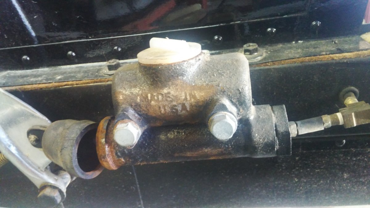

    20161012_153853.jpg Can any one identity this master cylinder? Need to replace

    Looks like a jeep master cylinder dorman m2796. It bolts on to a 49-51 Mercury. 1 inch bore. [​IMG]
