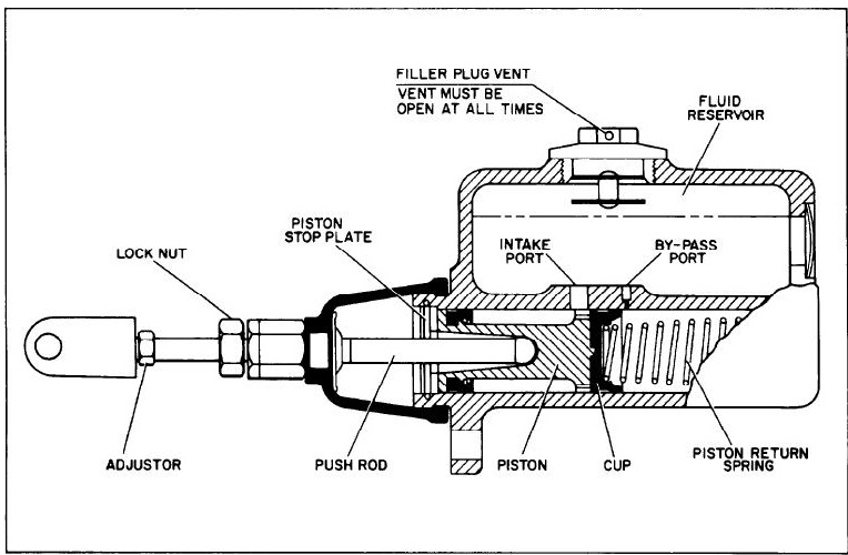

    master.jpg maybe there's a little tiny hole between the reservoir and the bore, that is blocked. Try cleaning it more?

    Thanks Jim,
    I'll clean the ever-livin' crap out of it again!
    That diagram is definitely helpful!
  4. VoodooTwin
    Joined: Jul 13, 2011
    Posts: 3,455
    VoodooTwin
    from Noo Yawk
    Clean the cap's vent hole too.

  7. stimpy
    Joined: Apr 16, 2006
    Posts: 3,547
    stimpy
    check the ports in the metal piston behind the cup to make sure they are clean as if they are blocked the return will be slow as it form a vacuum in the front portion of cylinder those ports allow a quick release .
  8. S2X01
    Joined: May 15, 2011
    Posts: 153
    S2X01
    Well, I took everything back apart again. The bypass hole was plugged so I cleaned that out. Did a thorough cleaning again and everything seems to be working. It's back on the frame right now. Gonna try bleeding it out today and see what happens.....
