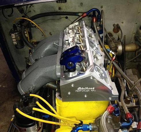

    Since no one else has started a March Banger thread I guess I will. For those who remember my Dodge Bros. banger with the Morton & Brett head and wondered what happened to it. The rear exhaust port on the head fell apart when we went to start it. After more than a year trying to get it repaired, I gave up. Here is Zenon and my thoughts on a new Small block MoPar head for the thing. lots of cutting and welding before this one fits. But at least it's aluminum. So the welding is much more readily done. PS. If you like the injection, I will gladly sell you the other half. I bought a V8 set for the MoPar head. Pretty cool.

  3. Very cool Rich, can you throw out some flow numbers?

  6. Rich,
    pretty nice setup.
    the chambers look good.
    how much HP do you expect?
    j

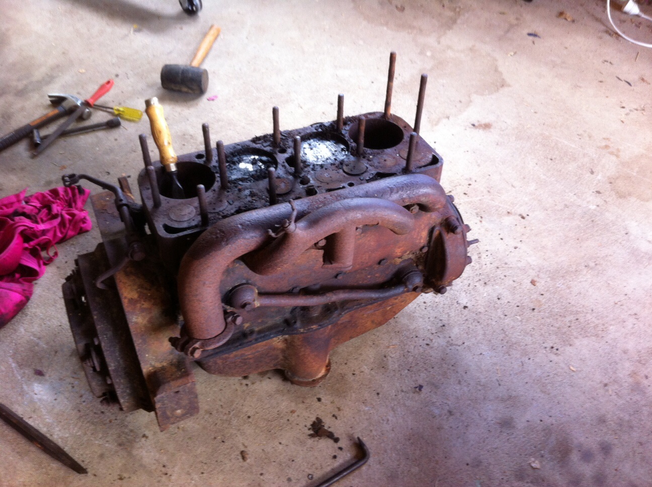

  15. Hello all,
    New to the banger forum here, always admired from the distance as been mostly a inline 6 and V8 type of guy.
    But the last few months owing a Ford Model a banger has become a slowly spreading disease,,,
    Well yesterday I finally picked up this early 28 motor (has a different clutch I have been told as later motors have)
    Been sitting behind a farmers shed at least 20 years, expected the worst but found it great behind the tons of oil/dirt/tar stuck to the outside after taking it to a car wash.
    The head was sitting a few mm off the block so expected a huge rusted mess, after using degreaser and CRC/WD40 finally pulled the head off and found a great rebuilder by the look of it :)
    Sump is too far gone but the remainder looks ok.
    Question,
    Cleaned off one of the pistons looking for a oversize stamp,, found none and just a stamp saying "Front". Do all early pistons show oversize on piston crown or do I have a never been rebuilt motor?
    Canadian motor if that helps.
  16. Could well be stock bore - my diamond B block is. Whereas my early '28 block has been sleeved back and rebored to plus 30 and the sleeves are now 12 thou out of round….
    Is yours a 5-bearing cam block?
  17. I will find out in the next few days after I get the clutch/flywheel off and on my engine stand, been reading that it should have the 5 cam bearings.
    Don't know if that is good or bad if it is 5 bearings, also has the different diamond shape crank as I found looking in through the breather after I removed it.
    Cannot complain, was only $100 and a few hours work getting it out into my trailer.
  18. Crazydaddyo
    Joined: Apr 6, 2008
    Posts: 3,345
    Crazydaddyo
    Rich,
    Looks like a fun project. I believe it will make more power then the M&B head. Please keep us up to date on each step of the process. I'm interested in how you will deal with the head studs. Thanks for sharing
  19. RichFox
    Joined: Dec 3, 2006
    Posts: 10,020
    RichFox
    The plan is to bore through the head in the locations of the existing studs. Weld in 1 inch 6061 bars that are drilled 33/64. On the intake side a one inch plate will be bolted to the manifold face of the now stretched head, surfaced with the heads deck and and drilled for four stud holes. A 1.125 spacer will need to be put in the center of the head to get the cylinders and combustion chambers to line up. It will also be drilled for a head stud. Seems like it should work. Oh yeah. The plate on the intake side will also provide an adapter for the Hilborn injector shown. Although I bought a MoPar small block set, it is for the W9 race heads. The blot spacing is wider than the shown head and the ports bigger. This thing has 2 5/8 throttle bores. If anybody wants the other side it's for sale. Hilborn feather lite. Magnesium casting. Just what your banger needs.
  20. Crazydaddyo
    Joined: Apr 6, 2008
    Posts: 3,345
    Crazydaddyo
    I certainly can be done. Bill Stipe did it to a SBC head, and I have an Olds 455 head that George Miller adapted too. Both for the A/B block.

  24. RichFox
    Joined: Dec 3, 2006
    Posts: 10,020
    RichFox
    I looked at the 455 Olds head. Liked it a lot. Didn't you have to use a billet cam to make up for the different intake and exhaust sequence? Zenon really liked the 318 type of head. Don't know why. But the valve sequence was right and it is easier to adapt existing fuel injection manifolds to the LA type head.
  25. Crazydaddyo
    Joined: Apr 6, 2008
    Posts: 3,345
    Crazydaddyo
    Yes, special cam need for the Olds head.

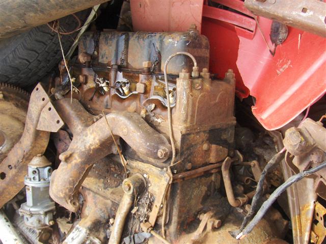

  28. 117harv
    Joined: Nov 12, 2009
    Posts: 6,589
    117harv
    I ran across his banger today, can someone help with an I.D./year? That's a model T cross member next to it.
