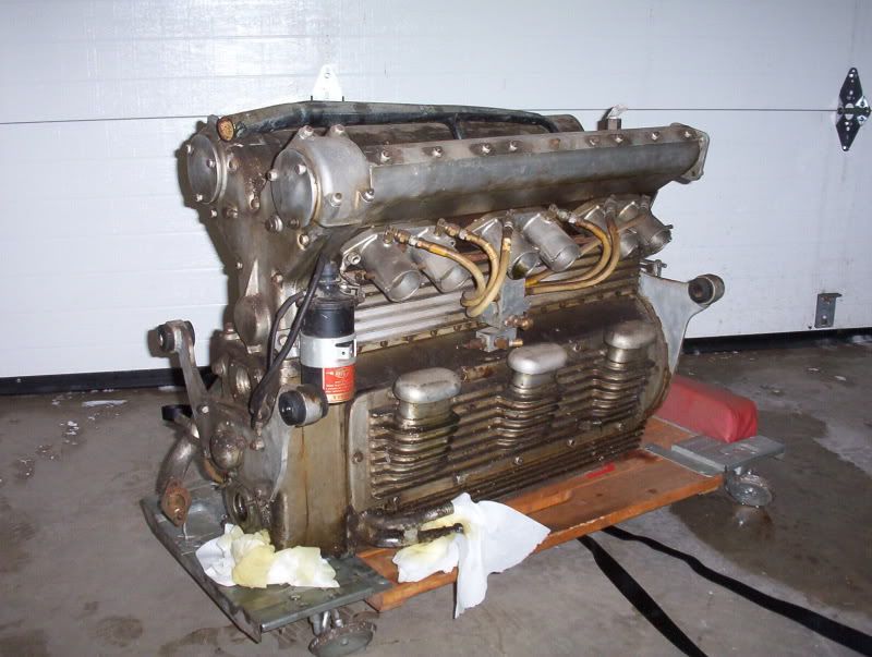

    One of the main issues they had with the Offy was in how they converted it to run on pump gas. With decades of hindsight this conversion isn't impossible but for a variety of reasons the motor didn't make power and wasn't reliable. As far as not using a 6 cylinder Offy...well, the main reason is probably that there was only one of those ever made.
    This wasn't simply a problem that Cunningham faced. Lance Reventlow, in his quest to build a completely American GP car tried to use Offy power in his single seater Scarabs. Besides putting the engine at the wrong end of the car, it also had its fair share of problems when it came to power and reliability.
    Cunningham and Reventlow could afford to dream big and make mistakes under the guise of patriotism. The world was a far more interesting and beautiful place thanks to them.

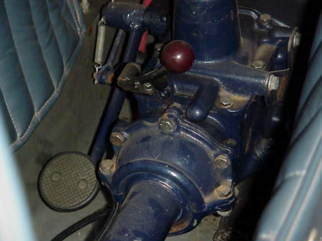

    has any one any advice on setting up a reverse lockout when fitting a borgwarner overdrive

    Here a lock-out on the Miller's A-box Sorry it's so dark only photo I have

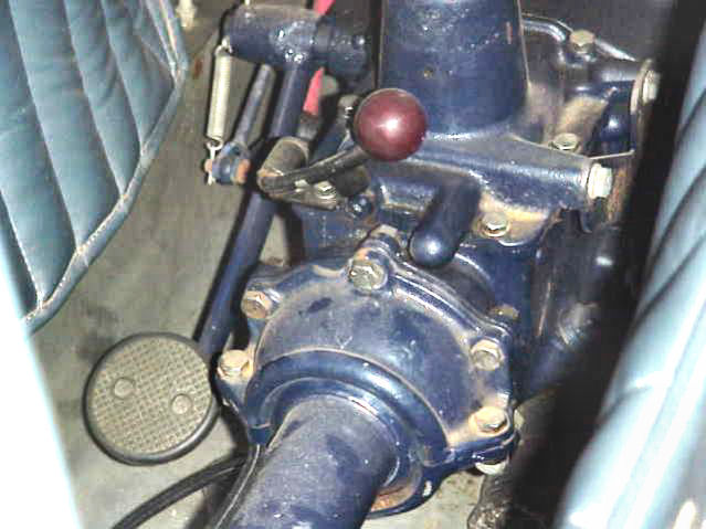

    here you are Bluto a little lighter
    Dick

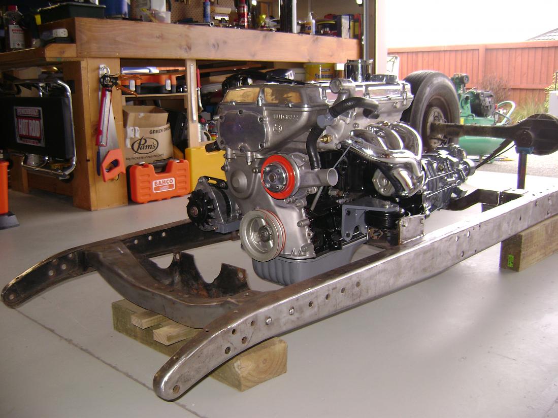

    Man IM GUNNA GET SHOT DOWN for this ,here's our modern 'banger' ....give it to me I can take it :D
  24. Crazydaddyo
    Joined: Apr 6, 2008
    Posts: 3,345
    Crazydaddyo
    Is that a fiberglass body?
    That is more of a no no here then the engine!!!!!!
  25. Say's who!
    I like the dash.

    Thanks Bluto was going to use a laycock-de normanville which has a better ratio but decided the houseing was too light if i was to go off road New Zealand back country roads can be rough so i have put in a quickchange as well as the overdrive hope to have a strong unit
