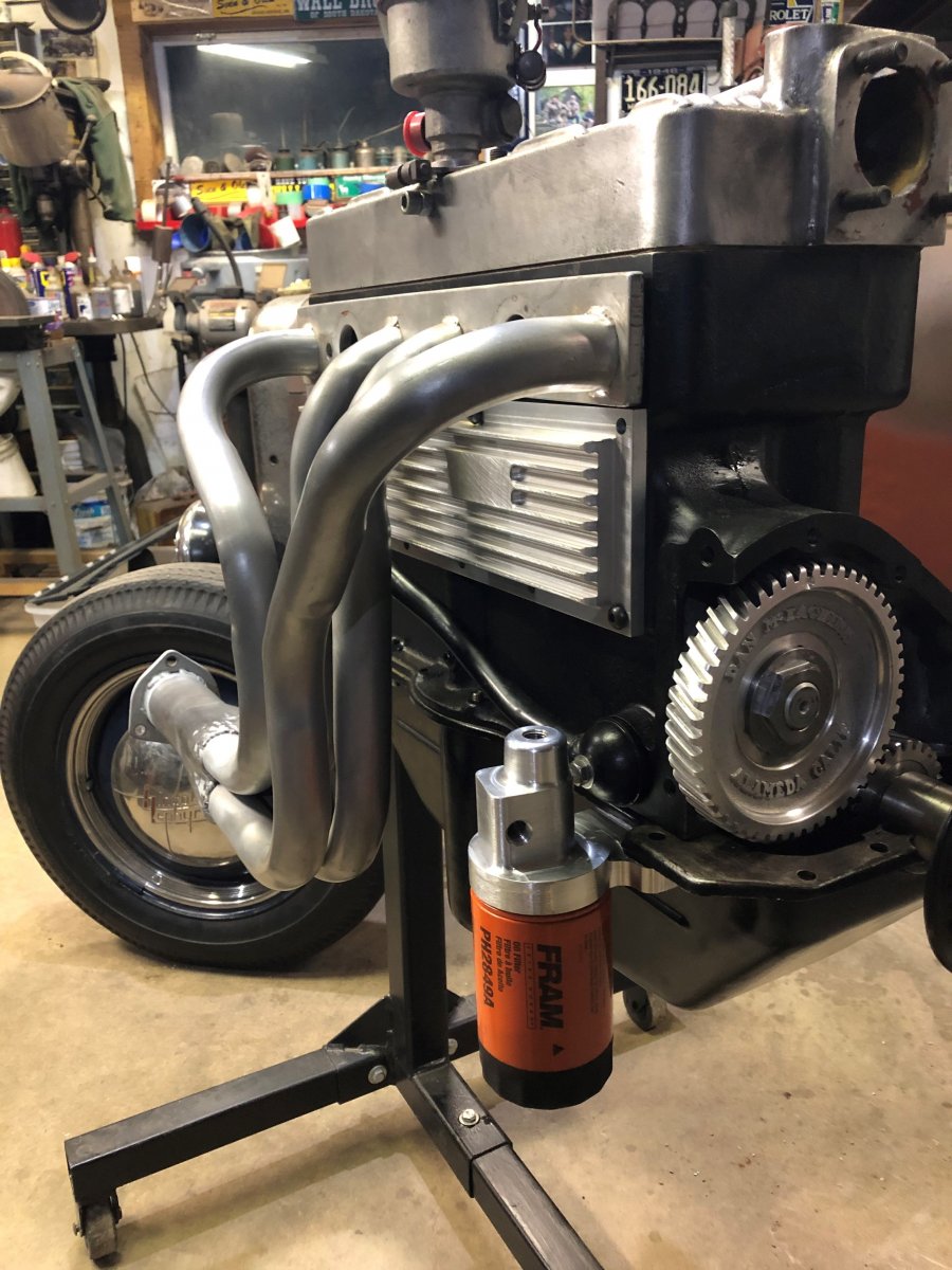

    brjnelson
    hotrodA, Jet96, burl and 7 others like this.

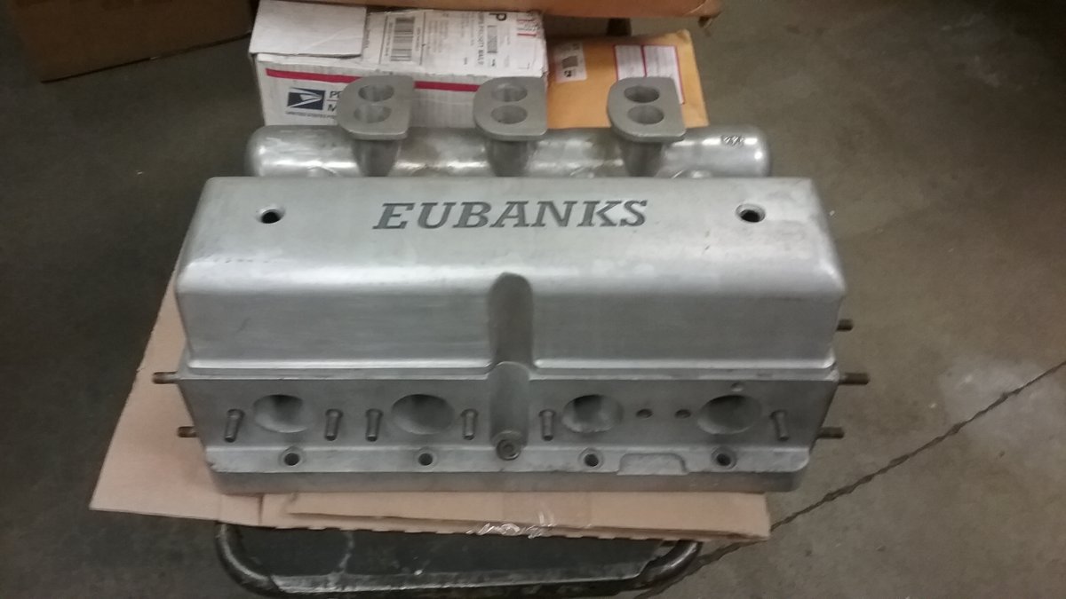

    I got a call from Dan Eubanks when he was closing his pattern shop. I went over there to see what he was getting rid of. I ended up buying some patterns, but also bought one of the heads he finished.
    20181108_132336(0)(1).jpg IMG_20131229_161656_zpsdd832e4b.JPG Rockers.JPG IMG_20131229_161704_zps0463e04b.JPG

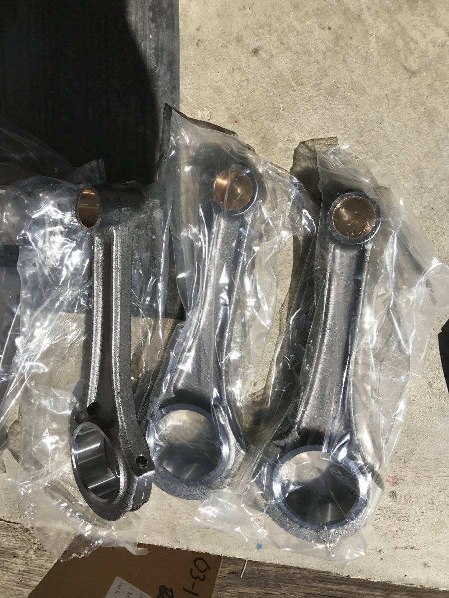

    Here are few pics. Picked it up this morning.
    Hope pics show.
    Blk next... B-gift so got to geet past slobbering over crank, rods !
    Rods BEEEFY, and numbered for guys like me
    Who never had tinker toys to assemble.
    CRANK is beautiful !!

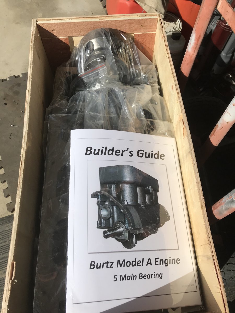

  26. hardtimesainit
    Joined: Jan 24, 2009
    Posts: 608
    hardtimesainit
    Hey Retson,
    Here’s THE block !!
    I feel a little like a FORD assembly guy must have felt... messing with new caste iron !
    This thing is really HEAVY.
    WHAT a beautiful piece of equipment !!
    brjnelson, Star 351, Jet96 and 6 others like this.

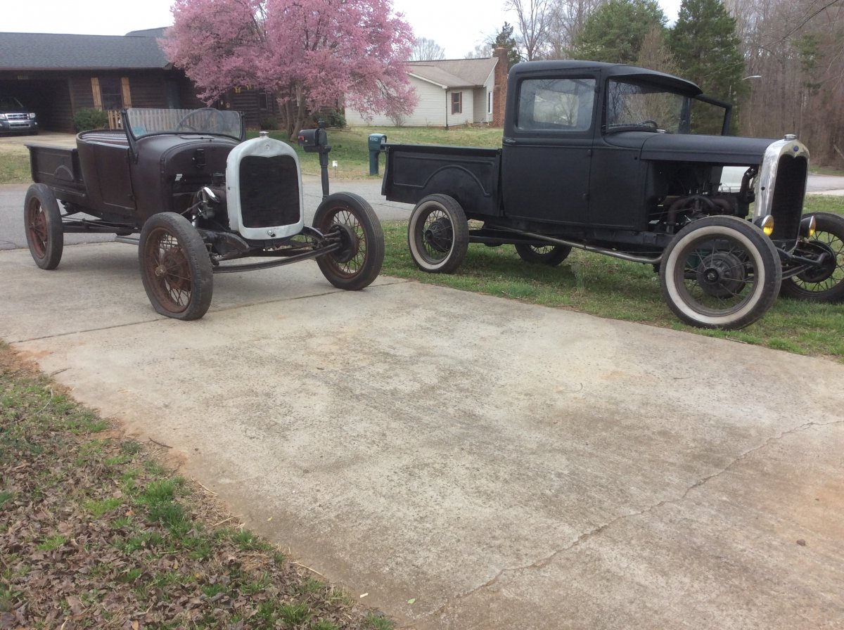

    D0A105F5-5F17-45A3-96E2-04F8C39729CA.jpeg Checking in for March....we’ll the downside to getting Covid and being outta work for 3 weeks is it gave me a chance to finish my 31 widebed pickup...now I got 2 banger powered jalopy’s to play with! I took it out for the first time last weekend, did a few laps around the neighborhood....
