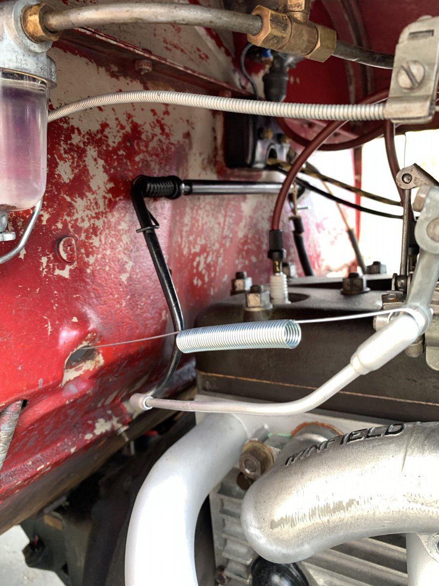

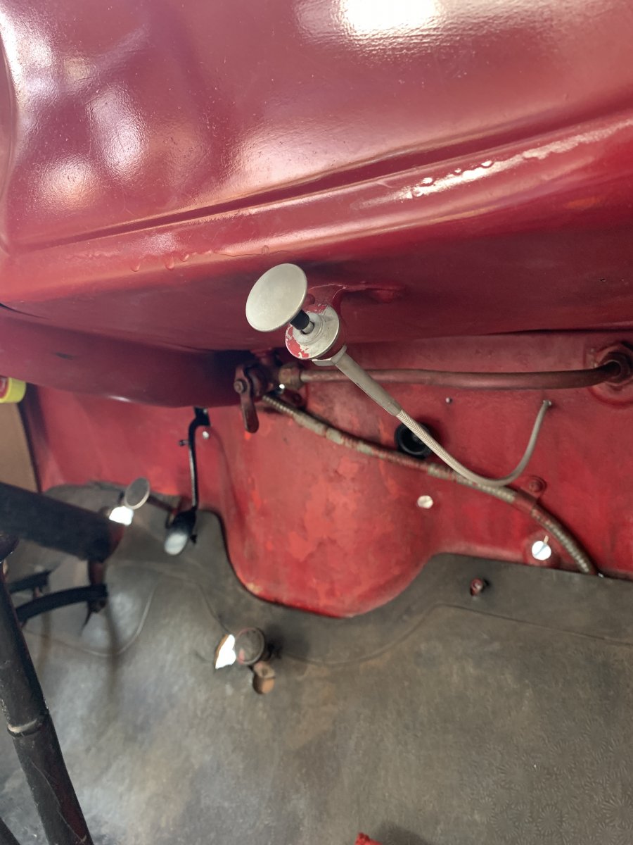

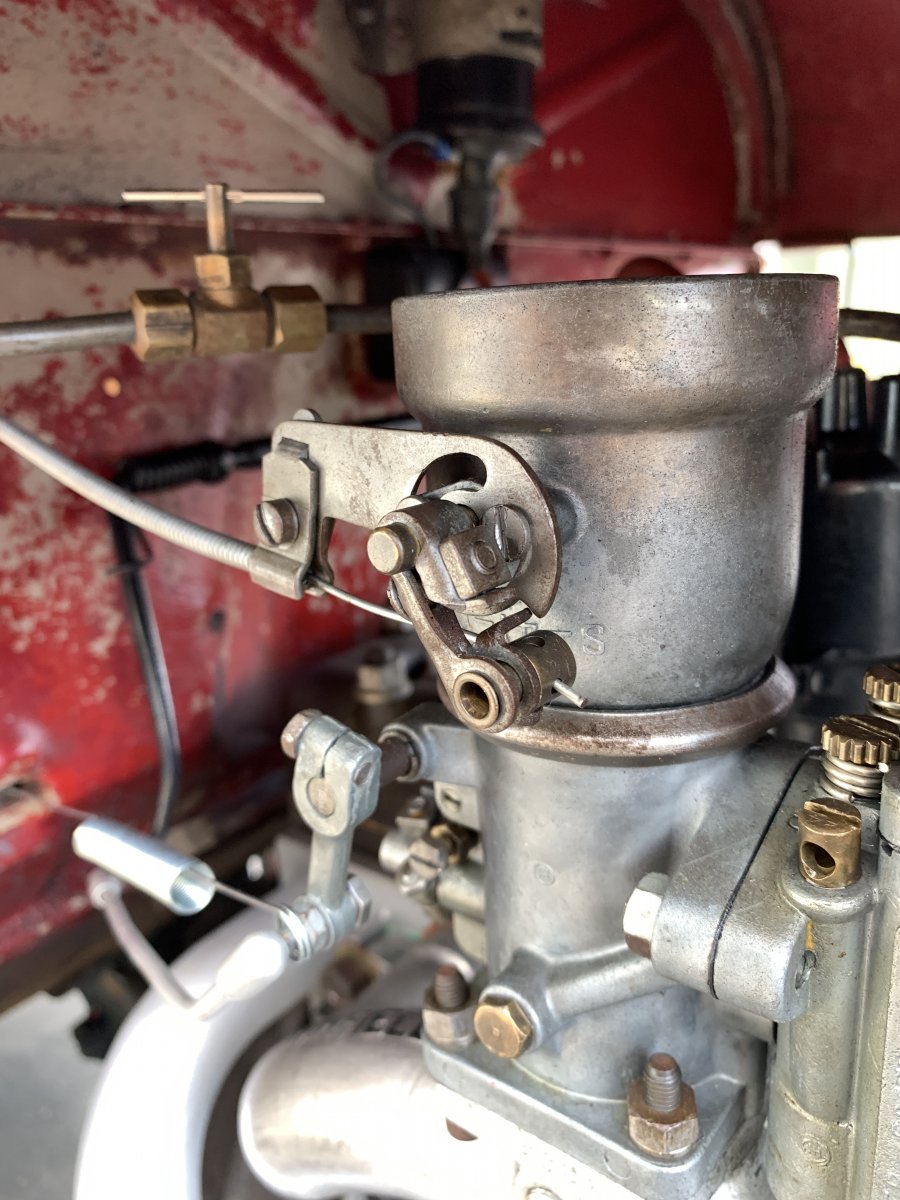

    Loosen the clamp that holds the cable housing at the carburetor and make sure the tension is off of it. That will make one creep closed

    I like your set up. I know you said you kinked the cable, but you tried slightly bending the solid part of the rod just under the knob? Sometimes that works.

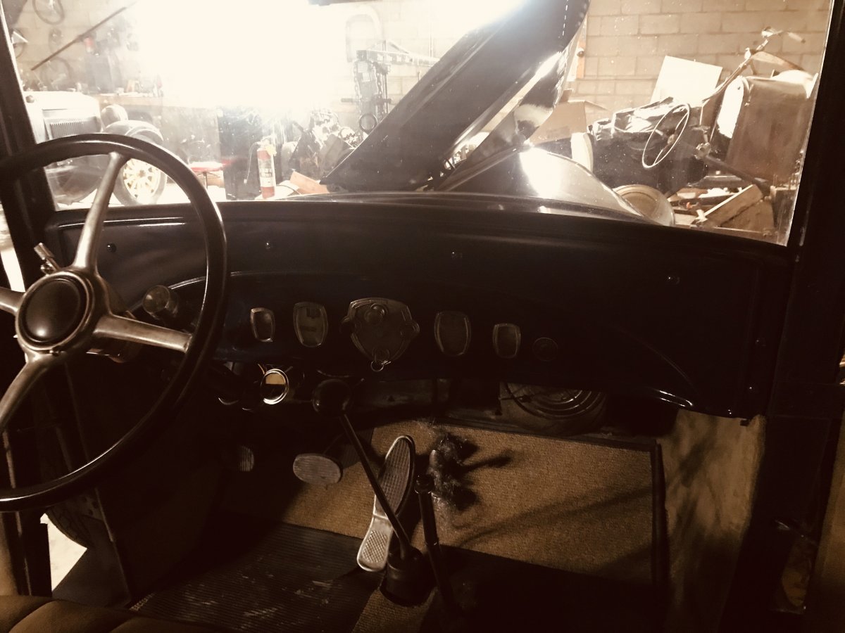

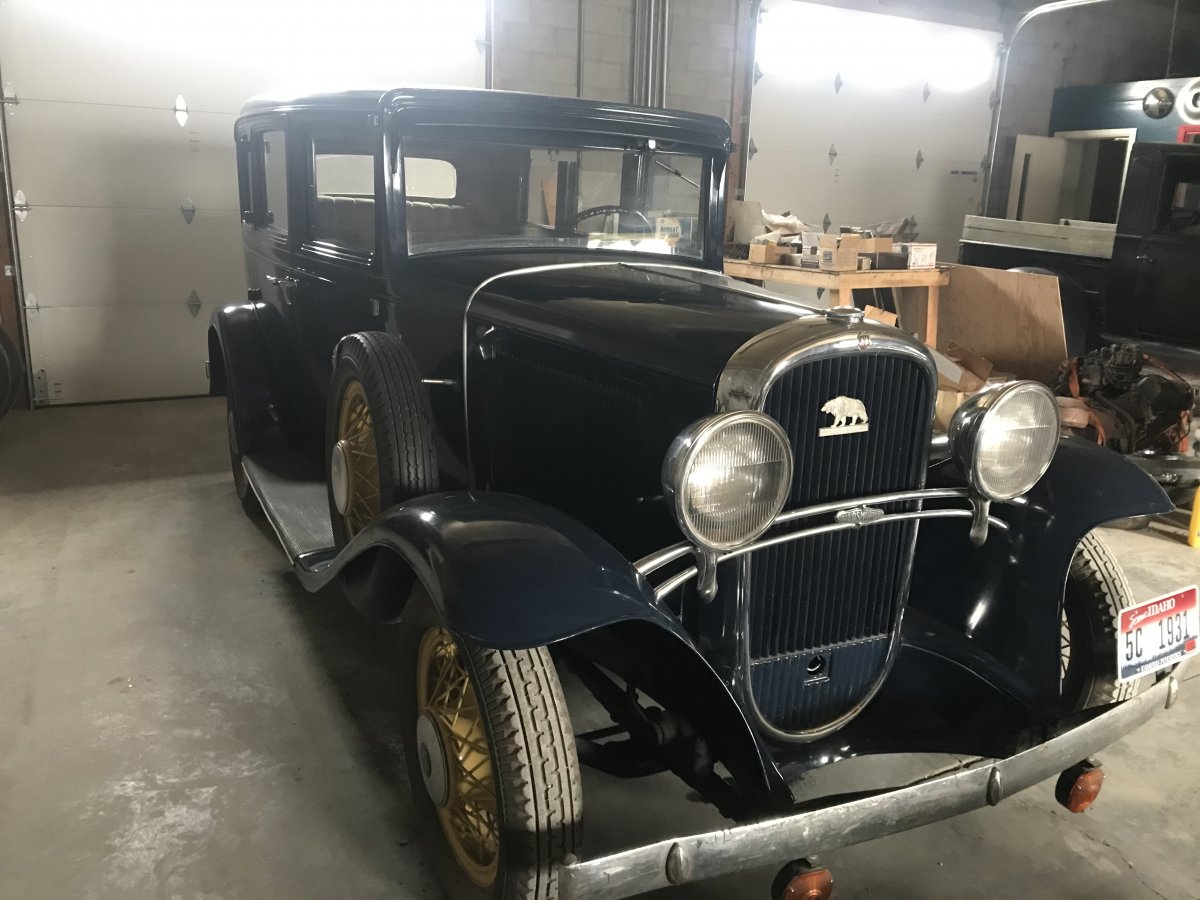

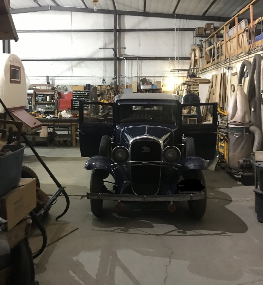

    Not much getting done on the bangers, super busy working. I bought a car I rode in 31 years ago. A friend bought it in '70 and restored the paint and interior. It's only had about 500 miles put on it since, parades and such. His wife had severe health issues (unfortunately)so he finally sold it to me.
    Not a banger but I figured you guys would appreciate it.

    Winduptoy-'31 Olds, pretty cool car. All original save for paint/interior.Very solid feeling. Purrs like a cat, lots of torque. Cool stromberg DXR-2 downdraft, first downdraft. Idle mixture is at the top, main jet is adjustable in the side. It really looks like updraft stuff moved around haha.
    The sheepwagon is a restoration. He's done stagecoach and wagon restorations for museums etc, for years. I've joked with him about selling the Olds forever, just didn't figure it would be this way. He's happy to keep it in the family so to speak.
    He did say if he caught wind of dual carbs and split manifolds he'd call the sherrif heheh

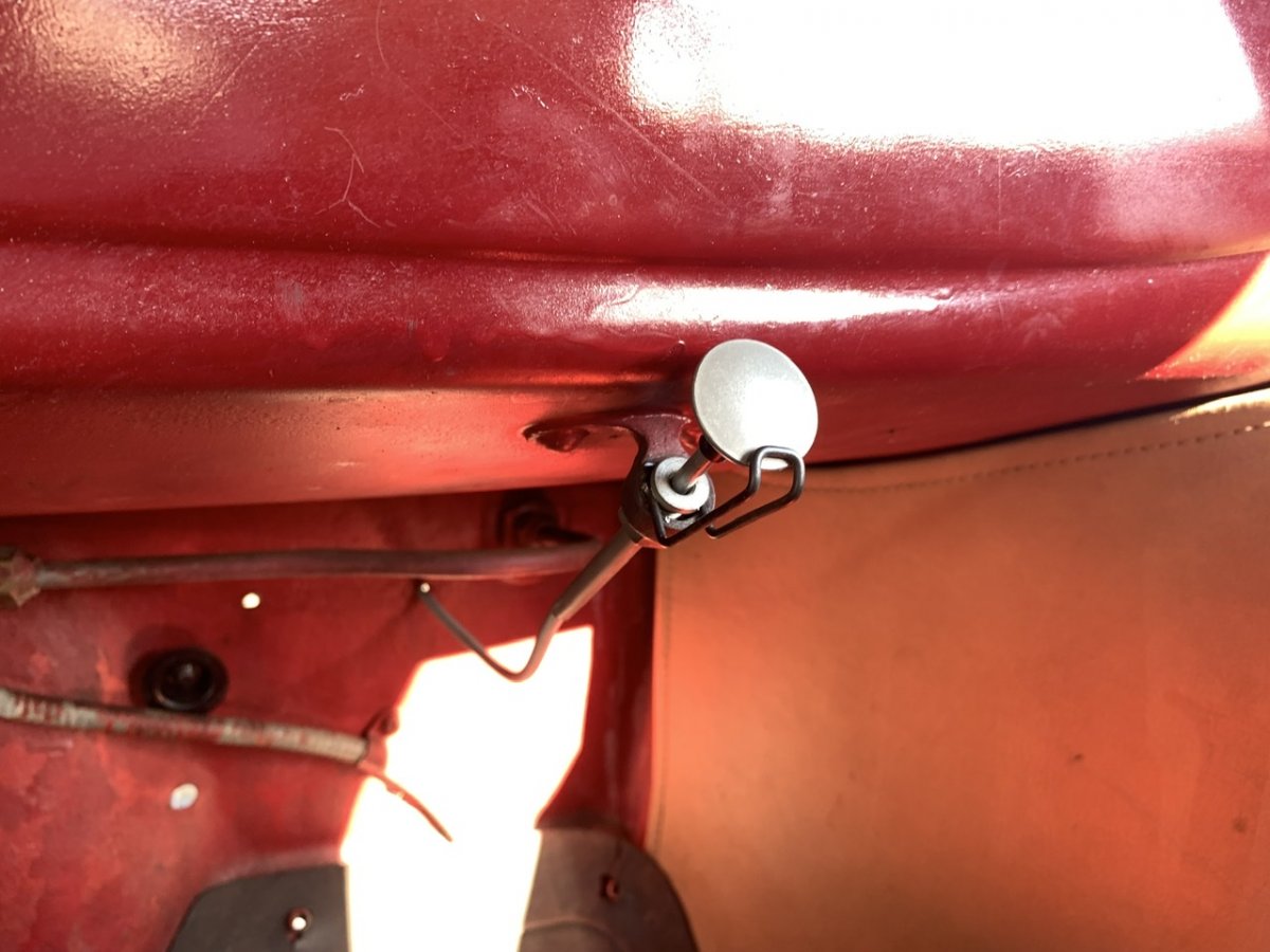

    I fixed my choke cable problem. I used a left over brake hardware spring, bent to shape. The cable won’t move on it’s own anymore.

    very good fix . shade tree mechanics are still alive !!

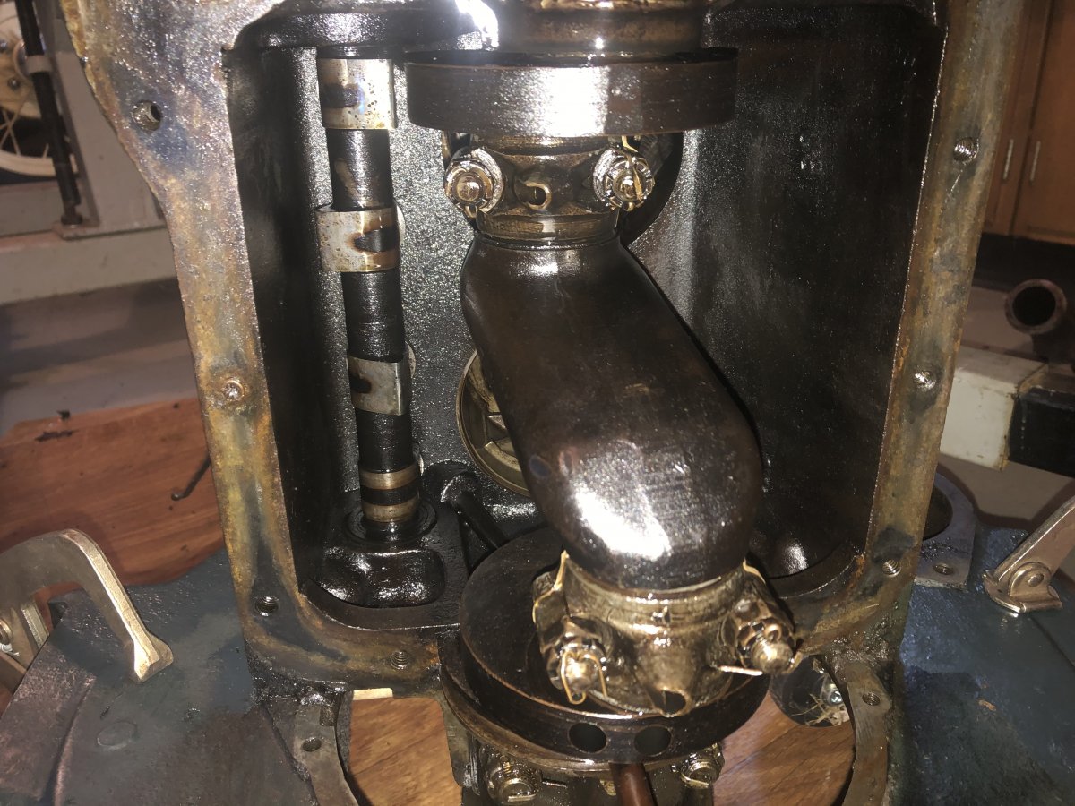

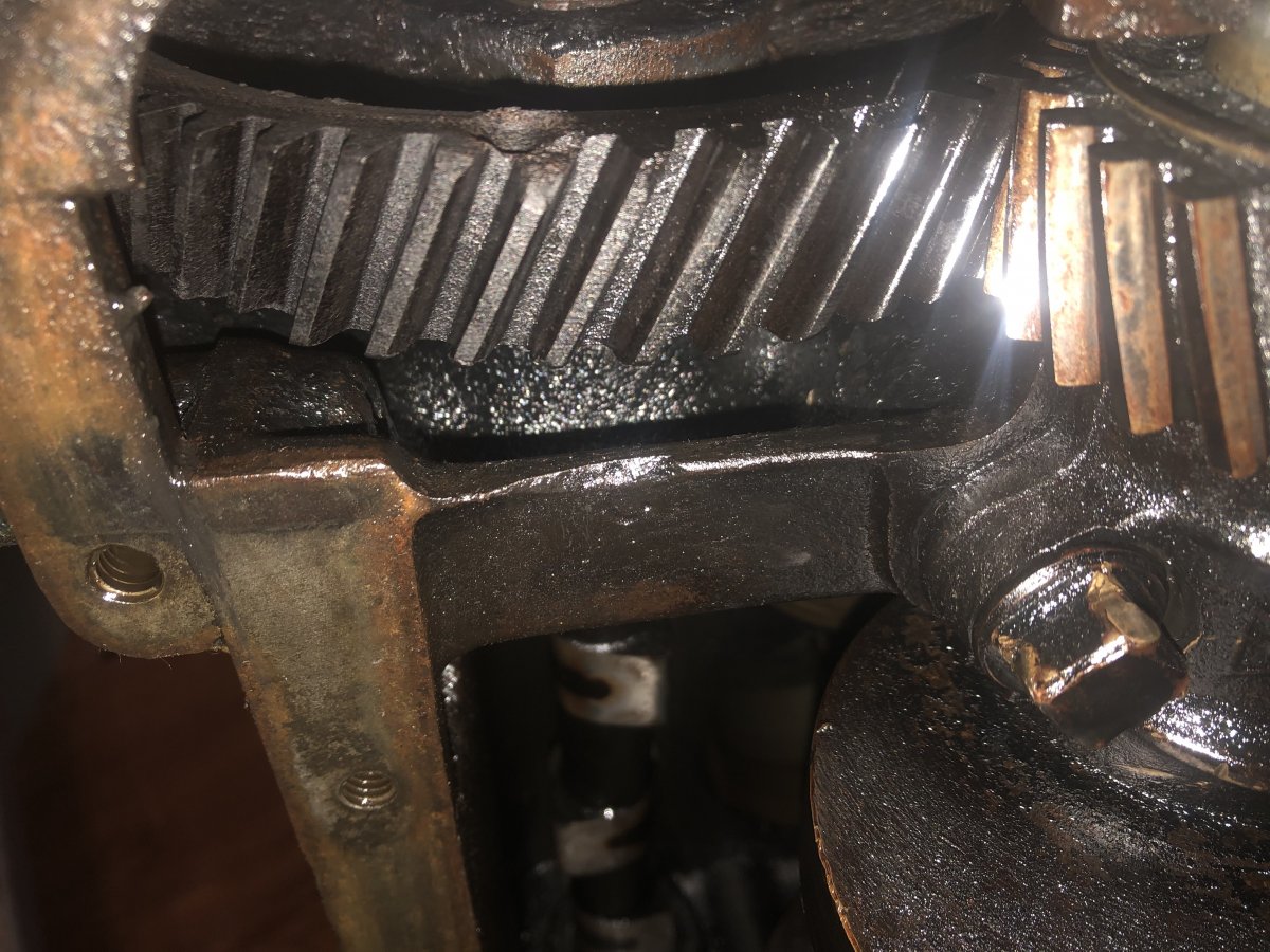

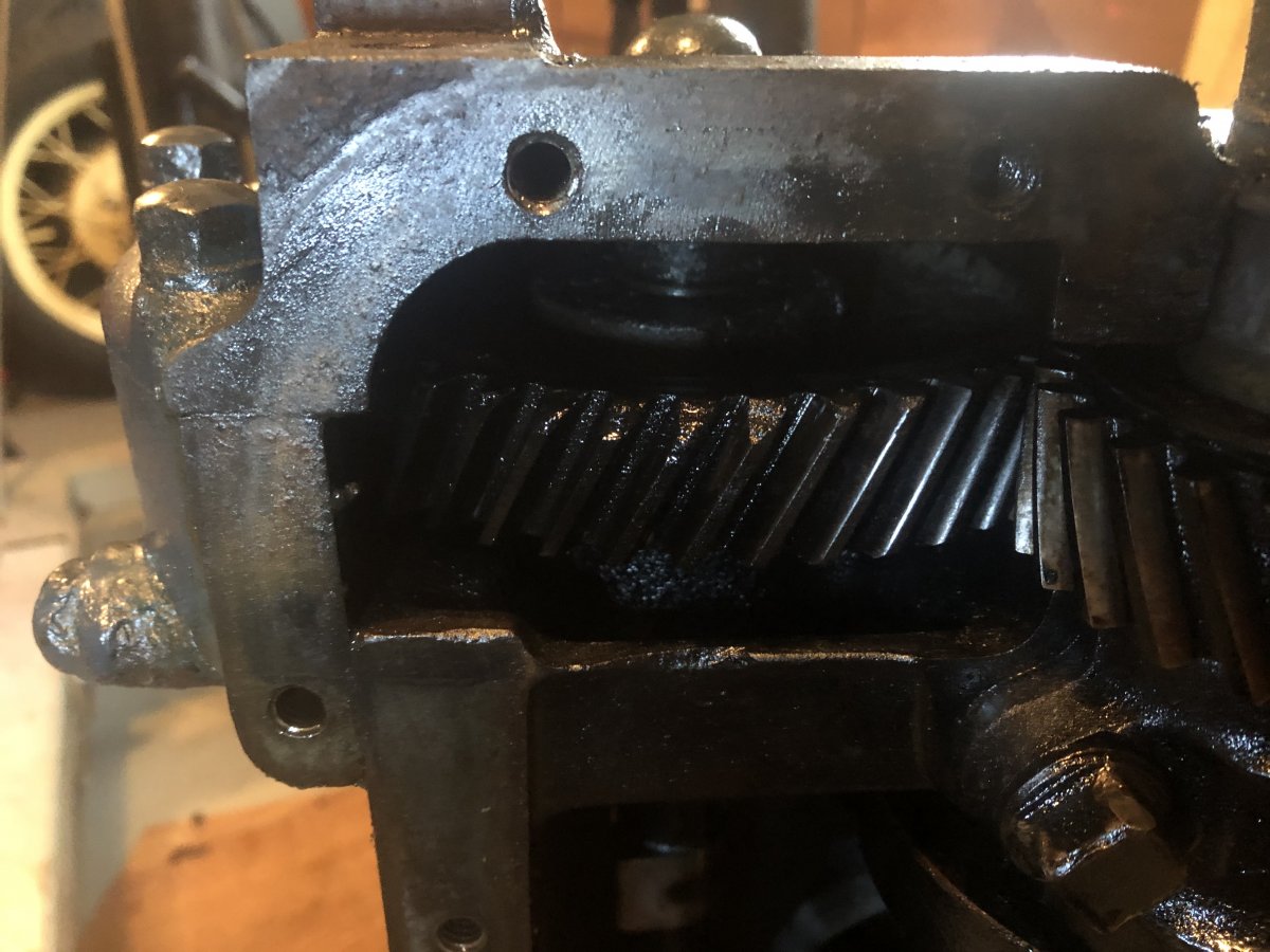

    Decided to drop the pan on the cheap engine I picked up prior to installing into my coupe.
    The fella I bought it from had no history on it.
    I saw it had 20 over pistons when I swapped the head for a 6.1 Snyders.
    Fortunately, there wasn’t much sludge.
    Before I throw it back on, might you take a peak and give me some advice?
    This is supposed to be cheap, not a rebuild. Anything you might do before wrapping it back up?
    51D7337A-80FD-4B2C-B955-BBD8FDB36658.jpeg 31C5627F-6F2A-4B41-8A95-5FAE70AC4031.jpeg 2371ED6F-324A-4D04-A05B-62B643BB0C86.jpeg 5DE8A78D-438D-4569-82D2-C0457434664F.jpeg

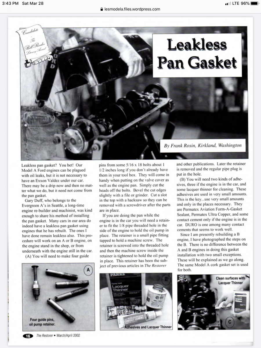

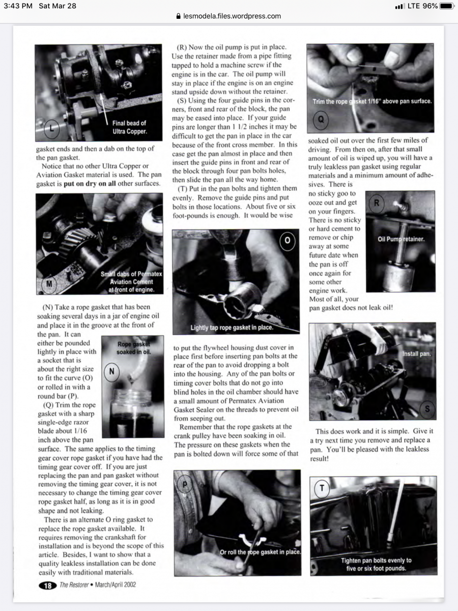

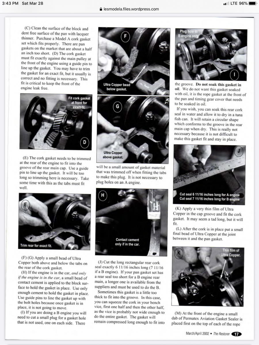

    Forgot to mention, found this article on replacing the gasket
    And I plan on rebuilding the oil pump for good measure.
    122FD802-B52B-47FF-9EBA-1F533A6A79CD.png 7A4203E1-BB10-4FF0-82D5-41C2BB1F85DF.png ACA4956B-7BE8-47B0-8D65-F31CD18A70A4.png
