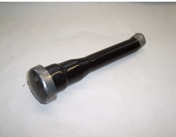

    I too felt couped up. Good time for a drive with little to no traffic. Boulder CO off in the distance. F62D95F6-6E9B-4EFA-87CB-BA2BE03F3A31.jpeg I found my oil filler leaking after my drive, a cheap repop type that does not press tight.
    I found this, claimed to be for 33-34 B motor. True? F4280FB1-98F2-4978-AFA8-9B71A1E35DF0.jpeg

    Cap looks right...but the rest of it doesn't. Is it for sale online...I'd check with
    Steve at Burts he is in your neighborhood
    I always have to use some sealant on the filler tube to block

    i extended mine & sealed at the block . no leaks

    Here is a listing on HAMB Classifieds for one and it is the 'improved' oil fill tube qabd cap. Kind of pricey in my mind, I know the one I got from Steve at Burts was a lot less....and then I lost the cap

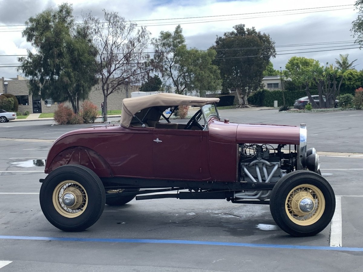

    It stopped raining, so it’s drive the banger to work day.
    On a side note, my cheapie choke cable keeps vibrating open (choke closed). Does anyone have any bright ideas? I already kinked the cable a little and it just slowed it down.

    i am using a solid wire (like lawn mower or many things) , no springs etc . just a push & pull .
    been using for several years & always the same . stays where i put it .
    nice car !!

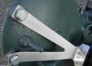

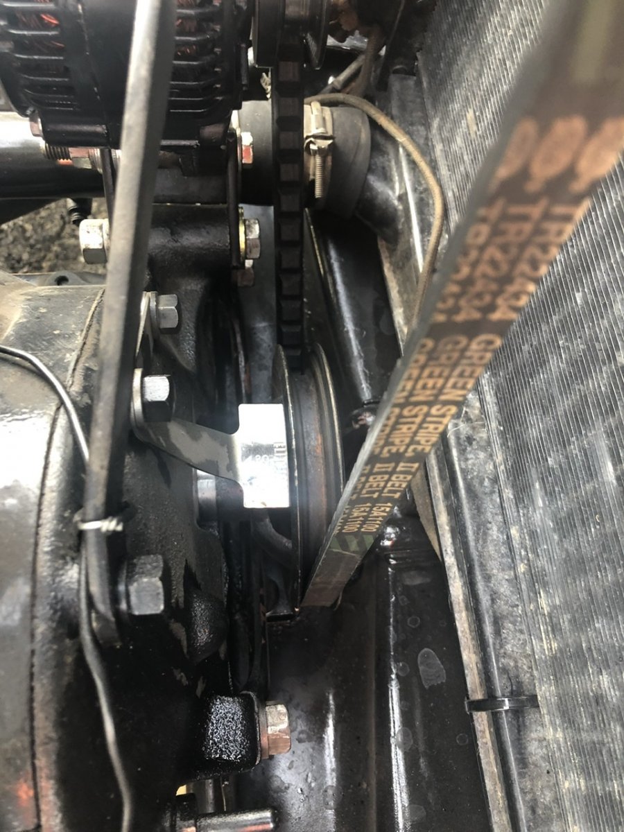

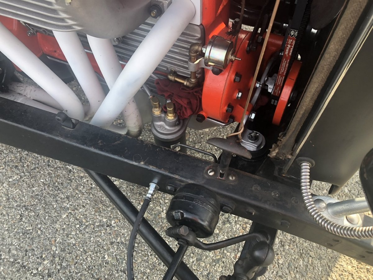

    D37A5C13-B4F8-4F11-9757-5E02C1DA0AFF.jpeg A56B6840-E64A-4299-ACFB-F8B55808C599.jpeg 47684019-655C-48A0-A00F-4E651827E279.jpeg Does anyone know where I can get a timing indicator? I’ve searched to no avail.

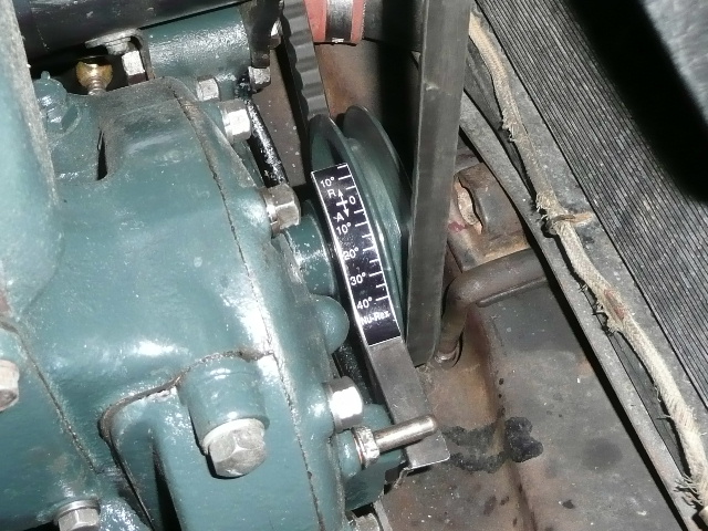

    yes it does . i use one like that , works well . be sure when you mark your pulley , that #1 is at tdc ... important

    Purchased mine from brattons

    as john said ........ TDC is most important !!!!
