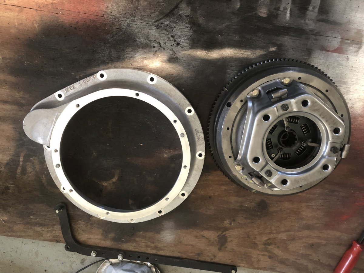

    Got a Clings adapter kit for cheap(ish) and bought a lightened flywheel/V8 pressure plate from Snyders.
    I’ve had one before in a car I sold, but I wasn’t the one to install.
    Any advice?
    I also picked up recently a V8 trans with a 28 tooth gear set. Hope that’s the right one for the little old banger motor.

    Easy if you've got the whole kit. All bolts up.

    Hope so. Looks like it will.
    How about the pressure plate? I’m assuming it’s bolt on since it’s just rebuilt by Snyders, but does anyone have a method to double check the finger adjustment?
    I’d hate to install, then find out there’s a problem.

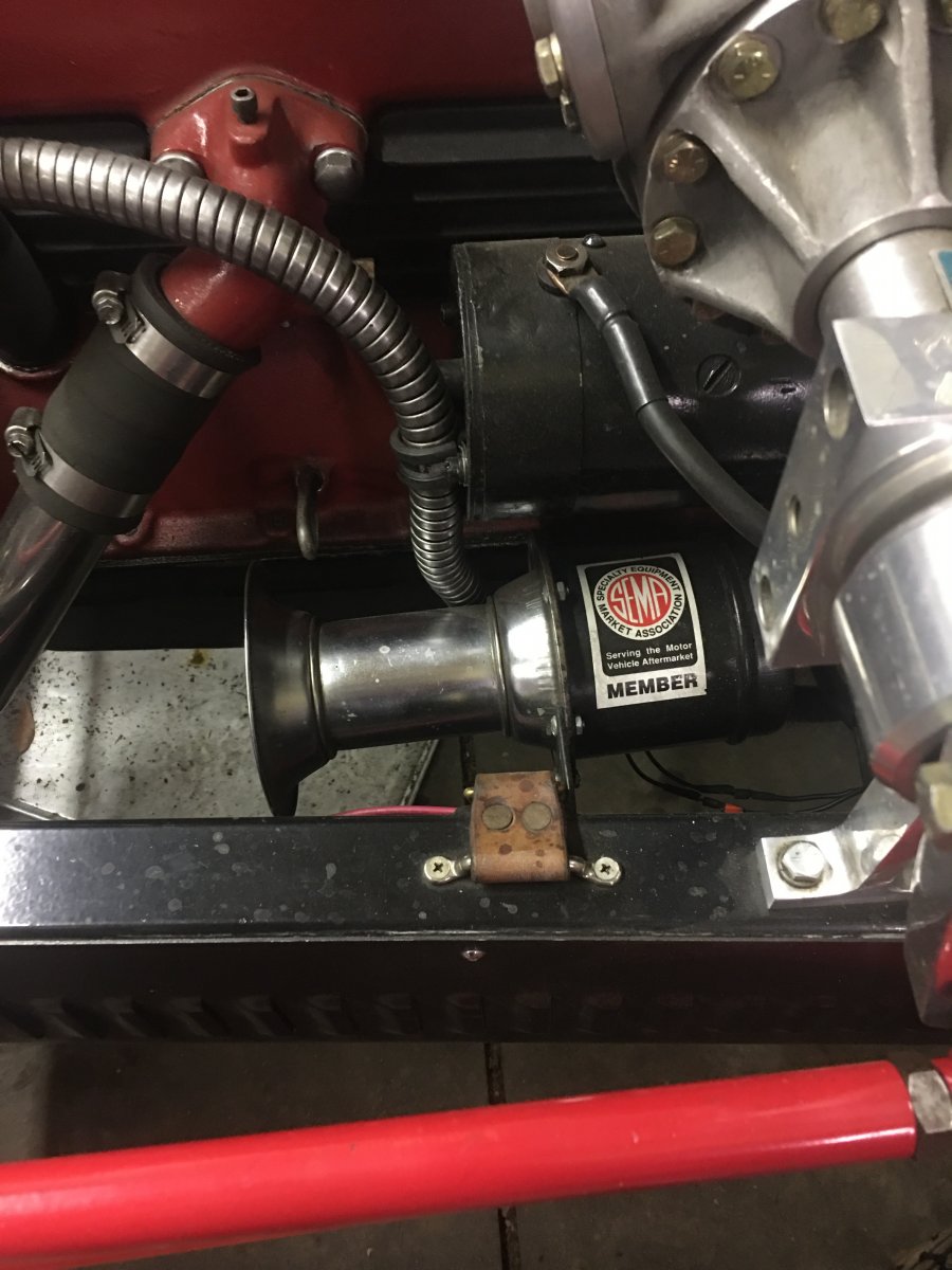

    The chrome on the horn adds at least 5 HP 4D2B8AF2-F080-439B-8537-F6D552EBCB6B.jpeg

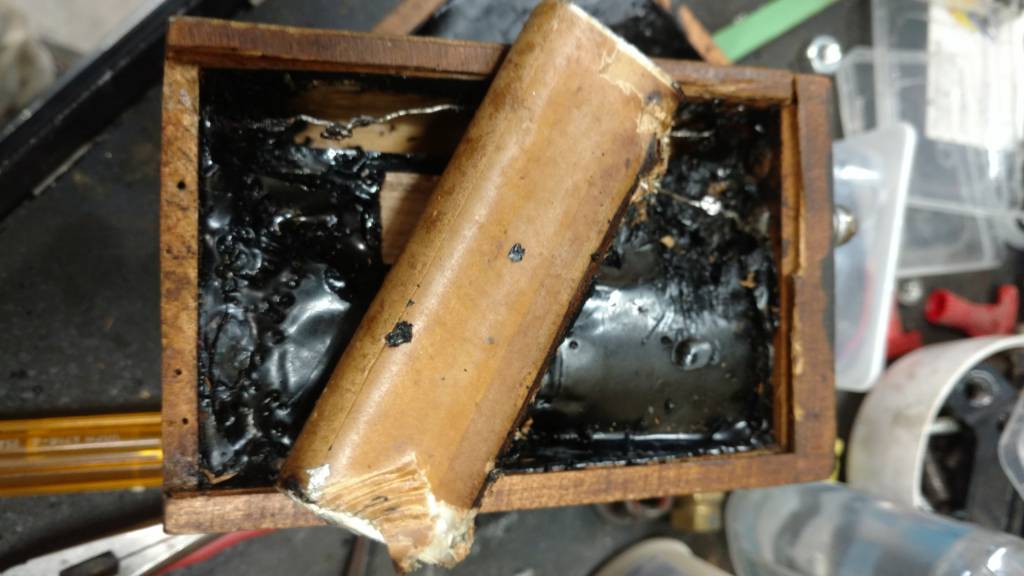

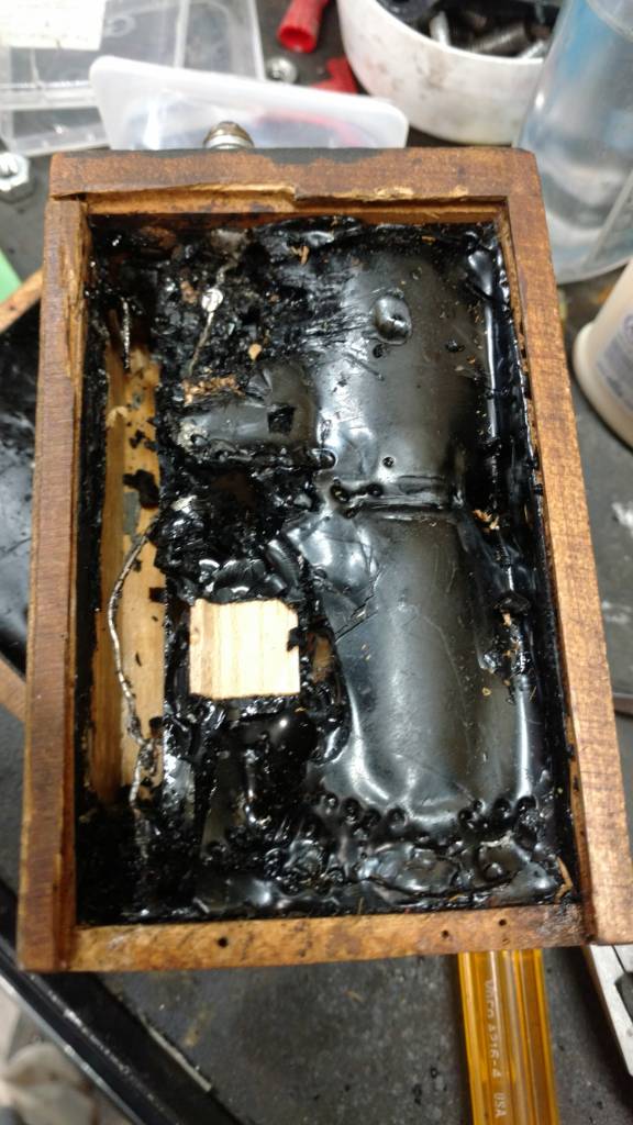

    Rebuilding Model T coils...I know, I know, Ford Barn material two more to go of eight IMG_20200322_085243676.jpeg IMG_20200322_085233930.jpeg

    Much easier than "T" coils........

    those coils are really fugly inside ! good luck .
    john , will "T"s adapt to that type ?
    ive heard that , but never could get one to live . had several (used) , give up ......

    Hey Walls,
    Couple things. First, as said, see if you can purchase the several iron pieces that make install easy. First one I ever did , I made these pieces. Dumb move as I've no torching/welding kills...and it took forever grinding.
    Since you already purchased the V8 39 trans, now is the time to make placement hole in its bell housing area for front 'yoke' ball attachment piece. I used grade 8 bolt/nylock nut fastener.
    Finally, I see that you used a disc without the springs being captured . It may take a while, but these springs can/will eventually work loose (fatigue) and rattle/noise/fall out at worst. Regarding PP, make sure that each 'finger/arm' has a secure fastener arrangement where is pivots, like a cotter pin to ensure that the pin does not back out with use.
