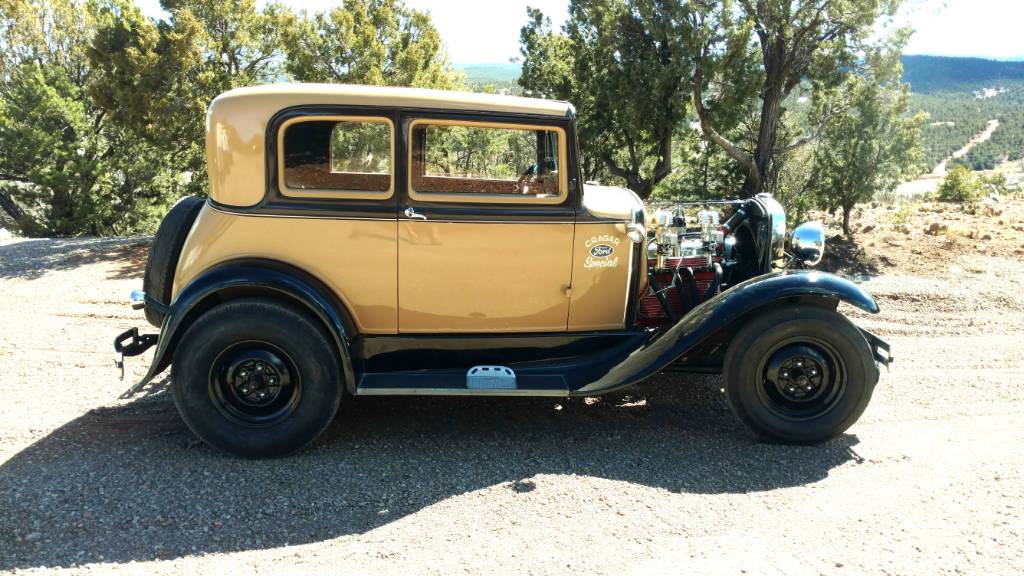

    Got the steel wheels on. 7.50 x 16 on the back, 6.00 x 16 on the front. My water jet buddy cut spacers. Dust caps, what are you guys doing for dust caps on the front hubs? IMG_20200315_152537.jpeg

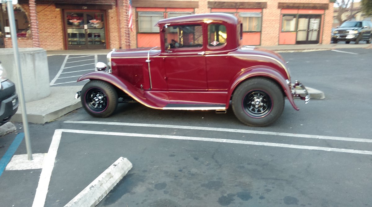

    very nice car ! i use what we used to call "spiders" on mine . i like the looks of them ...... steve

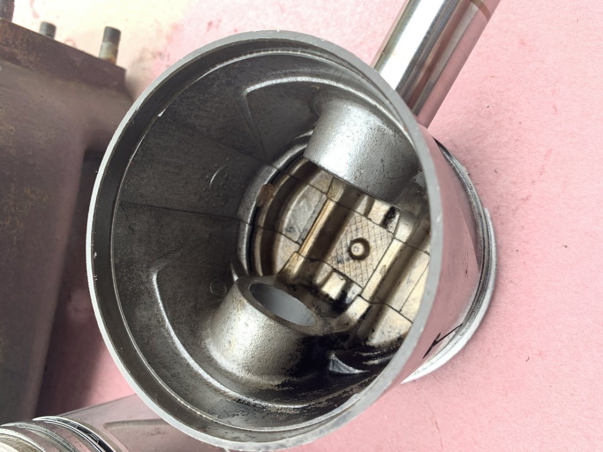

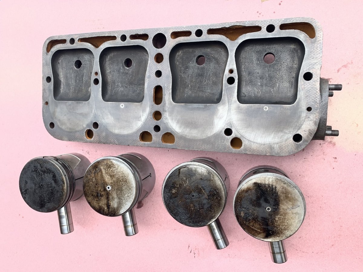

    I’ve been chasing a slight knock on my ‘33 Diamond block A motor at high RPMs. I thought it was a rod knock, but it turns out that 2 of the pistons were kissing the head. The old pistons have a weird little casting tit on the underside, the new pistons from CW Moss are smooth on the underside. I only had .019” clearance between the piston and the head, so I had the machine shop take .020” off the top of the new pistons. That’ll give me .039” clearance.
