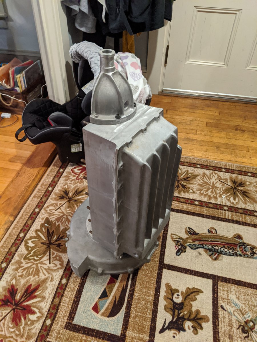

    I like it when the car parts hang out in the house. Nice

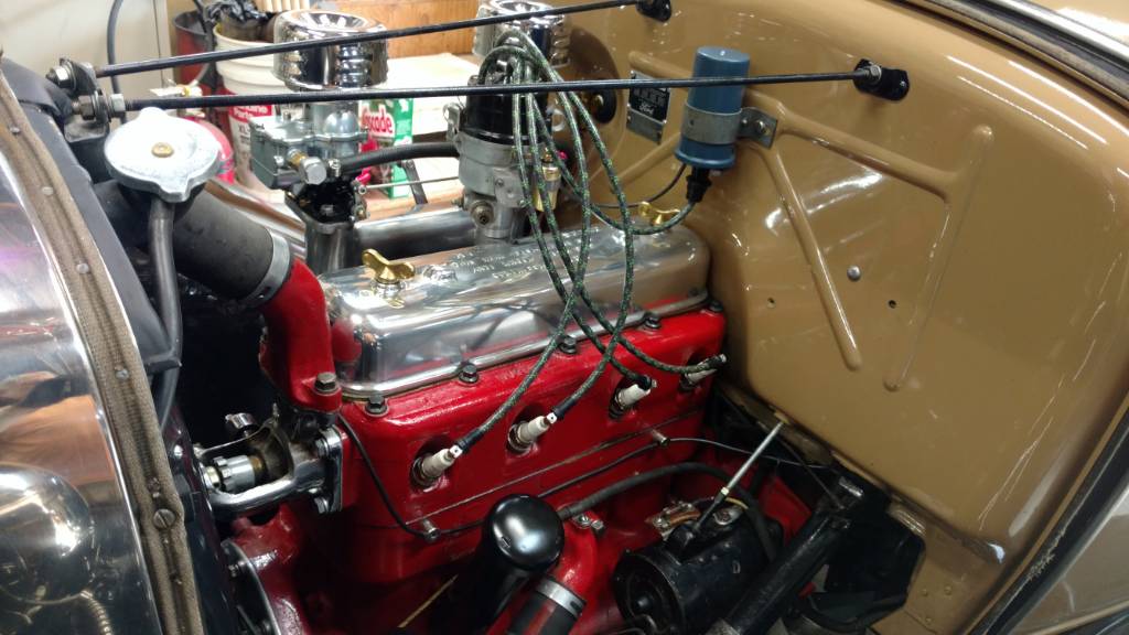

    So, significance of this photo is that I got the improved oil fill tube back on it. I had lost the cap and was having a hard time finding one and I posted it on here a while back....time flies...it was last year. Well @Jet96, Grady, parted with one that he had and gave...yes gave it to me. Thank You jet96 all you guys are great. Stay safe and healthy
