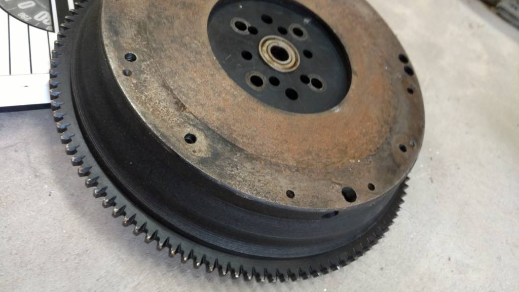

    I have never seen a "B" flywheel before, but pretty interesting as I just whittled my "A" flywheel down to 51 lbs.....51.15lbs to be exact, and it looks similar to the stock "B" flywheel. I could have gotten a little more off probably to 48lbs give or take, but my target was 50lbs, I'm not going to worry about the last pound.
    Dannerr, rwrj and 51 mercules like this.

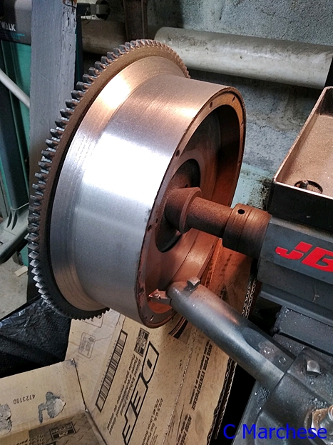

  26. Not knowing what the flywheel is going in, most will upgrade to a 3 finger 9" clutch.
    If you want to do this, the step can be removed, approx #2.5 and then you can remove a little more from the clutch surface. You will have to drill and tap for the new clutch, not difficult. This is probably the most common conversion. If you need more clutch torque capability some use a diaphragm clutch from the S10 pickup.
    On a side note, what machine are you turning the flywheel on?
    Best, John
