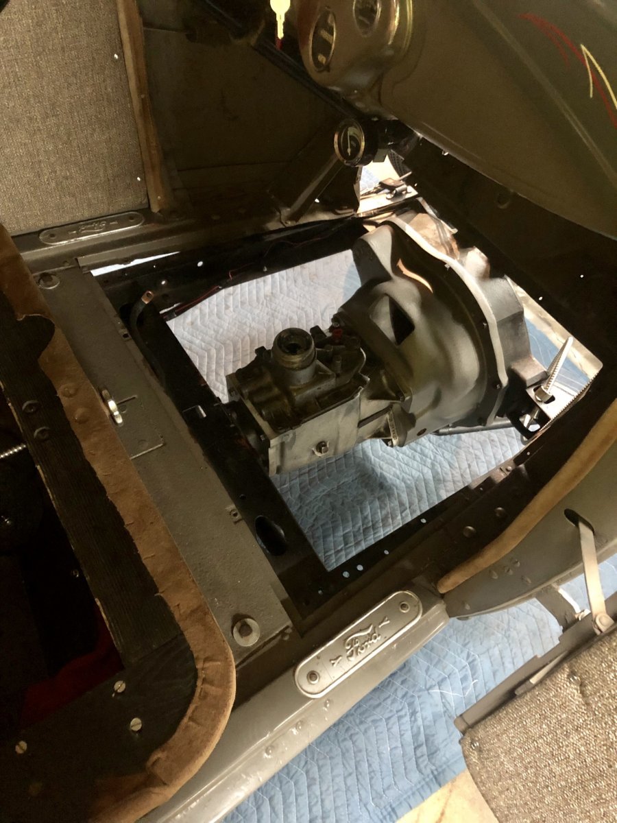

    Rts trans mocked up to the Mac’s bellhousing and tail plate. Only had to notch the front of the cross member but looks like I won’t have to mess with the mechanical brake cross bar. If anything maybe shim it down an 1/8”. Torque tube and shaft are getting shortened but a shop in Massachusetts. Radius arms are cut but not welded yet until I get the tube back. Trans shaft is getting splined by my local machinist this weekend also. Should be good to go by the end of the month then it’s motor clean up tome. New gaskets and got a Winfield head from “hardtomesaintit”. Appreciate it very much. Had to clean the cast up a bit before it all gets painted red.

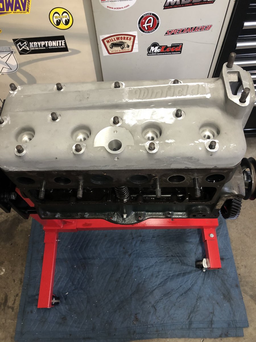

    scotchbrite fine disc on die grinder to take off casting flash,wool pad and rouge on diegrinder to polish..

    Railcar that looking good !!!! I’m painting mine and the motor all red. Thanks for the top though
