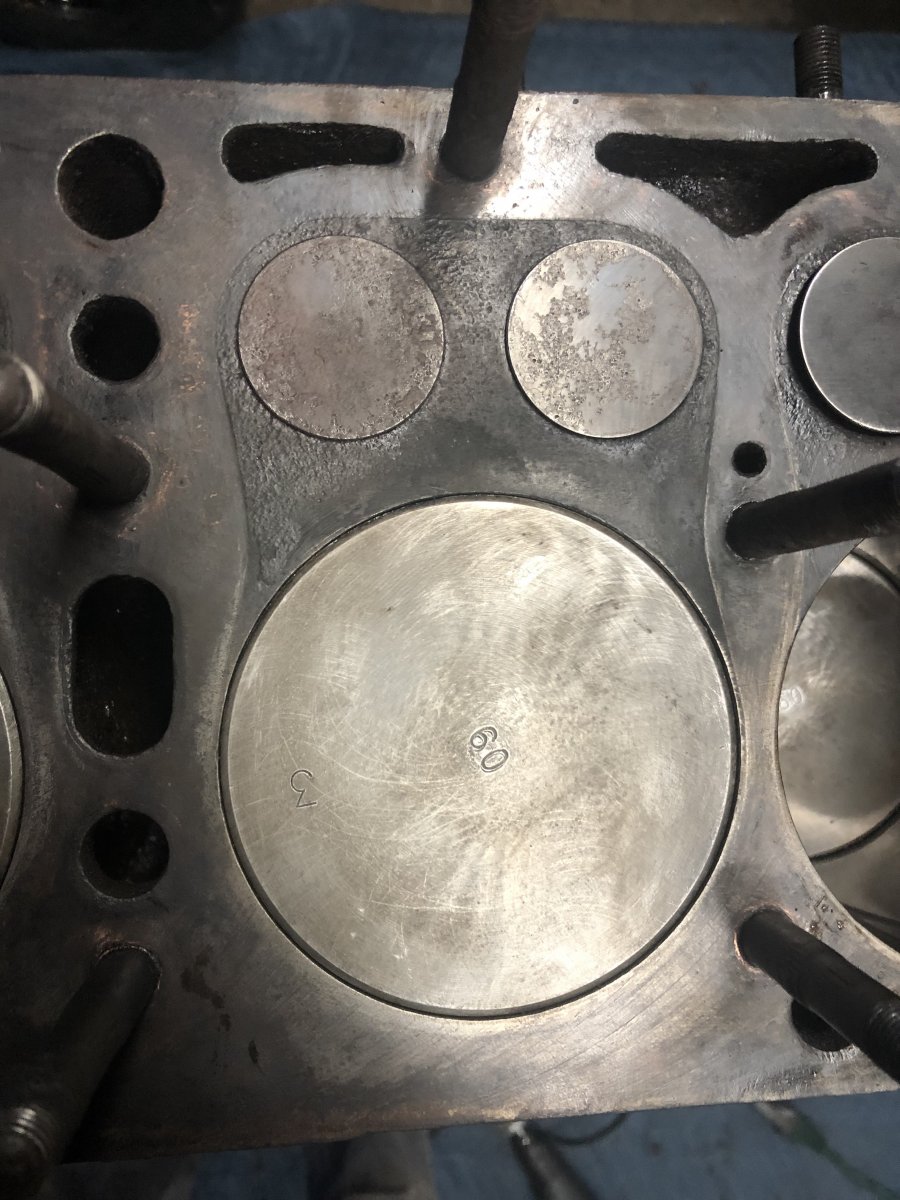

    Getting the motor ready for new gaskets all around and a Winfield 6.1 head. As I was cleaning found this surprise on the pistons. I knew it was rebuilt but thought standard pistons.
    Does anybody know what the stamping on the cam means. Stamped “G” is it stock or something else.

  12. railcarmover
    Joined: Apr 30, 2017
    Posts: 777
    railcarmover
    A cam lobe looks like an egg,a B cam lobe looks like a wood splitting maul..B cam has a fuel pump drive lobe.If your handy with calipers,the A cam measured lift is around .280,B cam measured runs from .302 to .319...Actual lift different than measured lift,measured is subtracting the narrowest point on the lobe from the widest.

  20. railcarmover
    Posts: 777
    railcarmover
    On the left is a 1928 5 bearing A cam.measured at .280..on the right is a B cam,.319 measured.Only a guess,but Id say by the nose you have an A cam..Ford increased the valve lash on B exhaust to .022 to give the valve more time on the seat and aide cooling but folks set them at the A lash of .13 to .15 to get maximum benefit. Actual design lift of the B is .032 in and .039 ex greater than the A.

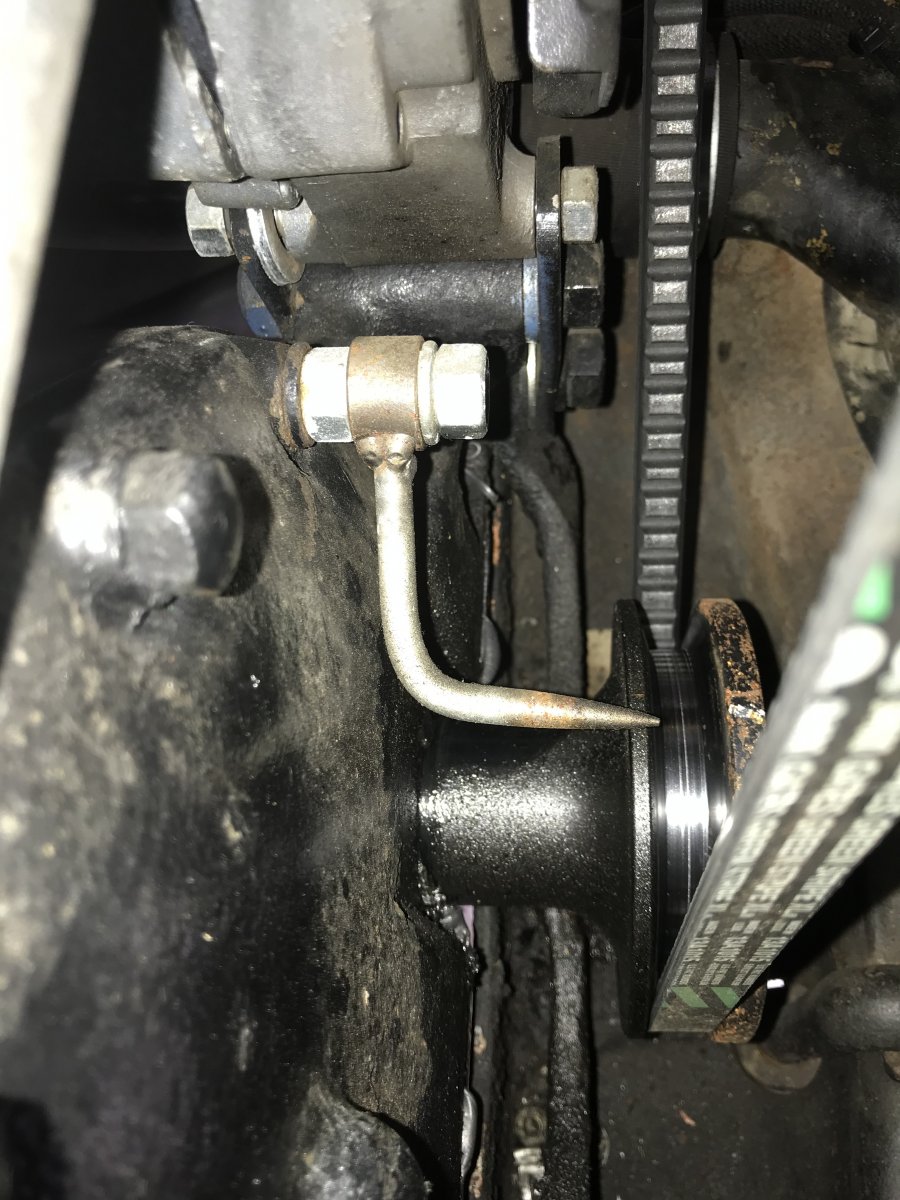

  26. I am using one of Yapp's three inch crank pulleys and would like to make a timing indicator that fits closer to the pulley. Any ideas or photos on where to mount? The nurex one seems too far away to be accurate. I thought about drilling the front cover and tapping for small machine screws but would like other options.
  27. Ron Brown
    Joined: Jul 6, 2015
    Posts: 1,715
    Ron Brown
    I just made a pointer and bolted it to one of the cover bolts...been there about 3 years no problems.

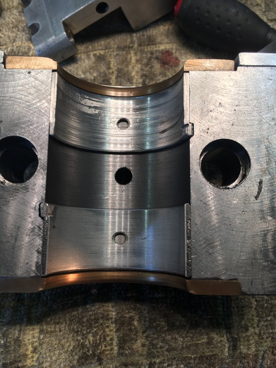

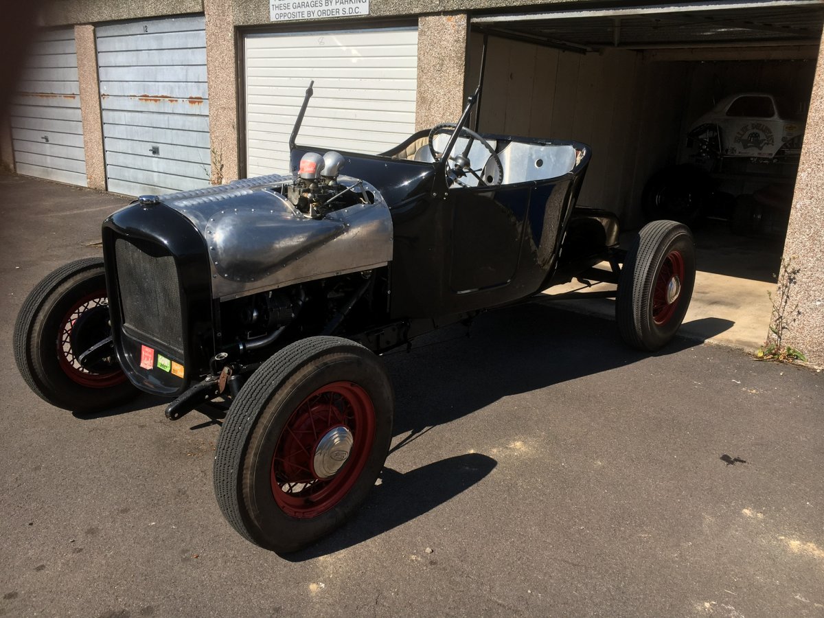

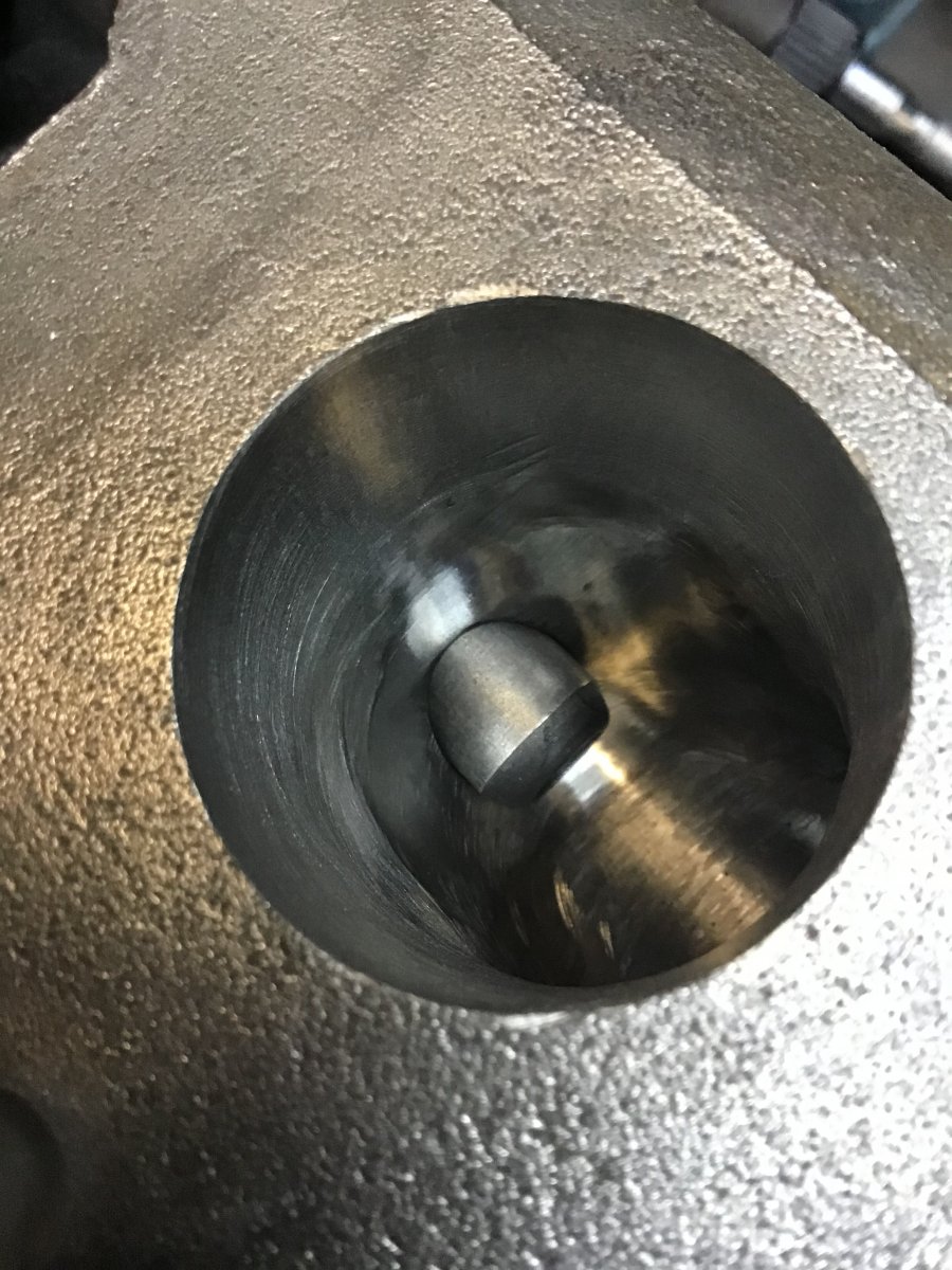

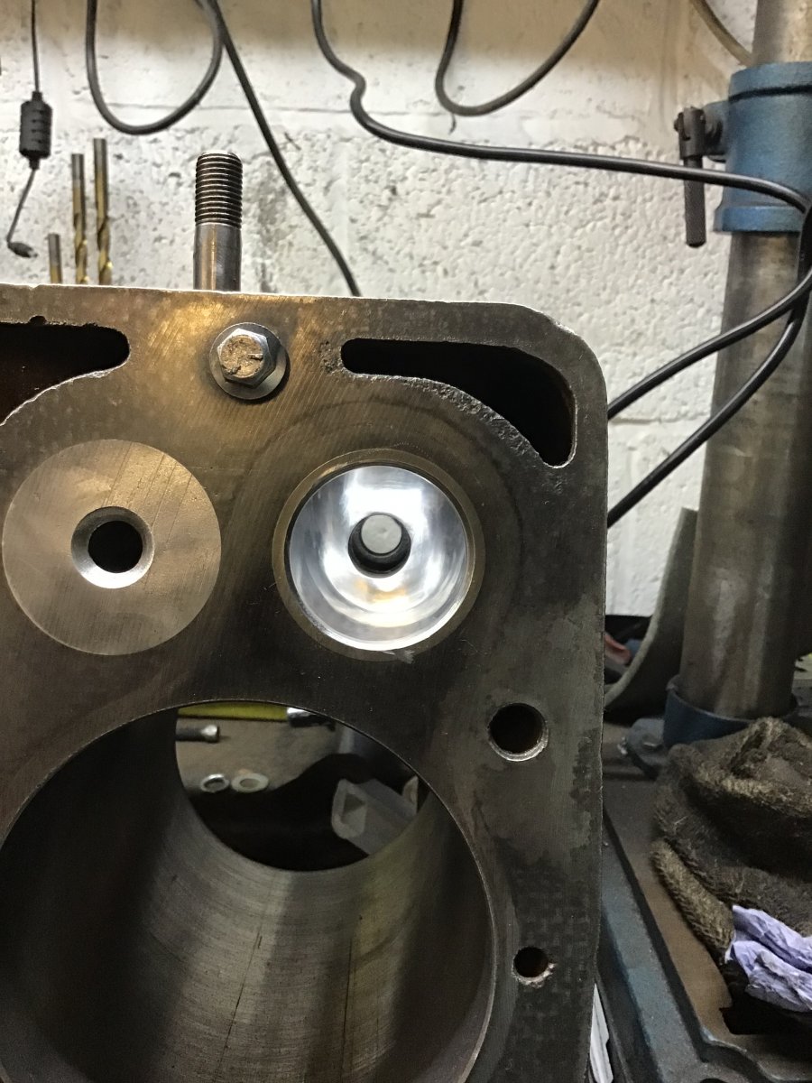

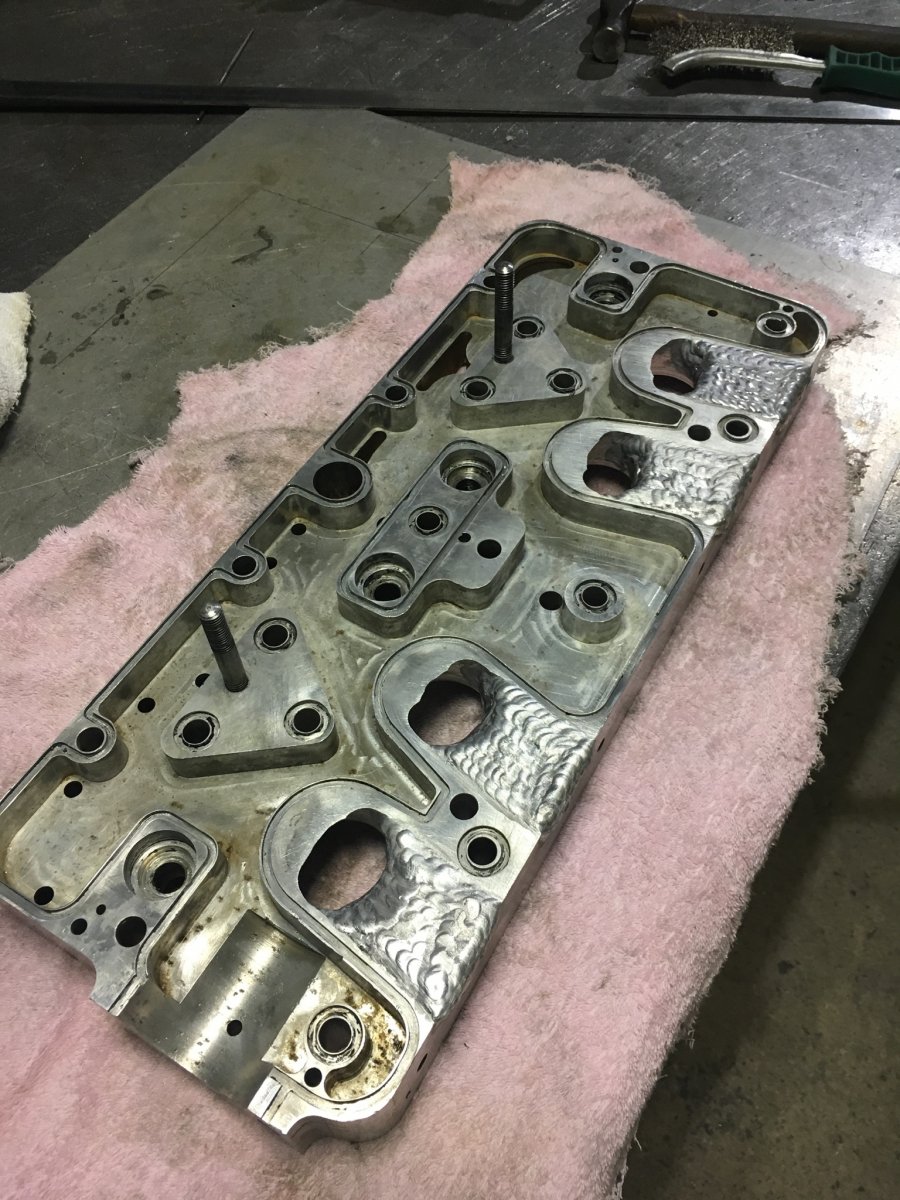

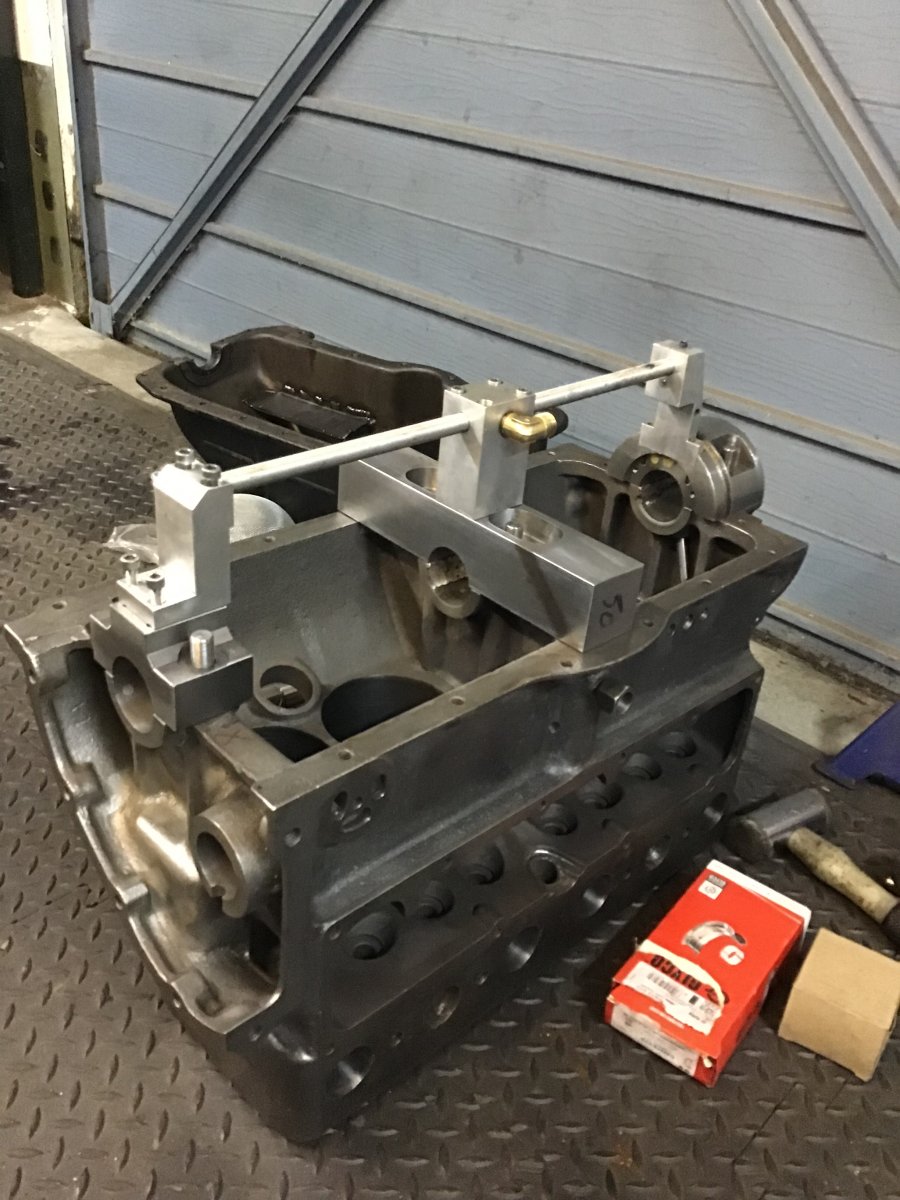

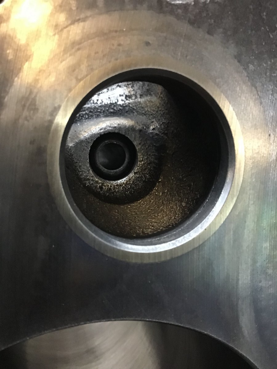

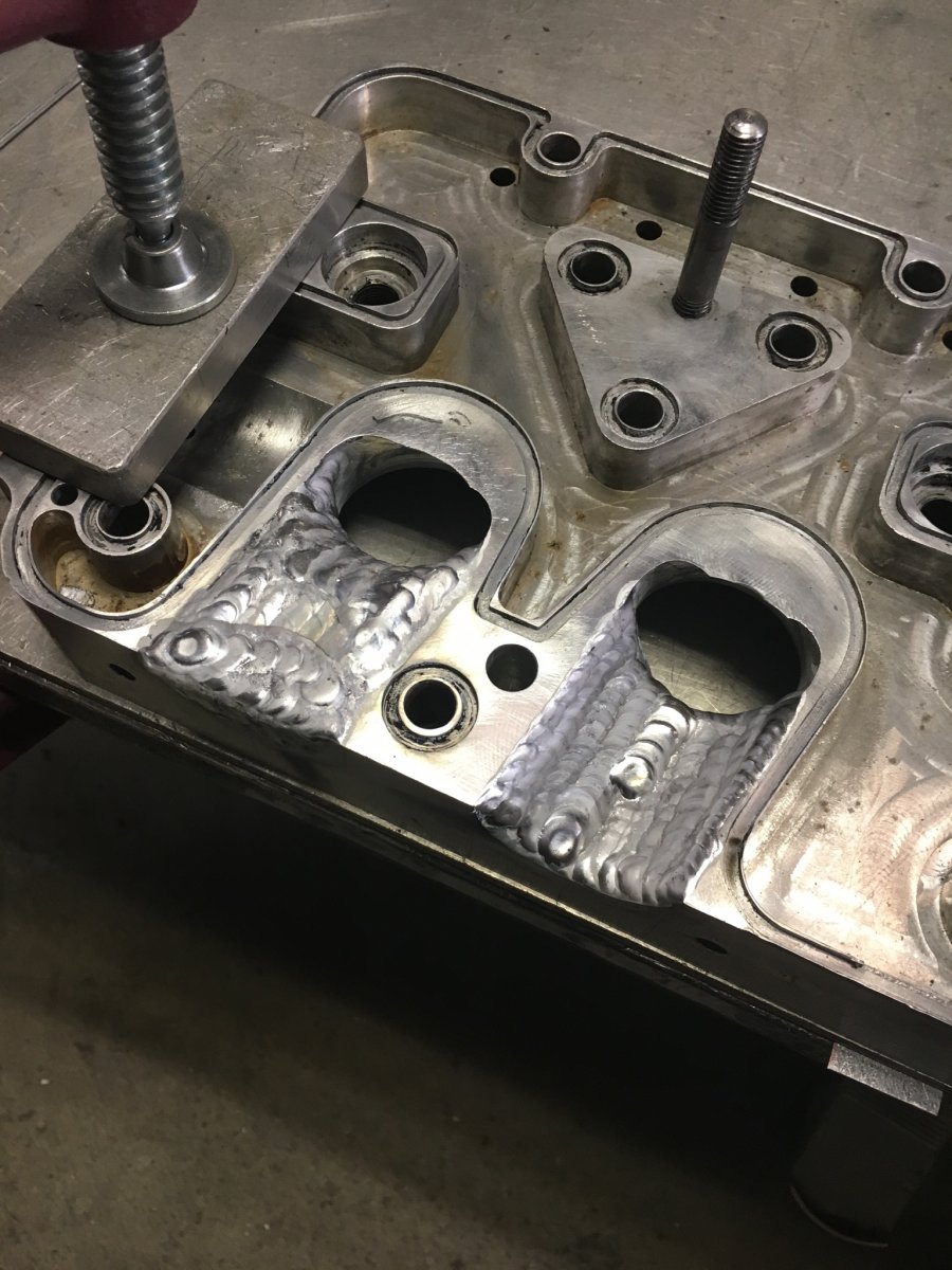

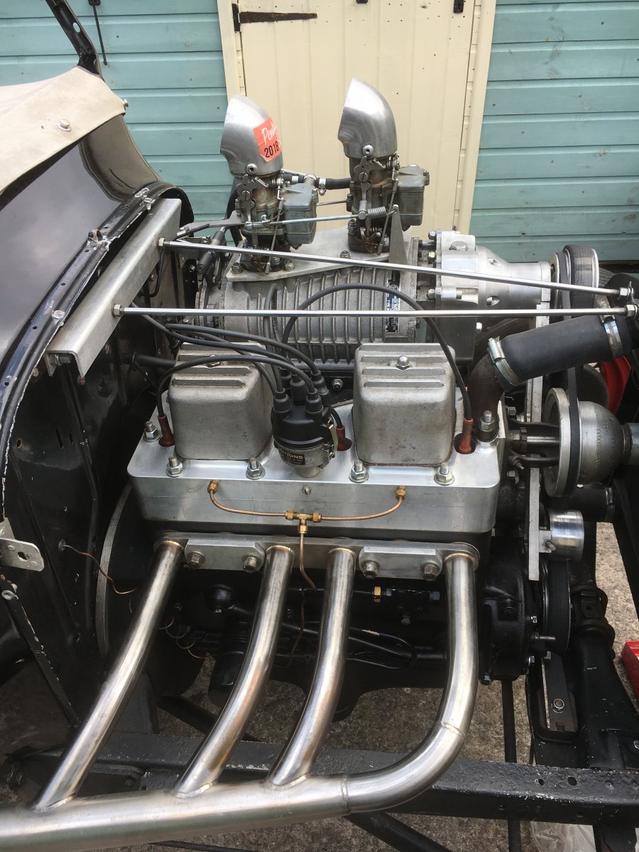

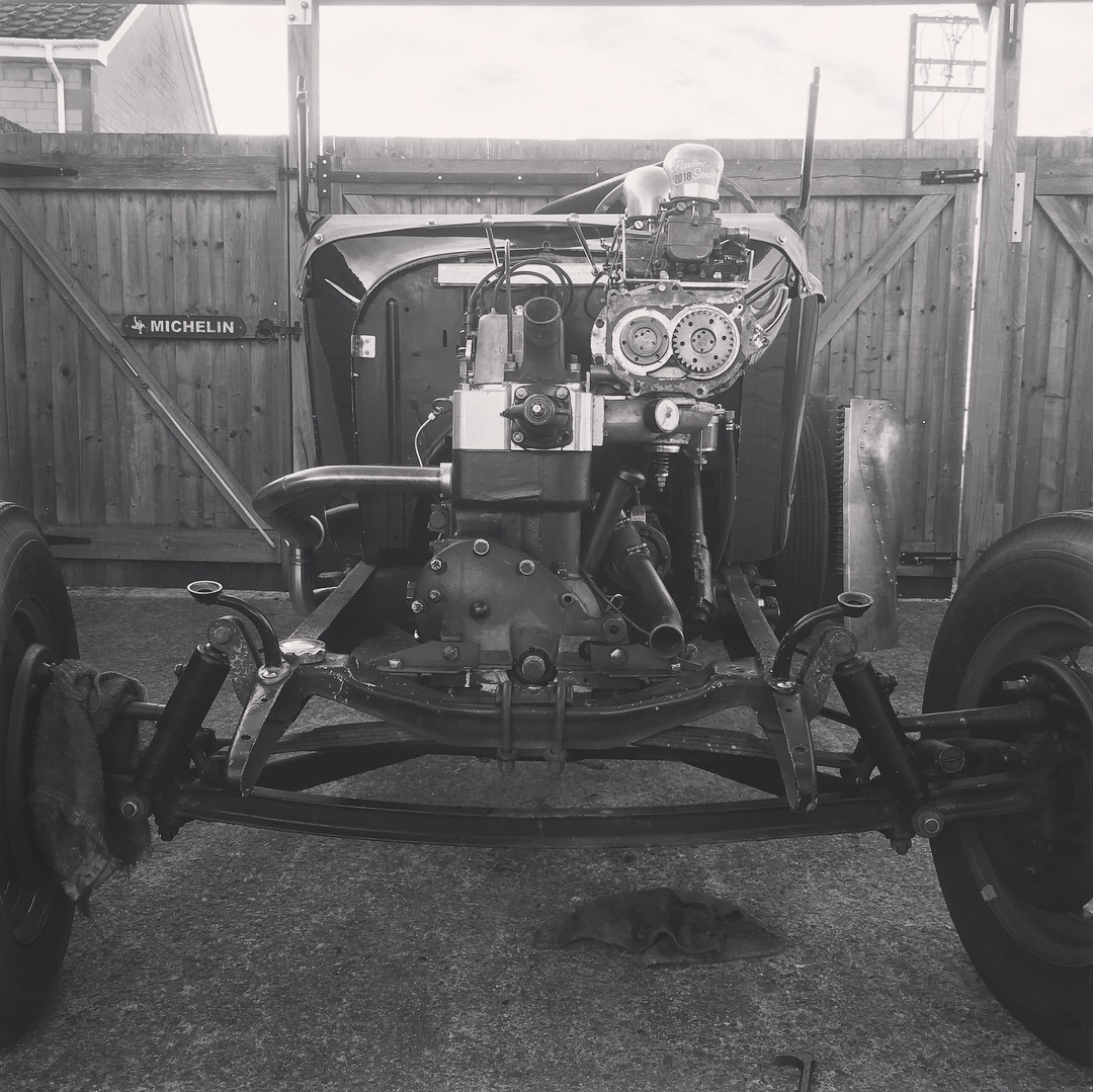

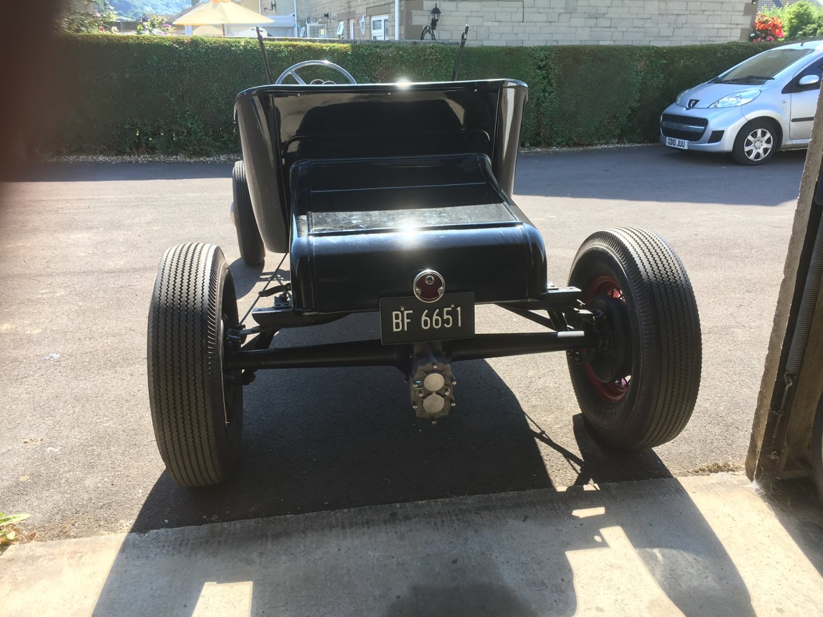

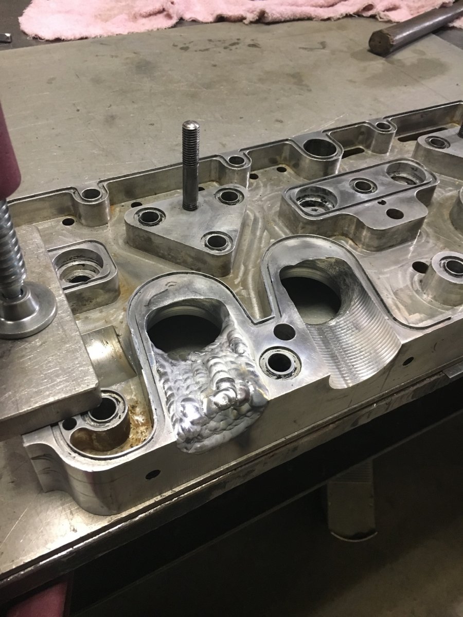

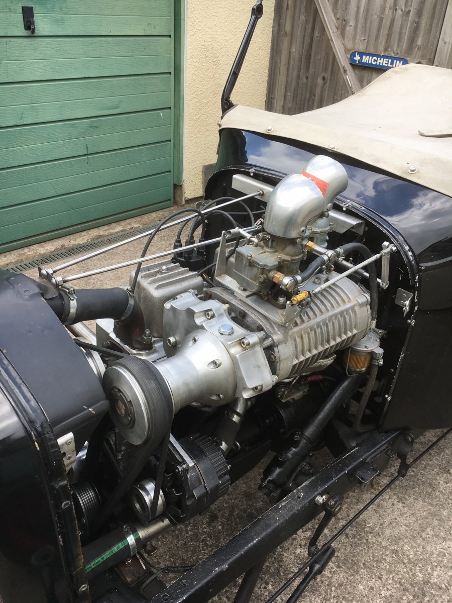

    New to bangers, but jumped in at the deep end by trading my old flatty powered modified for a ‘25 T on A rails with a ‘28 banger motor.
    When I said the deep end, I meant it. The motor has Scat crank and rods, full pressure mains, F head with overhead inlet, a supercharger and twin 97’s. Trans is V8 3 speed via a Clings adapter, torque tube and quick change. KH 16”s all round.
    I bought it as a runner that had been rebuilt professionally, but it had given the previous owner lots of grief and never really ran properly. So a project, albeit a running one.
    I’ve built a few flattys, currently running a 304 ci one in my sport coupe, so kinda know my way around and engine. I’d fiddled around with the banger a bit last summer but soon realised it was going to need more work, and I wanted to rip it down and build it up myself, wanting to know it was built properly.
    Sadly, it hadn’t been built at all well. I won’t go into all the details just say that it’s bad and needs total rebuild.
    One of the things that was wrong was the main bearings that were used when the oil pressure was done were bigend bearings. No grove for the oil to go around the crank and the oil hole in the cap was between two bearings, meaning they would only get oil by default and not by design.

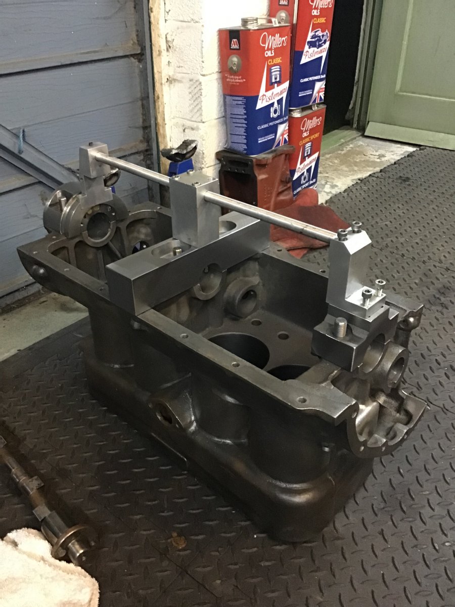

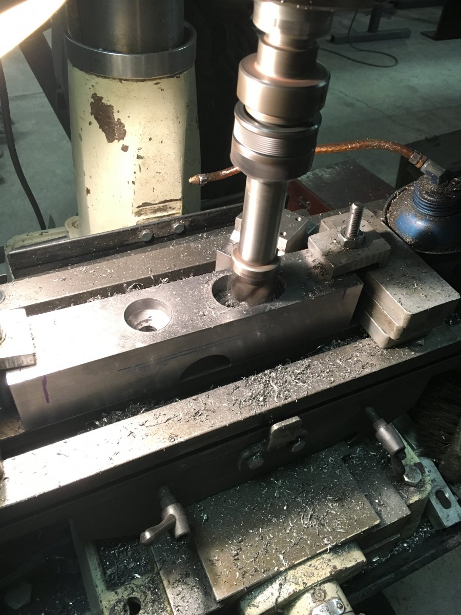

    I bought bearings from AER and have modified the front and rear caps to suit. The middle cap was to be remade. I wanted to girdle the centre main and attach it to the sides of the block. So I’ve machined a 2” square steel block so it’ll span the width of the block, and will be tied to two 5/8 x 2” steel bars that will bolt to the pan mounts. Like a big H section that should brace the centre main nicely.

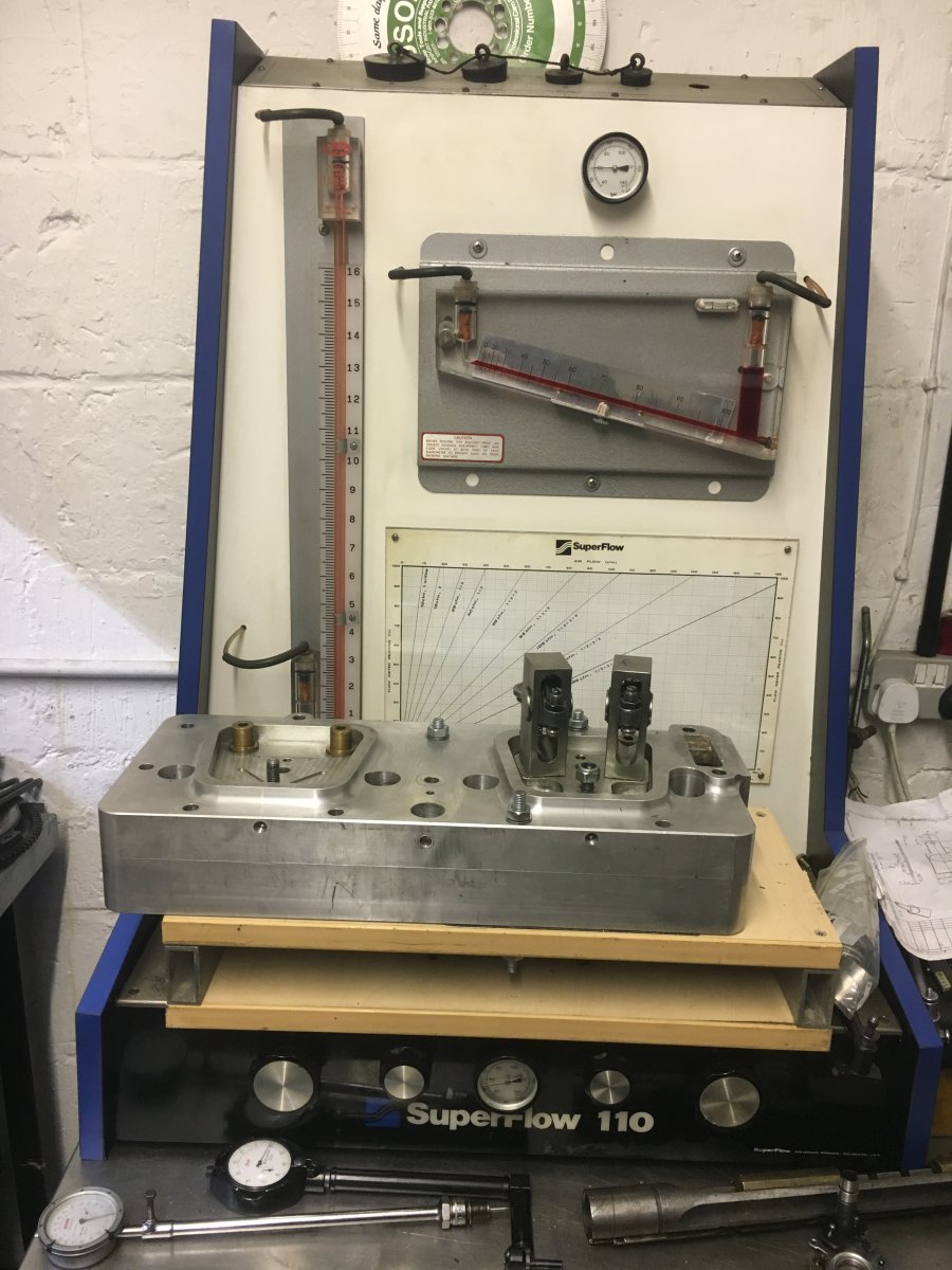

    Another bit I wasn’t happy with was the flow of the head. It has a big 1-7/8” inlet valve that was opening 0.540” but didn’t flow at all well due to the flat design of the intake port. The head is a two piece aluminium design, so I’ve welded up the lower section of the port and in the process of welding up the top section so I can move the intake port up and have a more down draft port. This should increase the flow and allow the gases to get past the valve much better.
    A friend and myself cc'd the head along with the block to work out the correct compression ratio, which was 6.9:1, a bit down on the 8.5:1 the makers of the head had claimed, but with 10 lbs of boost from the blower makes for 11.59:1 at full boost. Hence the centre main girdle.
    When the block is align bored for the new centre main I’m also having the cam bearings bored out so I can fit insert bearings on the cam. These will be pressure fed from the outside of the block. The oil pump will be external and a dry sump system will be used.
    Still lots to do, but with a deadline of middle of June for Pendine Sands it won’t be long before I start running out of time.
    I’ll leave with some photos of what I have and where it’s going.
    0FCB5050-BEF5-4CB4-8944-94F1DBE4AC08.jpeg DA4E4112-F156-45AE-864E-154EBFC630D0.jpeg 89CBB981-2BA6-459F-BB38-6F64E12A3DA7.jpeg E2D95E7F-BEC9-4909-BDBB-4BFBEA4586DE.jpeg 0BC0D64E-AC86-4447-AA4C-A3F44A941CB5.jpeg D073B186-3414-4BE6-87A0-7E81F0CD4520.jpeg A066B7C5-B56F-4C4E-B7C7-91B444E9CECB.jpeg CF4BFD58-2EEA-49D1-850E-2B45B903BB82.jpeg 16094559-EEE7-4E9F-8EBE-B8BE27DFBB8E.jpeg F484D319-3142-4095-A46F-CB604D1F1E35.jpeg 656C710B-5383-4D41-A681-AE6538D45597.jpeg EF119352-F2C0-4C02-B68E-15BCF7D44963.jpeg 4AF3DCEE-FFAE-4D96-B081-6865943979D2.jpeg CD636937-326C-4D82-AA89-6BC82B19C2E3.jpeg 73081180-AC53-4DFC-9FC9-AEB4508EE018.jpeg 151A1A15-E816-4393-A055-76D27B49B669.jpeg 30130662-E9B0-492B-8120-17BF55BCF17D.jpeg 8A02487A-BBCA-4F56-8DF9-6C0E723F89ED.jpeg
  29. Nutrocker
    Very cool build, keep the pics coming.
    It is scary what we find in the bottoms of these motors. Not to mention the tops too!!

  30. hardtimesainit
    Joined: Jan 24, 2009
    Posts: 625
    hardtimesainit
    Thanks for sharing.
    No end to mans imagination/creativity ! Looks like a street licenced machine.
    What brakes do you plan for ?
    Do you happen to know maker of this two piece head ? What method do you plan to use to seal it with ?
    NICE work !!
