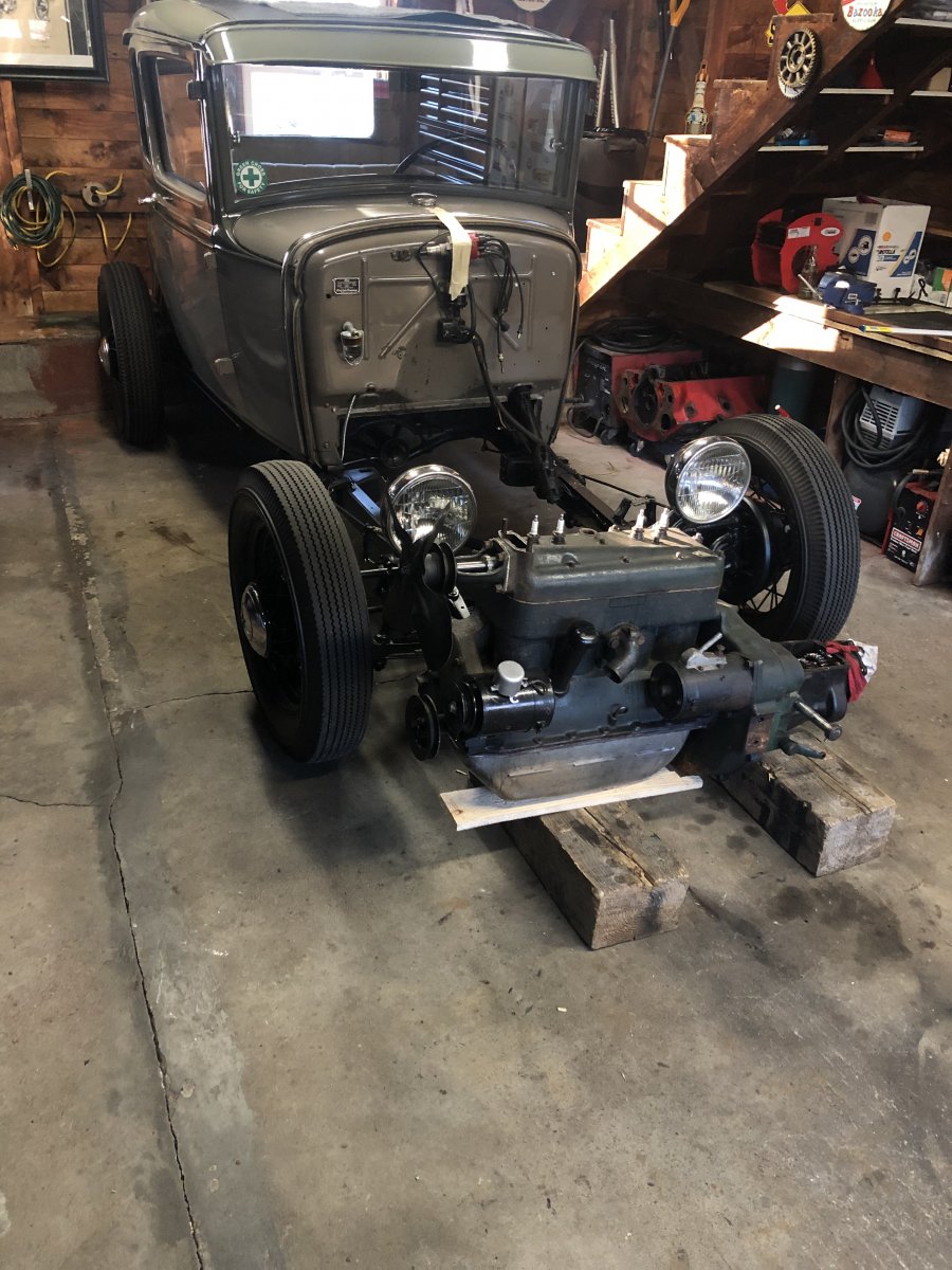

    Checking in for the month.Neeed to keep progress rolling on this pile.Just a few things to wrap up so I can throw this back in and see if it works. 28.jpg

    Burl,
    If it doesn't work, ship it to me for testing, I should be able to evaluate for about 7 to 8 months...........

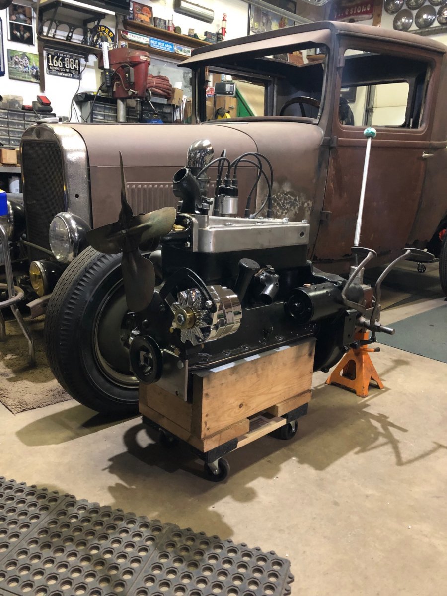

  20. IMG_1731.JPG Banger finally runs, but idles for a few seconds and dies, also dies when I give it any gas. Hopefully I can tear the carb apart again and clean it better than the first time
