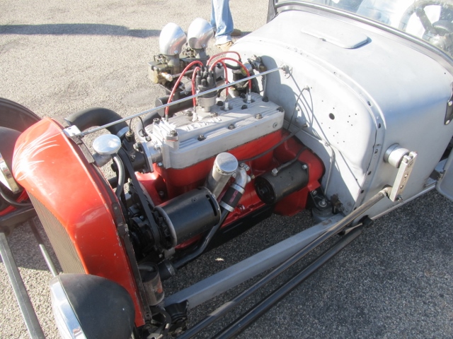

    I ran a 7.5+:1 comp. head on a stock b engine for over 10,000 miles mostly spirited street and freeway driving with many runs down 1/8th and 1/4 mile drag strips. The engine was well used when I got it. I tore it down and reset all of the bearing clearances (stock Babbit) and replaced the stock style pistons with a modern style piston. The cylinder walls were so worn that there was .010" of "belly" in them. I replaced the stock cam with a "3/4 race" cam, and the stock head with the previously mentioned high compression Weiand head. Added 2 Stromberg 81 carbs and an electronic distributor with centrifugal advance. Stock oiling system with some minor mods to the oil pump for more volume. As Bluto (Jim) has stated All of this significantly reduced the life of the engine as it pushed out the bearing material in the main and rod bearings one day at the drag strip. It cost me close to $10,000 to build a fresh replacement engine. This new engine is much better then the last, and I figure it is puts out @ 95 hp. My best 1/4 mile time was 16.32 secs. at 80.58 mph. You can spend less money and go faster with a SBC, but I don't like taking the easy way.

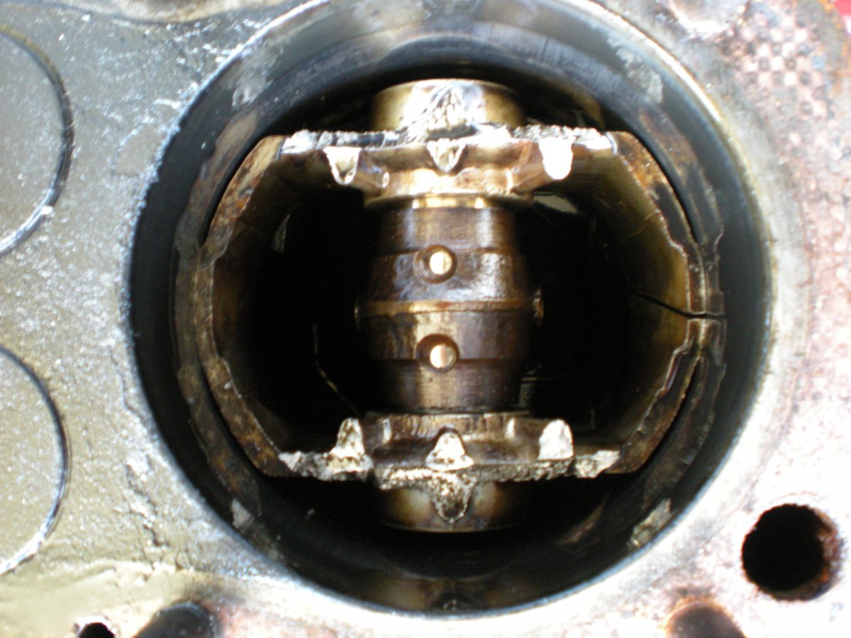

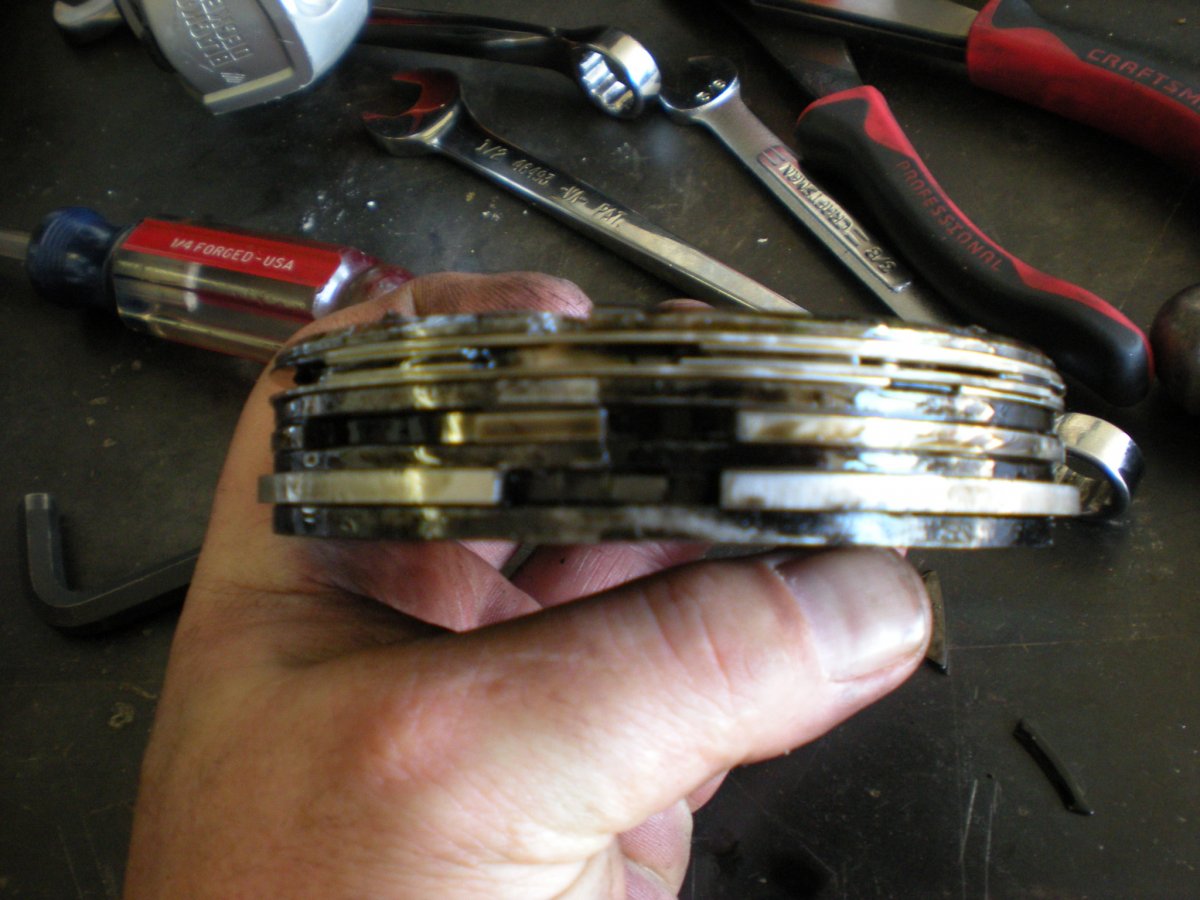

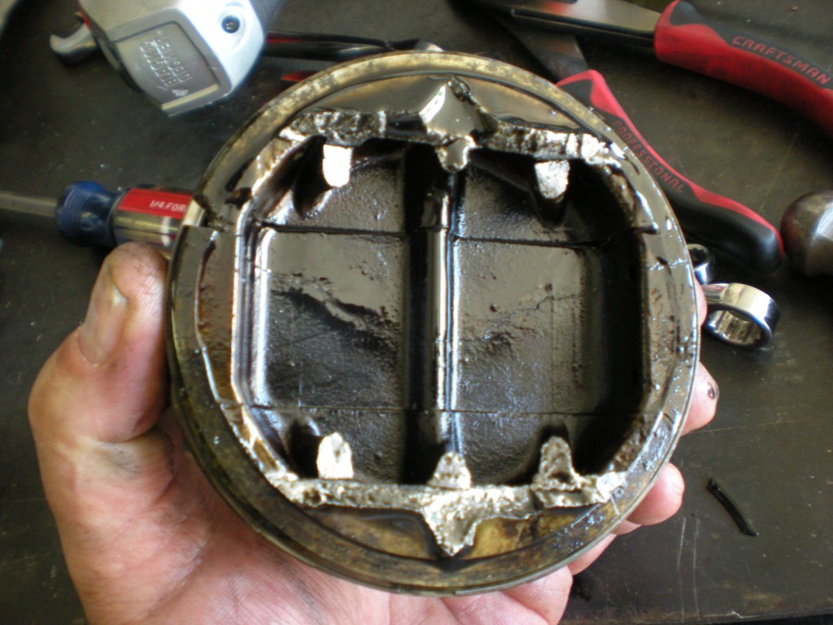

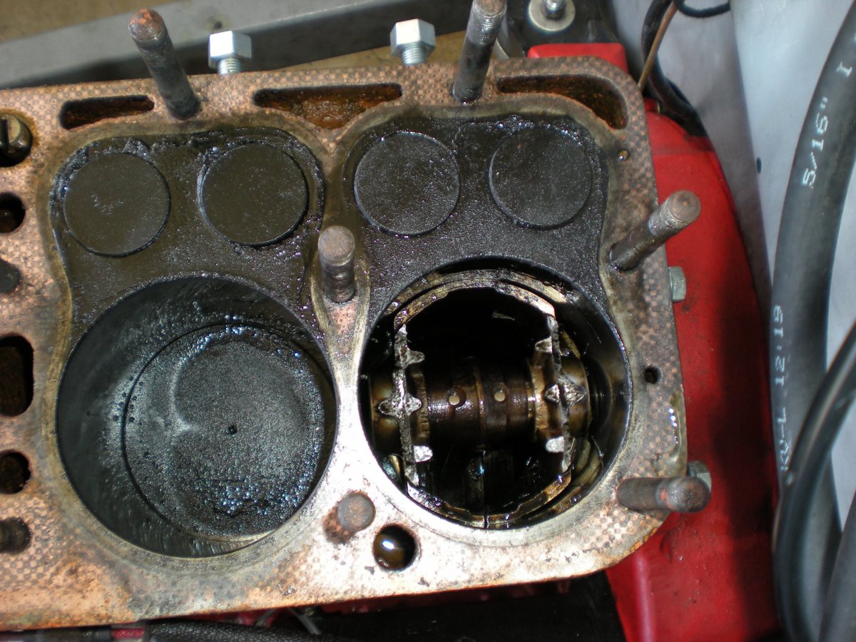

    This is what 7.5:1 does to stock pistons.

    My engine. This was the "used" b engine a few hundred miles after I first put it in my car. This is why I tore it apart and put new pistons in it.

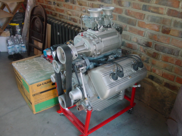

    THIS IS IN OUR WINTER GARDEN
    PUT ONE OF THESE IN AND NO ONE WILL LOOK AT THE PAINT:rolleyes:

    NOT A "HOLY GRAIL" NO OLD FORD PIECES IN IT ANYWHERE
    LOOK CLOSE IT'S BRAND F'N NEW.
    SOMETIMES THE CHEAPEST THING YOU CAN DO IS BUY THE MOST EXPENSIVE THING YOU CAN GET!

    Thanks some ugly stuff there. I can just imagine the "hidden" damage done as well. Considering what you put your engine through with 7.5:1 compression and all of the other mods, I'm thinking the 5.2:1 head and a few minor mods I have planned for my A will almost be a non-issue.

    ROSS ARE VERY GOOD BUT THEY DON'T HAVE FORGINGS SMALL ENOUGH FOR ME ITTY-BITTY BANGERS.
    THE ARDUN HAS ROSS PISTONS. I BROUGHT THAT MOTOR WITH THE MONEY I SAVED FROM NEVER OWNING "GOLD CHAINS" OR A LAWN MOWER!
