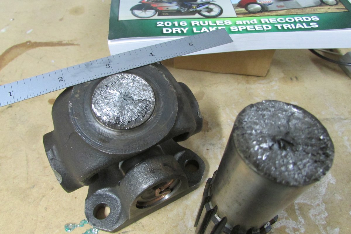

  8. Not open up another can o worms, but here is proof that proper corner radius is critical on crankshaft journals.
    Here is the driveshaft from water brake, notice lack of corner radius just where the separation occurs.
    Foiled again, but she was a singing good just before the rev limiter took over.

    Yes, I agree that the corner radii was too small. It also looks like there had been a crack there for some time.
    Looking at the yoke half of the break, the lower quadrant of the break is darker. If that is not just an illusion or a shadow. The dark section of the failure is an indication that there was a crack there from before.

    Looks to be a substantial defect in the bottom of pictured part ! But , how does a guy ever know of that ...unless it's used and gives way ?? Do you think having that part tested (mag) have revealed that ?

  13. It was probably not a crack, if you look straight down on it no discoloration. Usually if cracked there will be a dull finish or even rust.
    This would appear to be a welded junction, inertia weld or friction type, hence the lack of radius.
    Now to find a billet piece or change the whole design. J

    I HAVE A VERY NICE PAPERWEIGHT TOO. IT'S A BILLET THAT THE KIDS GMC TWISTED
    YOUR MAKING HP STUFF FAILS....
  15. Thanks Bluto, I guess it is symbol of success.
    It will definately be displayed on the wall in the office.
