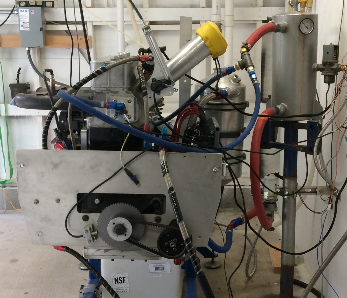

    Hard to tell from this pic but there are two authentic Ford Model B parts behind the mounting plate.
    Twisted out another driveshaft flange today, rev limiter and scatter shield worked flawless.
    Only have to repair driveshaft.

    What's the NSF on the pan, you running this in the kitchen?

    That is a water tank on the floor for return.
    There is no oil pan on this motor, just dry sump scavenge.
    My wife doesn't let me do that anymore, no parts in dishwasher, no ceramic coatings in the oven.
    She's such a killjoy.......

    I thought El Mirage was closed this week end? Did you bust it up in the car or on the dyno?

    I did it at home on the brake.
    Was pulling about 200ft# at about 4200 when it became exciting...........
