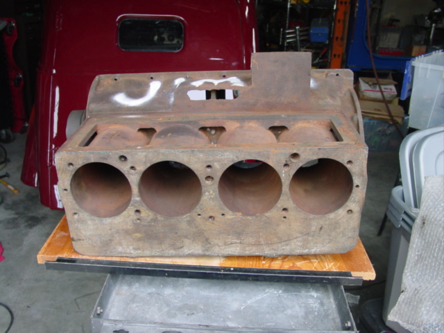

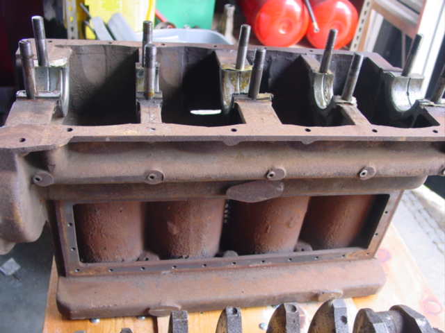

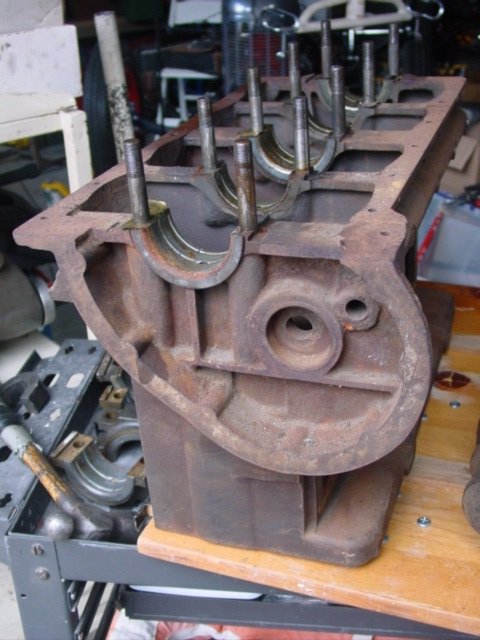

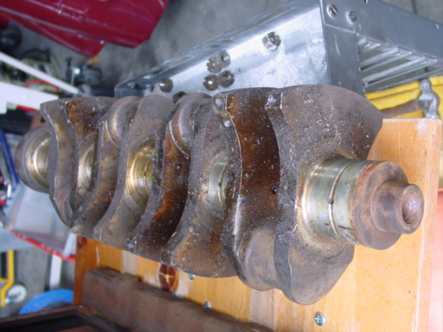

    THE PROBLEM IS THAT THE VALVE/LIFTER POCKETS AND CAM ARE STILL IN THE BLOCK. THIS IS WHY I WORKED SO HARD TO GET THAT CORRECTED WITH THE OVERHEAD CAM BLOCK. I REGRET THAT IT HAS JUST NOT HAPPENED.... BETWEEN THE HEART BYPASS AND NOW VISION CHALLENGES IT IS SLOW GOING. I'VE SEVERAL GOOD FOUNDRIES HERE
    BUT HE GUY WITH MY BLOCK SCANS IS A WASTE OF TIME......

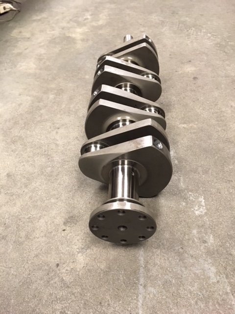

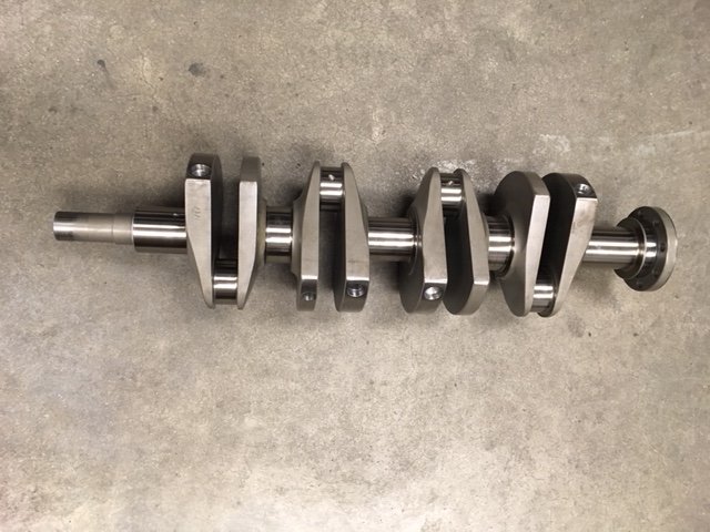

    I hope so. I will have to at least buy two more for the other blocks.
    Moldex crank with 8 bolt flange. I've got Racetec pistons on order.

    Just noticed that block is only suited for an overhead cam set up. Even cooler then I remember!!!!!
    The oil galley that supplies the oil to the main bearings, is there a plug in the hole behind the cam gear?
    Outback and Old Dawg like this.
  22. Bluto
    Joined: Feb 15, 2005
    Posts: 5,114
    Bluto
    I'M HAPPY TO SEE YOU'LL GET SERIOUS HERE!
    YES DAN...IT IS A LOT STRONGER.... LIKE I SAID A STABLE BLOCK ..TIGHT CRANKCASE. AND EARLIER THAT THE HAL 5 MAIN. THE REAR SEAL IS LIKE A MODEL A THAT HAL TOO. WHAT I WAS PLANNING WAS TO RUN IN A CLASS THAT REQUIRED A PRE-32 BLOCK.
    DID YOU SEE THE PAD TO ALLOW ALMOST ANY OHC SET-UP
    I'M NOT GIVING UP ON ANY OF THIS. IT'S JUST BACK-BURNER TO MY VISION RIGHT NOW, AND DEPENDENT
    ON WHAT WE SELL IN OUR COLLECTION. SO FAR IT LOOKS LIKE MORE PEOPLE WERE WAITING FOR ME TO SELL THE PREWAR BMWS THAN ZOFIA'S MILLER. IN ANY CASE WE WILL SEE WHAT GOES AND WHAT'S LEFT.
    I JUST HAVE TO THROW MONEY AT THE BLOCK PROJECT. TO MAKE IT WORK.

    I'LL HAVE TO GO LOOK AT THE BLOCK TO TELL YOU? THERE IS AN MOUNT FOR THE IDLER? IS THAT WHAT YOUR CALLING "CAM GEAR" NO CAM BEARINGS, NO LIFTER BORES, NO VALVE SPRING OR ANY GUIDES
    AS YOU SAID IT'S ONLY FOR OHC HEADS ONLY HAS AN IDLER GEAR WITH A SPROCKET TO RUN THE CAM CHAIN. THE DESIGN IS MUCH LIKE OUR DO-HAL BUT THIS ONE HAS A MODEL A REAR MAIN KINDDA SEAL... THE 5-MAIN HAL HAS VERY VERY DIFFERENT REAR MAIN SEAL.
    PROBLEMS WITH THIS BLOCK WAS SOMEONE DID ALL THE MACHING WRONG. PERHAPS THEY ONCE WORKED FOR NORTON OR BSA.... IT'S THAT BAD.
    MY PLAN WAS TO RECAST THE BLOCK AND GET EVERYTHING INDEXED ... EVEN THE BORE CENTERS ARE WRONG AND SOMEHOW THE MAINS WONDER LIKE A PISSED OFF DIAMOND BACK.
    THE MACHINING LOOKS LIKE IT WAS DONE WITH A HAND DRILL OR PERHAPS A BRACE AND BIT. I DON'T THINK THE BLOCK WAS EVER USED.
    THE MAIN CAPS ARE BRONZE AND POORLY LOCATED MAKING REPEATABLE INSTALLATION NEAR IMPOSSIBLE
    THE MAIN WEBS ARE VERY THICK AND THERE'S A LOT OF ROOM TO SUPPORT FOUR BOLTS AND DOWELS TOO.
    THE CASTING IS WELL DONE. JUST POORLY MACHINED
    I DO WISH IT COULD TALK. I'M SURE IT YELLED RAPE!! SEVERAL TIMES IN IT'S LIFE
