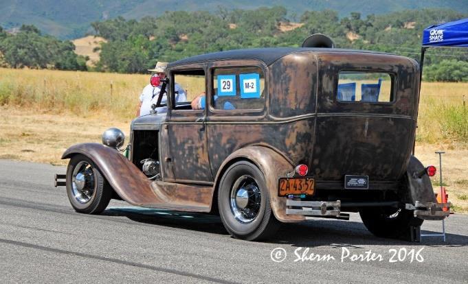

    11735597-D2D0-48E6-8769-8AC1F218C719.jpeg 1E36D5E0-1CFD-4CC7-AA84-A1C8BA504C2C.jpeg 2BA911CF-6BA2-4B4E-8233-BD4075A5711C.jpeg Havent checked in for awhile....getting ready to install 39 tranny this spring...a pic from the Santa Margarita time trials...slowest car there, but who cares. Will be going back this year as well as Auburn hill climbs.
    Outback, 52 ford coe, Jet96 and 6 others like this.

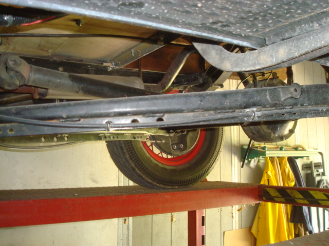

    I used ‘40 radius rods on my coupe. I am running an closed drive shaft but the later rods are good because they are heavier than stock A ones. They mount underneath the axle so they work well with my frame with a Z in the rear. Here are a couple of pictures. I also had to show off my parking brake cable pass through I made too.
