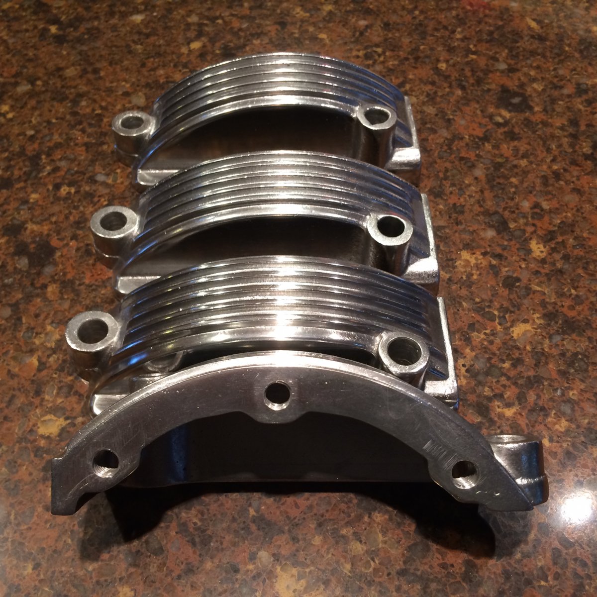

    Back around page 8-9 there was lots of talk about 5 main cranks and new 5 main blocks, Then there is mention of 5 main girdles. Then apparently they can be had in different thickness. Do these 'girdles' require different length rods? Or does the girdle use the block half of the original 3 mains and the other 2 bearings are on the girdle? Is Babbitt used or insert bearings? Does anyone have any pictures of a bare girdle sitting out on a table and maybe a pic of one installed? I'm having a little trouble understanding how this works and how does it go together.
  5. johnneilson
    Joined: Apr 12, 2011
    Posts: 1,217
    johnneilson
    Michael,
    The girdle is about 3-4 inches thick depending on who makes it.
    It basically replaced the main caps for 1,3 and rear with two additional caps facing up for 2 and 4.
    It is a way around the rules in vintage racing where a original production block is required.
    I think even on the first page there might be a link to a discussion about them.
    Oh, and inserts only, IMHO.
    The pic below shows a girdle mounted on a block, front view
    J

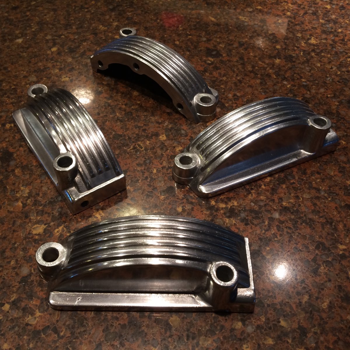

  6. Jiminy
    Joined: Oct 25, 2012
    Posts: 369
    Jiminy
  7. blgitn
    Joined: Sep 13, 2011
    Posts: 109
    blgitn
    Dang! do you have any more pics of the girdle from the sides or bottom?

    blgitn, if you check out Team Vesco's site they have some pics of a Ford 4 banger with 5 main girdle.
