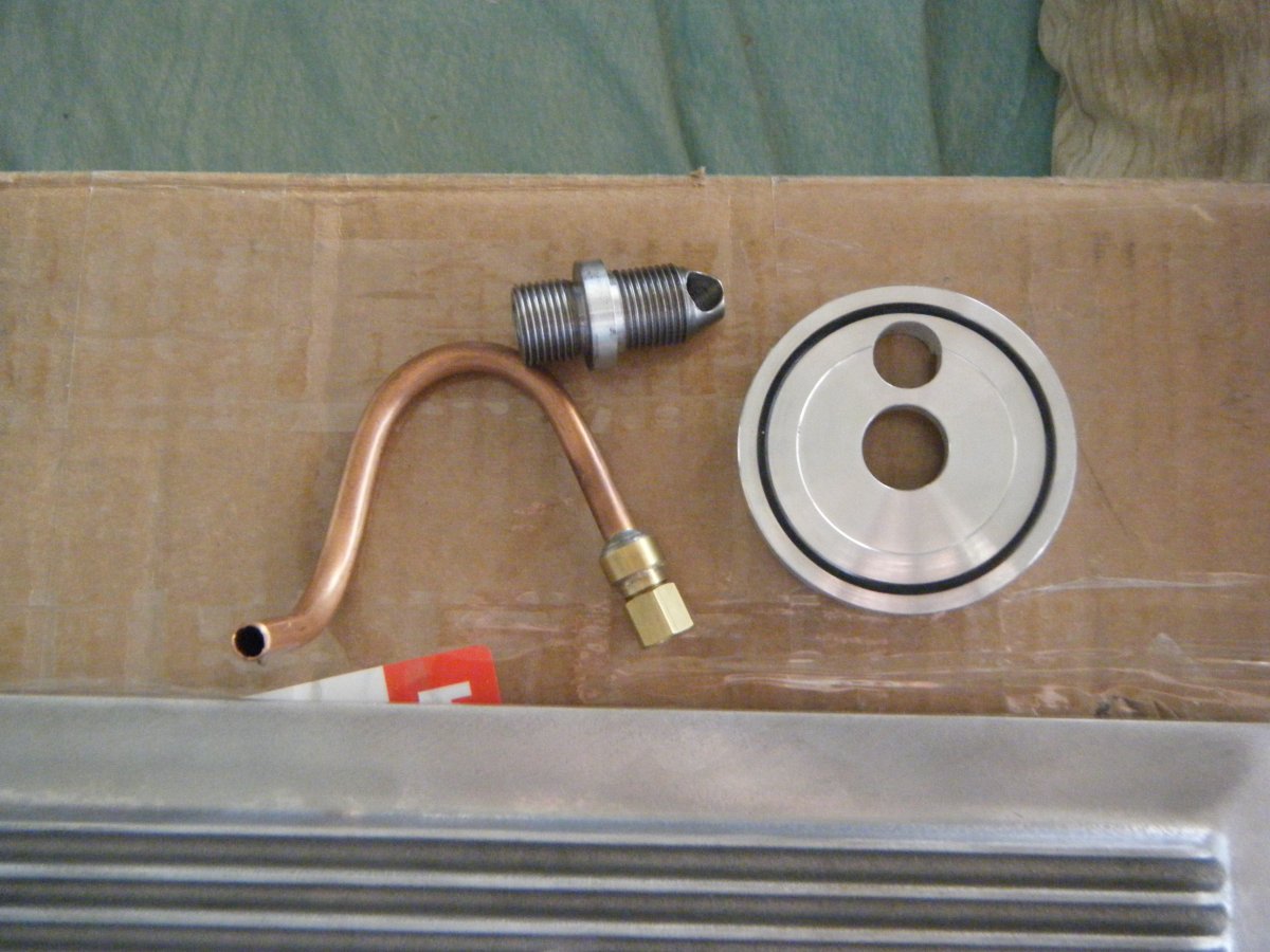

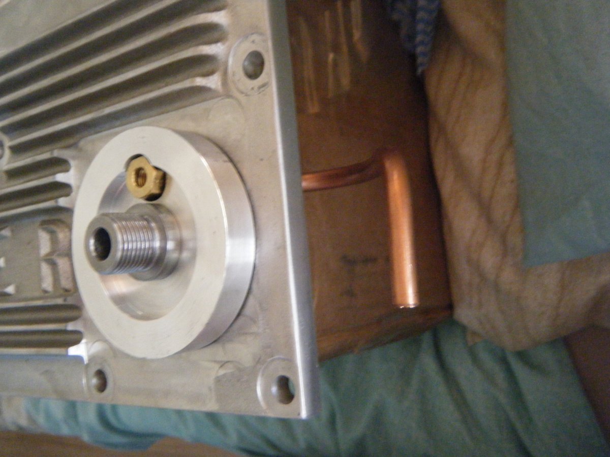

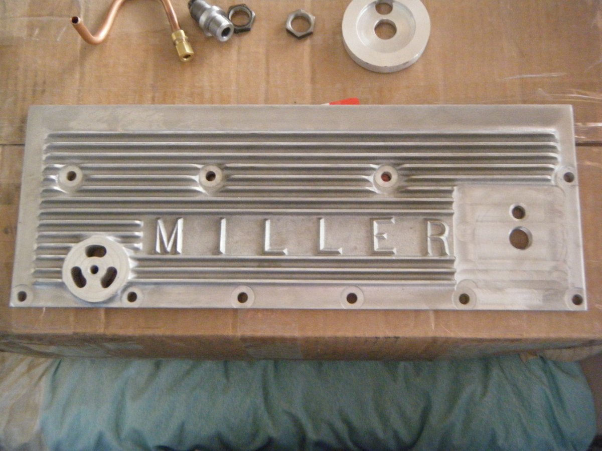

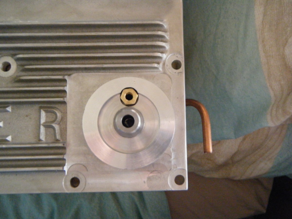

    I am going to install my Miller OHV head soon. It comes with a side cover for an A engine that blocks the original intake and exhaust holes in the block. I wanted to run a full flow oil filter, but still install the Miller side cover. I had a Mikes affordable full flow oil filter lying around, so decided to have a machinist modify my Miller side cover to replicate the Mikes side cover. See below for pictures showing the modifications done. I am going to run the 90 degree elbow for the oil filter off the side plate for a neater looking installation. Hope this helps someone else in the future with modifying a side plate for an oil filter.
    DSCF3312.JPG DSCF3314.JPG DSCF3315.JPG DSCF3316.JPG DSCF3317.JPG DSCF3318.JPG

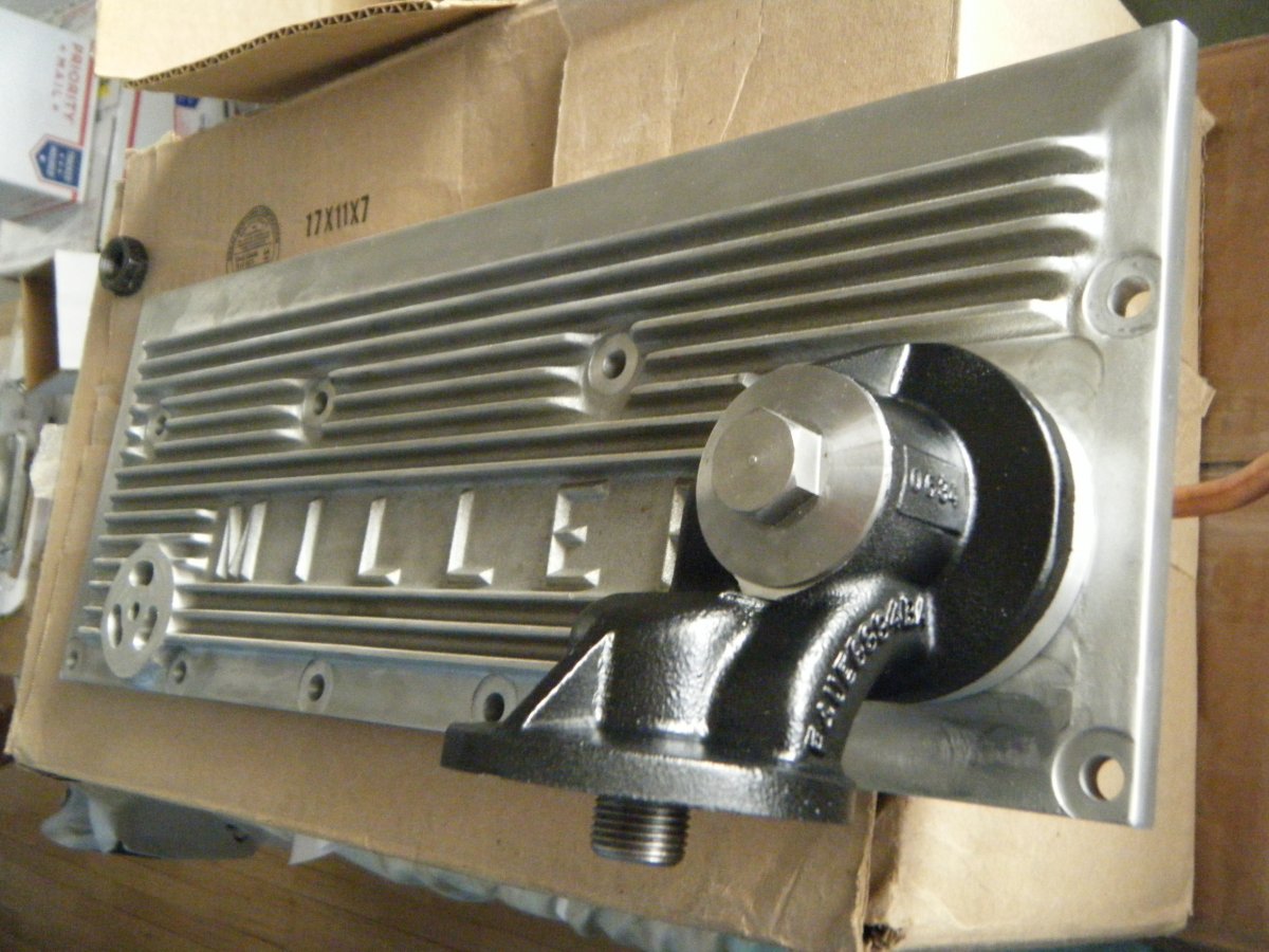

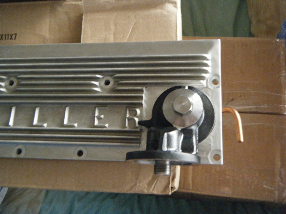

    With 90 degree oil filter adaptor fitted

  25. That looks like a GREAT installation! I'm guessing that to take advantage of that head that you're going to full pressure lubrication. If you are, be very careful of the setup for picking up oil and pressurizing it. I think that I tried everything. The V8 pump running backwards tends to break as one has to grind away too much to open them up by the gallery. And the pickup had no vortex shield. I got a hold of an expensive aftermarket pump with a two shaft drive. The builder must've had a short boring bar as the shafts and bushing were all out of line, bound up and failed monterey2016(2).jpg . I ended up with an external pump driven off the nose of the crank, with a shielded pickup in an oil vault under the engine, with HORIZONTAL baffles that kept oil from splashing up the sides of the pan and crankcase. Of course my engine is in a race car; but you have to remember: your car is going to go around corners and stop and start. So don't think you don't need much more "splash"!
    waxhead likes this.

    You may recall I use MGB 5-main oil pump rebuild kits to make my pumps ..... Cheap, easy, an gearotor design. They can run either direction depending on how you carve the feed relief in the ends. I have a large bar of aluminum hex. I don't have to change chucks. There is enough oil output to keep my little shit turning way past the manufacture redline
    You don't need an expensive pump if your willing to do a little work.

    John, thanks for the info. Unfortunately my engine only has the old dipper oil system at the moment, so I will have to keep the revs down :( It does have a counterbalanced crank, insert bearings and other goodies on the inside though. I am waiting to get hold of one of Tod Buttermores new aluminium blocks, and then I will build an engine with pressurised oil for the head. I can't wait for the new engine (patience is a virtue that I am lacking) so I am going to install the Miller OHV on my current engine.

    I DID forget to mention the need to take the oil off the crank! In many cases though, guys forget to devise baffles to keep the low pressure system created by the spinning crank from pulling the aerosolized oil back up into that crank. The vertical baffles (with the Hamster doors) keep the oil quiet while sitting at the stop light; and the "Windage Trays' keep the flies out of the oil!
    I'm thinking that High R.P.M. isn't what broke the cranks and flanges on my disasters (it added to it). It probably weakened them. Then when I let up on speed and power putting the crank speed back into a harmonic condition of that particular part, within as long as a couple of minutes; and one or more turns on the track..CLANK!..DING-DING-DING!
    And, finally (I think I've said this before) turning these long stroke A's and B's much over the high 4000's to 5000's, the point of diminishing returns has been met. You will be losing more to friction than you can reasonably gain. I think it therefore is wise to design your valve timing accordingly.
    RE: the Serr OHV Miller..I would NOT put on any higher compression until you install a full pressure/high volume lubrication system!
