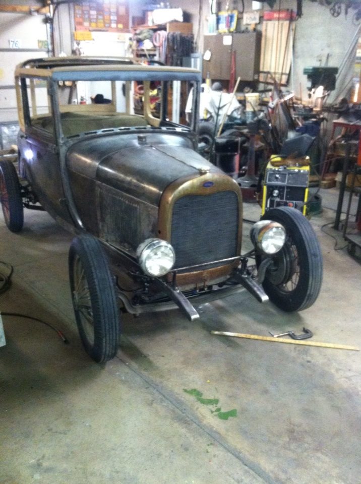

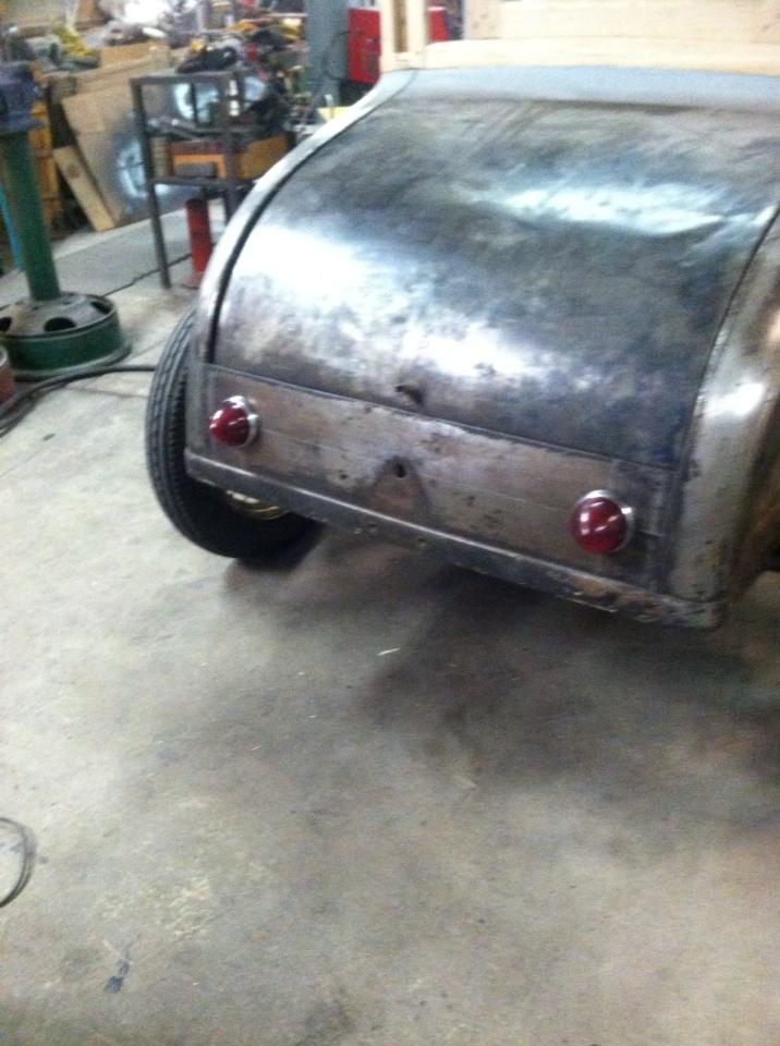

    I am trying to get my coupe up and running by the summer and I realize I am running out of winter! My plan is to get it together and drive it through the summer and work out the bugs and take it apart for paint and upholstery next winter. I have recently finished building headlight bar and installing taillights. Now comes the rebuilding of the sheet metal for the roof[/ATTACH] Headlights2.jpg Tail lights.jpg
