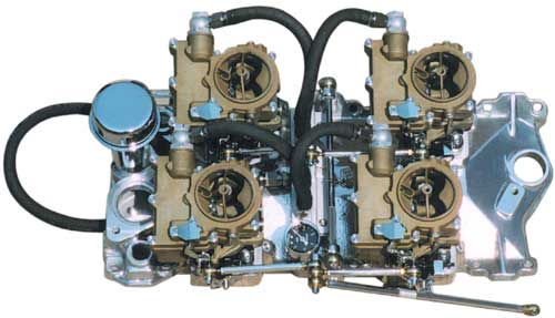

    Don't know if this will help, but here's a comparison of a M-A-F and a Weiand from 61. It appears the carbs aren't staggered as much or the same on the M-A-F as the Weiand. Don't know about Edelbrock or others.

    That picture certainly contradicts what I said. I know they had a version that mounted the carbs. sideways. Is the one pictured and in the ad and early version of this and they later turned the carbs.?

    Not trying to hi-jack the thread but I just bought an Offy unit like the one in this picture except for 3 bolt carbs. When I first saw it, I thought that each carb did 2 cylinders. It turns out that there is 1 main runner on each side with a cross over passage at the front and the back of the manifold. Can't wait to get it finished and on my car
