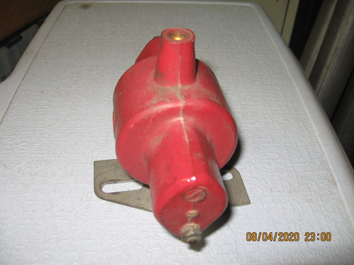

    From all of my "adventures" with Mallory's, there seem to be three different ways that dual points can operate. The one most of us are familiar with is the kind where the two sets of points operate together to increase the dwell (like a pre-49 Ford). The "leading" points open to start saturating the coil. later, before the first set closes, the "trailing" points open and keep the circuit open a bit longer for increased dwell. The second type is shown above where each set of points operate alternately. Each set opens saturates the coil and closes, generating the spark for alternate cylinders. This setup has one terminal on the distributor, and each set of points operate alternately to produce spark. The third type requires a special coil with two primary windings but only one secondary. I have one of these distributors for my '51 Olds Rocket. This type has two terminals on the distributor, each feeding one primary winding of the special coil. One set of points open and close and energize one primary winding generating a spark to a cylinder, and the other set of points cycle and energize the other primary winding generating a spark for the next cylinder. This is sort of a "poor man's dual coil" with a shared secondary winding. It does away with the special (expensive) cap and rotor required by true dual coil ignitions. Both of the latter have 4 lobe cams. The real indication of which type you have is determined by the number of coil terminals on the distributor.
    Here are some pictures of the two different Mallory "FlashFire" coils. The first three (the black coil) are of the special "dual primary" coil; notice that it has three primary connectors, one for each set of points, and one for power from the ignition. The last three are of a regular "FlashFire" coil with only two primary terminals, like a regular coil. Also be aware that Mallory color-coded their coils; black coils are 6 volt units, while red ones are 12 volt. Over the years, I would imagine that a lot of Mallory components have been mixed up or lost. Simply trying to assemble a working ignition is more complicated than just assembling random parts.
