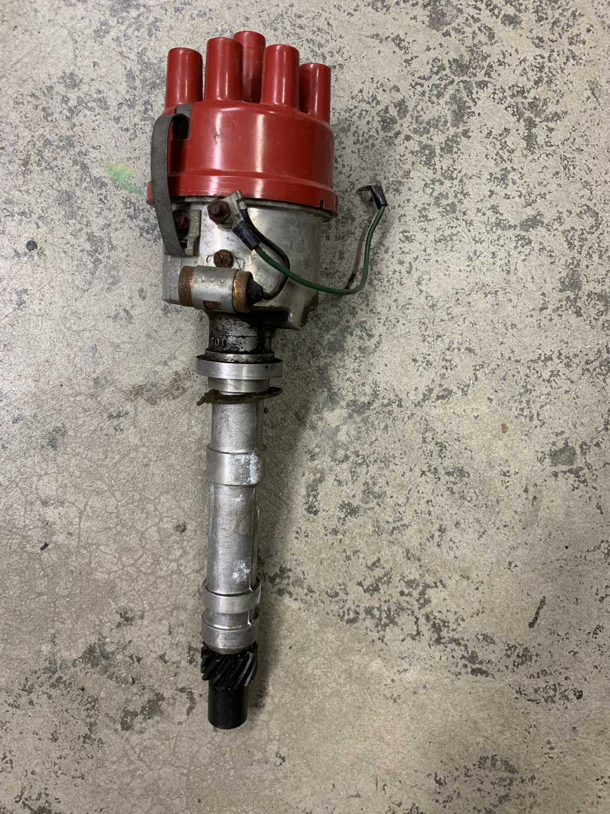

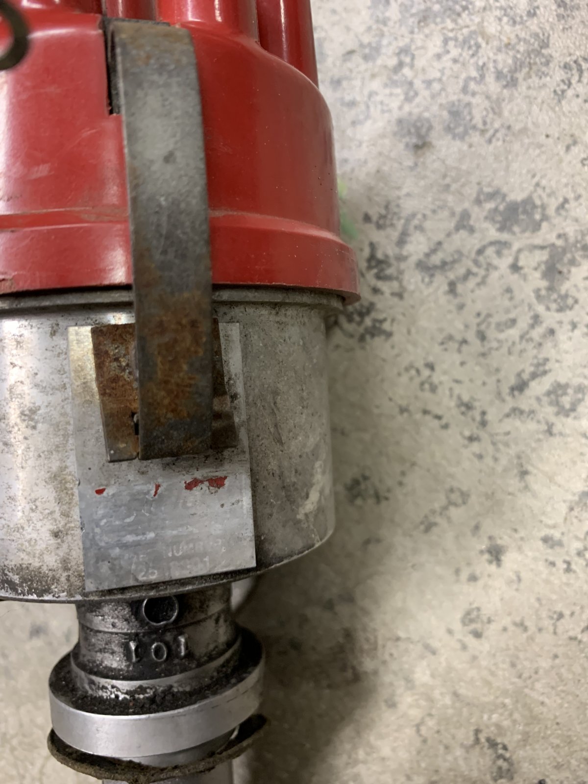

    I just got an old Mallory Double-Life Dual Point for my early SBC that I'm building. It is a YC-310-F. I know that the YC denotes a Dual Point with this specific body, and I know that the 310 denotes Chevrolet V8, but what about the F?
    I've read, mostly around these parts, that the suffix has to do with the mechanical advance curve but I haven't been able to find a reference for what those differences would be. The most common ones seem to be HP, F, and G but I'm sure that there are more out there. One blurb in an ad said that G was for corvette applications, but I feel that that is just seller's hype.
    I'm hoping a got a good one for a street application, but even if I didn't, the flat cap on this one should be worth more than what I paid for the whole thing...

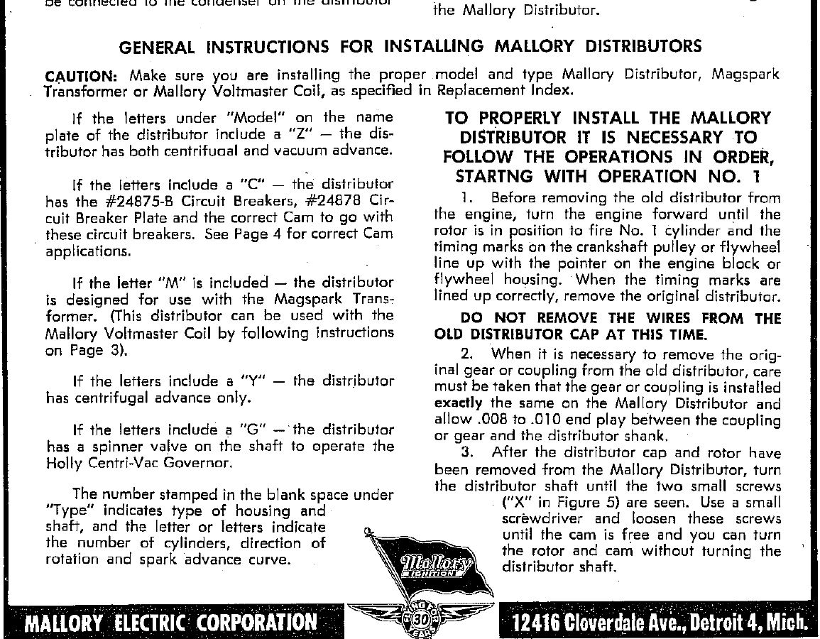

    Yes, as you said YC denotes a Mallory being dual point but so does ZC. The YC Mallory’s are centrifugal advance only, while a ZC has both centrifugal and vacuum advance. I have never found any info that explains the suffix letters.

  10. This is true according to this..

    It does, and thats where I'm pulling this info from. However, that list has many holes in it, it doesn't even show the 310F that I have, and is not searchable in the way that a typed-in post would be. While I'm being selfish asking for information, I may as well do something for the good of the HAMB and the web while I'm at it...

    It does show the 310, the suffix letters are merely different advance curves

    kadillackid posted a page from Mallory Form 347 and it mentions distributors stamped with an M, if you run across one of those check to see if there is a jumper connecting the two sets of points. A virgin "M" dist. will not have a jumper, those points are wired separately to a Magspark Transformer. The side of the Magspark with a tag stamped with a P connects to the condenser on the distributor and that condenser should already be connected to the P terminal. The other side of the Magspark will have an R terminal and that obviously goes to the other set of points connected to the R terminal of the distributor body.
    If an M stamped distributor has been changed by someone and does have a jumper wire connecting the two sets of points then it can be used and wired as with a conventional coil.
