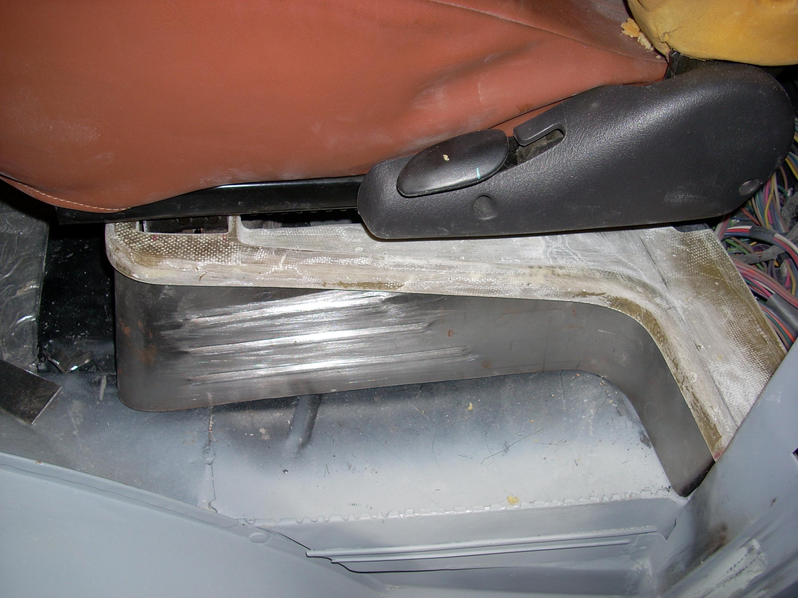

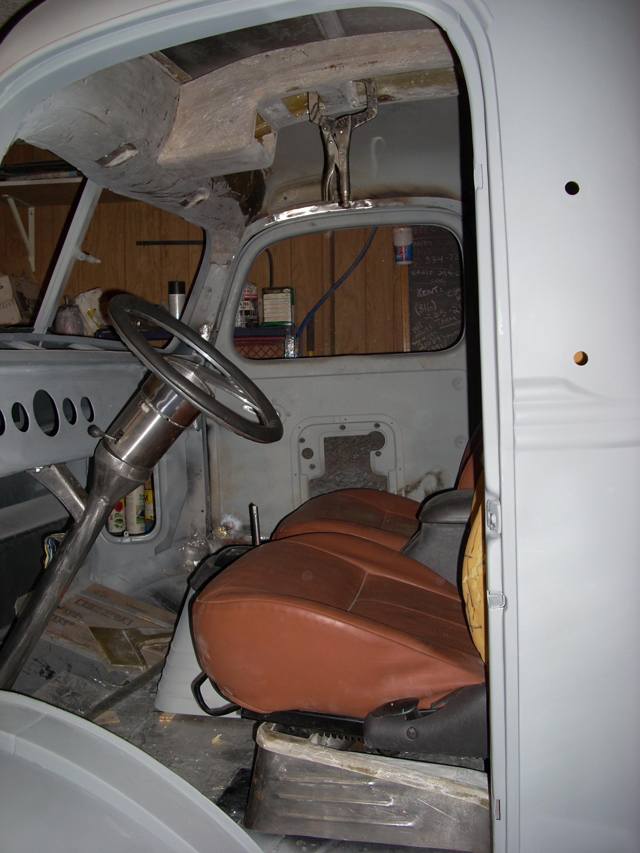

    Did it....was a supreme pain in the ass.....and I flipped my cab upside down....
    Pics if what it looks like in my build thread.
