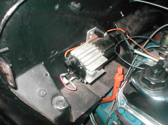

    What I have here is a duraspark distributor, and a Judson coil. On the bench with a Om meter when I spin the dizzy I get no signal. When I touch a flat screwdriver blade to the pick up I can make/break the circuit. Based on this information I find the yellow (orange?) wire to be positive, BLK/BLU to be pick up ground, and BLK to be dist ground. With stuff wired up as shown in the pix I don't get spark out to the plug. Anyone care to point out the mistake in my feeble logic?

    The reason that I think that this should work is that I'v had an (ot) magnetic trigger distributor firing a Judson coil for years in the sport car. The tech is basicly the same, but the OT unit only has 2 wires from the trigger. True... all the books that I have only show the duraspark plugging directly into the spark box. But shouldn't a magnetic pick up perform the same job as a set of ponts? It opens the circuit and the field in the coil collapses resulting in spark. Could it be that I need to power up the pick up in some way?

    Nope , wont work without a control module and then may not work with the Judson ( most of the Judson were positive ground).
    The duraspark is a magnetic pulse generator and produces a sine wave signal based on a moving magnetic fields. Its one of the better ones out there and is a signal generator only.
    The output voltage is approx .250 to 1.00 volts while cranking, this electrical signal is hooked to a control module and the the control module turns the ignition coil on and off providing spark for the secondary ignition of the coil.
    The Judson ignition coil is a capacitive discharge transistorized coil that was built to make the primary ignition voltage to be higher than normal feeding the ignition coil allowing stronger secondary output.
