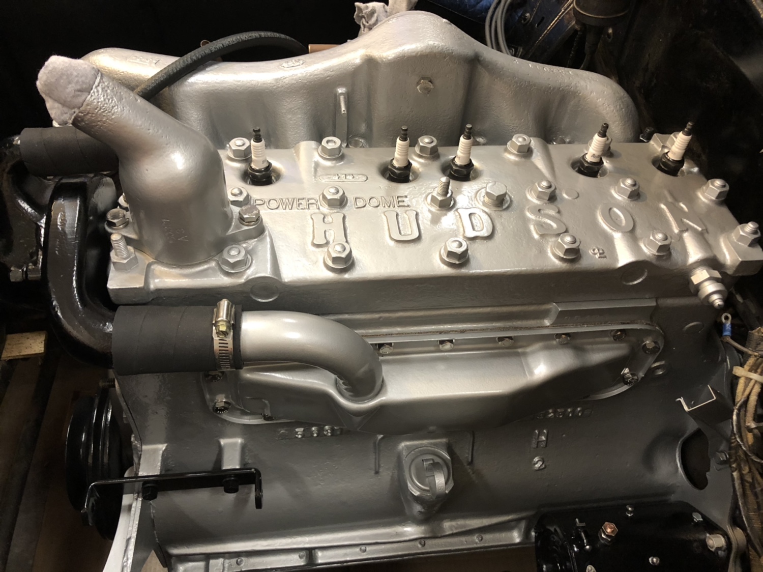

    I was finally able to get some time and try my hand at some newly inspired gasket making. My Lang Gasket punch set arrived this afternoon but the 5/16” punch wasn’t manufactured quite right so I’ll be calling them Monday for a replacement.
    In the meantime I used the 30.06 Hornady shell which I had found to be a great fit for the 5/16” bolts. It was a fraction smaller hole than the 5/16” punch which meant I really had to be precise. I really appreciate everyone’s input and it was great fun learning gasket making. It’s one more way I was able to make my coupe really personal for me.
    The gasket I cut is below the water jacket in the 2nd photo below:

    It was a lot more work & was quite messy but I took my time to do it right not do what Kerrynzl posted. A very thin coat on both sides of the water jacket gasket with Permatex Grey Ultra Gasket Maker and Permatex Thread Sealant on all the bolt threads. Barely had gasket silicone come out after tightening the bolts.

    That’s the way to do it! A lot of people put waaay too much sealer on gaskets.
