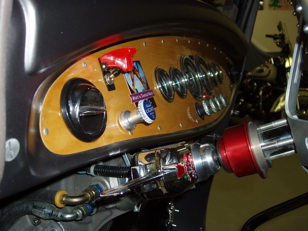

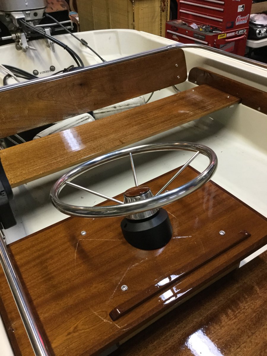

    1. 1/2" wood laminated to 1/2" plywood, for stability (Mahogany boat parts shown)
    2. Wood veneer over the substrate of your choice (Maple veneer over fiberglass shown)

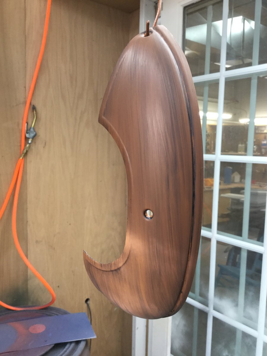

    3. Faux painted (Black over caramel, on steel, shown)

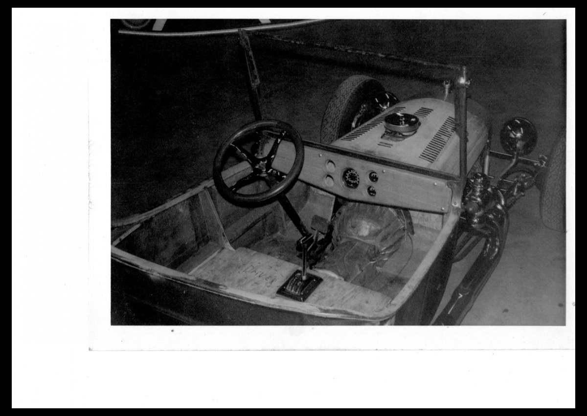

    I built a "T" with a wooden dash 40 years ago, using walnut. After making the panel out of aluminum, with all the guages in place, a friend did the woodwork. He cut the holes oversize, routed them, and we mounted the aluminum to the backside, to recess the guages 1" and provide a good ground. img20170131_09445649.jpg
