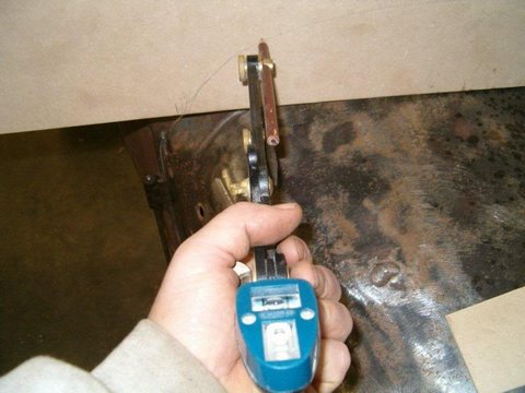

  13. That’s the sort of tip I was looking for. I’m doing that with the final template to get a close fit into the posts.

    It can be done without a log scribe. But it is a bit tougher. You can YouTube some great tips.
