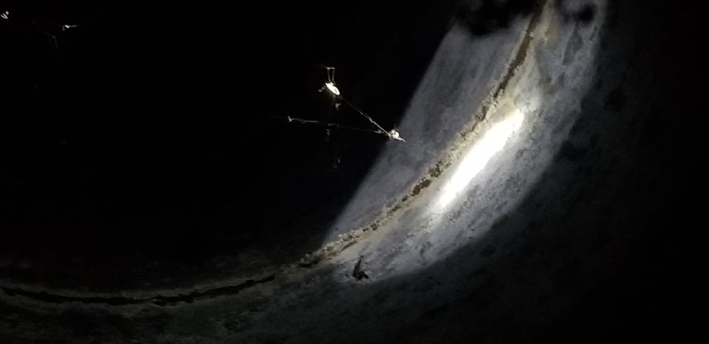

  12. vintage_mpg
    Joined: Jan 4, 2014
    Posts: 48
    vintage_mpg
    Well Budget, I will humbly concede to your knowledge. You have not only given me a lesson in metallurgy, you did it patiently while I did my darndest to force this round peg (tank!) into a square hole.
    Check out these pics. Please ignore the spider webs and crappy photography; I'm using my cell phone.
    There it is: the white flaky stuff you accurately predicted.
    Crap. Back to square one.[​IMG][​IMG][​IMG][​IMG]
  13. vintage_mpg
    Joined: Jan 4, 2014
    Posts: 48
    vintage_mpg
    Will that flaking continue forever?
    Or can I pressure wash/sand blast it to a stable edge?
  14. Budget36
    Joined: Nov 29, 2014
    Posts: 13,275
    Budget36
    I don't think I'd waste my time. Honestly it would make a cool planter, a few legs, flowers/etc.
    Now for sure the last thing I'll say:)
    Why do you think someone had it for sale?
    My guess is someone was told "I wouldn't use that as a gas tank".
    vintage_mpg likes this.
  15. Ned Ludd
    Joined: May 15, 2009
    Posts: 5,051
    Ned Ludd
    I don't know about US practice, but water heaters here have had copper inner pressure vessels for ages. That and lack of provision for an electrical resistance element and connection suggest that it isn't a water heater.
    Galvanizing over the rivets means it was hot-dip galvanized. I've often specified hot-dip galvanizing to one-off steel items, and if there are 40'-long galvanizing tanks in Cape Town there will certainly be ones in Colorado. You should have no problem getting it regalvanized. The tank would be heavy if it has already survived hot-dip galvanizing once without warping.
    I'd say it's too heavy for anything but a large speedster e.g. American LaFrance etc., but I'd paint it.
  16. vintage_mpg
    Joined: Jan 4, 2014
    Posts: 48
    vintage_mpg
    That's something I've not thought of. Perhaps it can simply be galvanized a second time, and then it would work perfectly for my needs.
    Great idea. I'll make a few phone calls come Monday morning....
