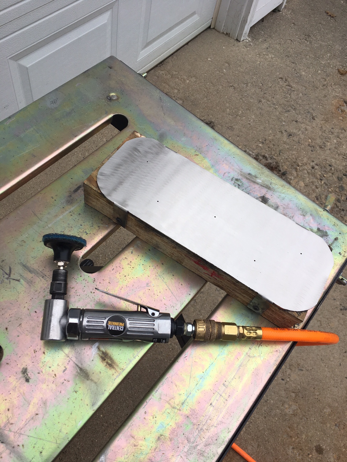

  1. Went through the same thing with my '35 Chevy. It has a '34 master dash in it, and had the exact same ball-milled insert as yours. I wanted to mill off the ball-milled lines, and engine turn the insert. I finally decided that would be too much going on, because I would want to do the glove box door to match. So I made a dash insert from a sheet of guitar pick guard material, cut with a router, and held in place with double stick tape and the gauges holding it in place. Very happy with the results.
  2. BTW, here's where I started.
