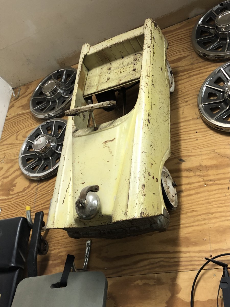

    So in about 2011 I picked up this Murray 1959 Fairlane for a future project. My son and I decided it was time to restore it for his new son. It has been wall art in my barn keeping my GTO hubcaps company since 2011.
    Is was it pretty good shape. The craigslist ad said “California car no rust” which was true.
    It was originally a red fire Chief but at some point it was painted yellow.

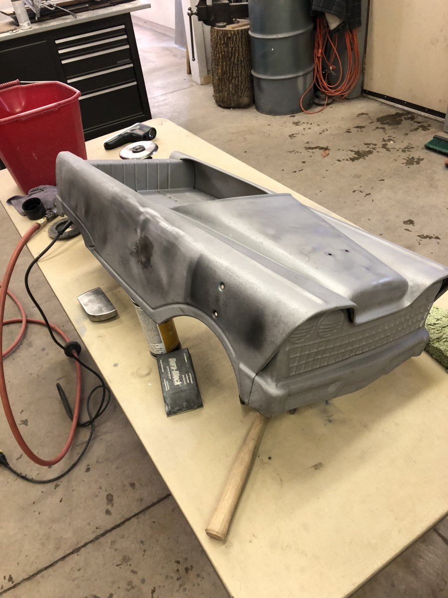

    First step was sandblasting and block sanding to look for damage that will need repair.

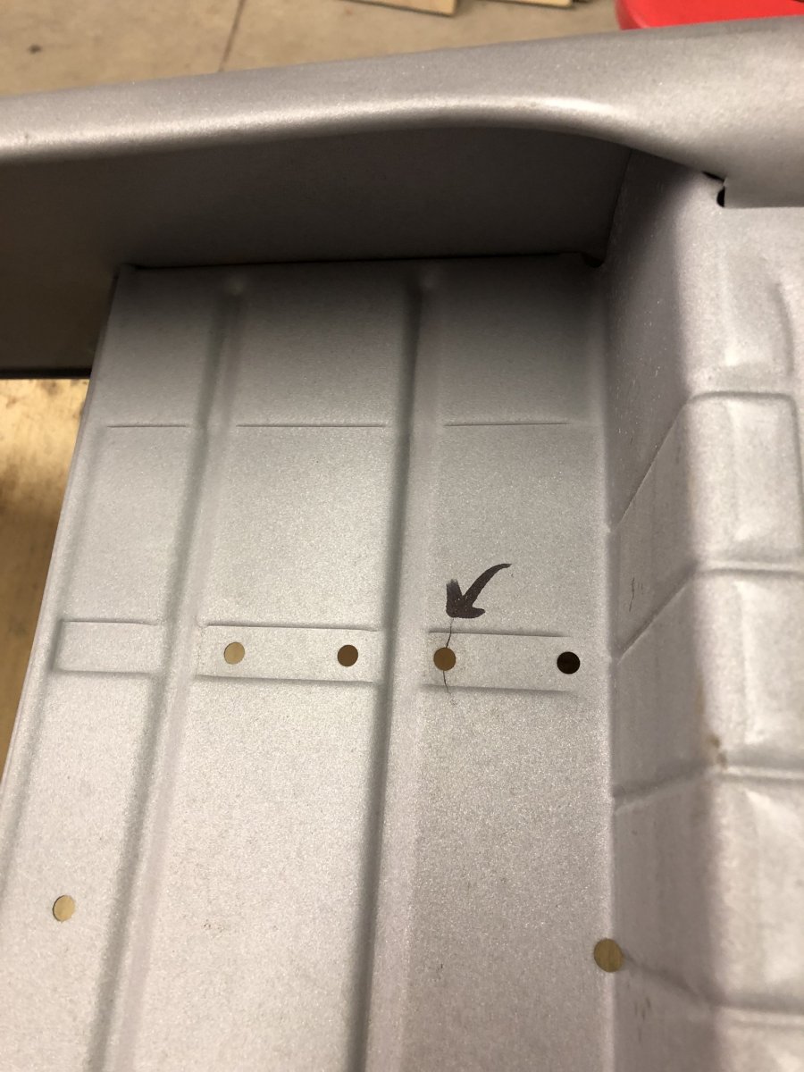

    There were numerous cracks that needed to be welded. Since we are Pontiac guys we wanted the car to look like a 1958 Star Chief so the fire bell was not being reinstalled. So holes needed to be filled.
    Many weld repairs!!

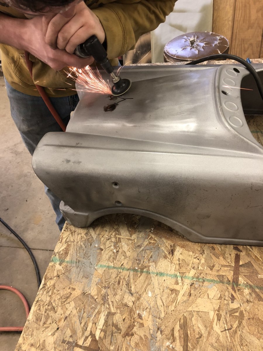

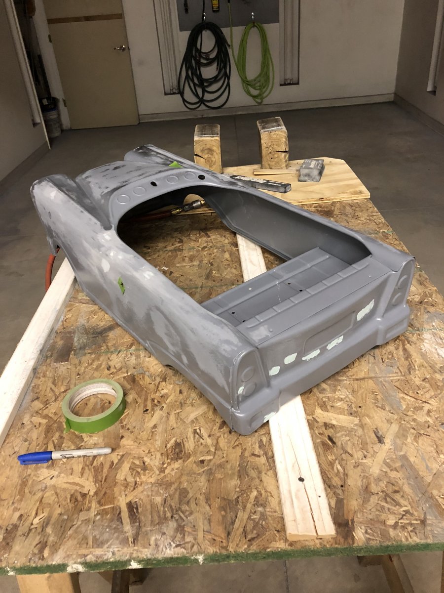

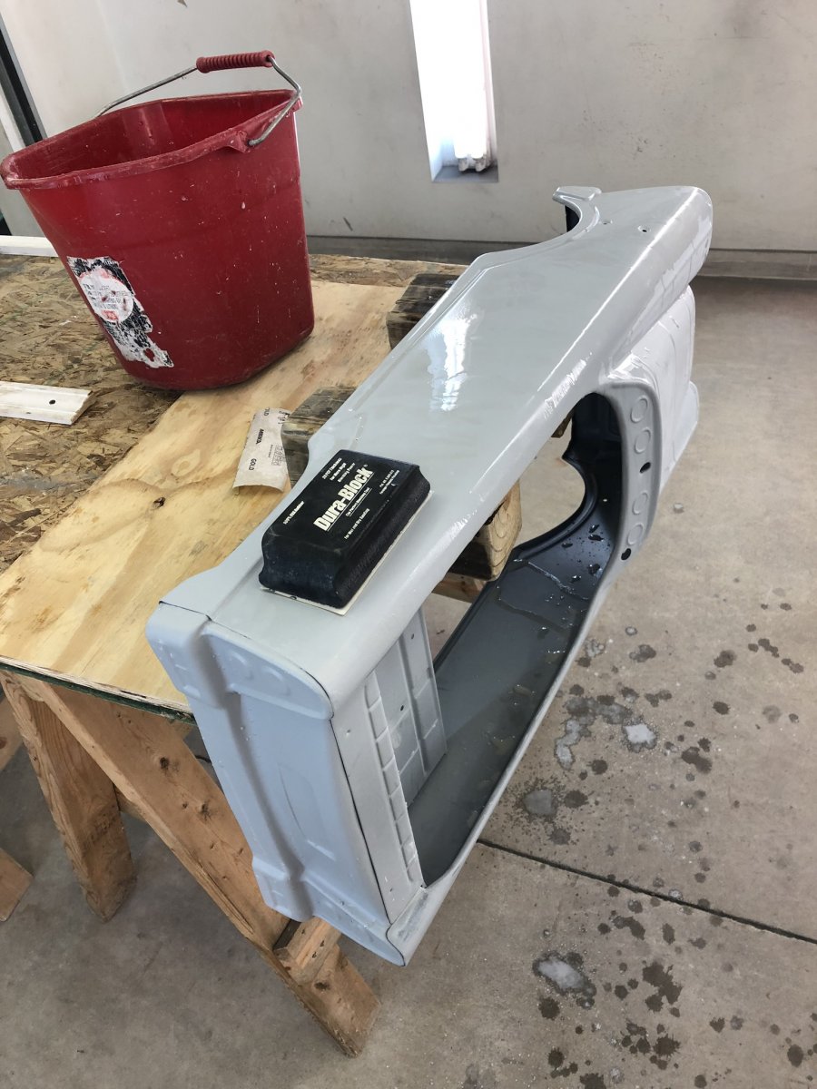

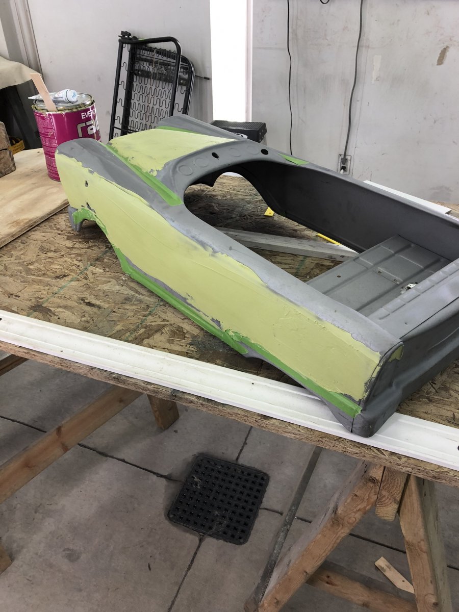

    After welding , it was grinding time.

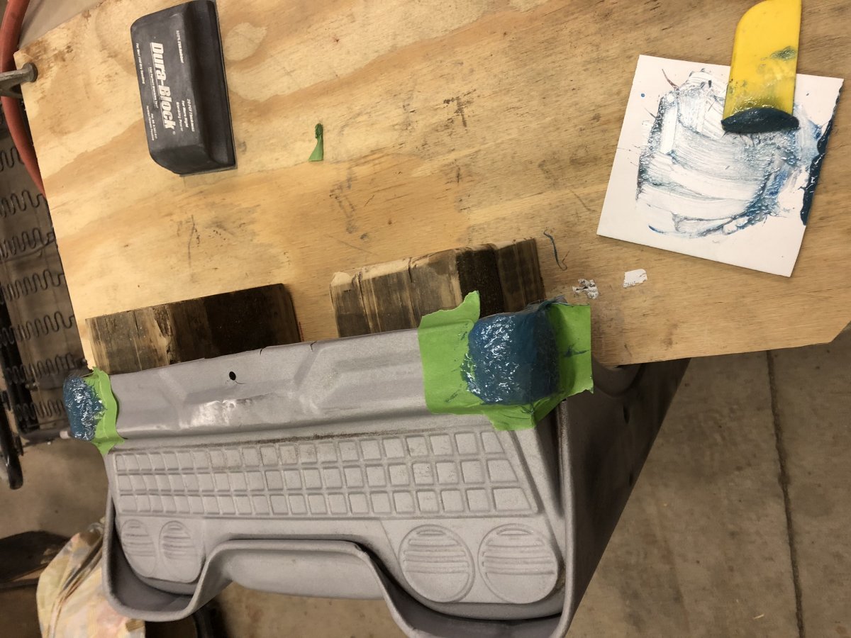

    Then came some tiger hair for the corners to fill in past dents and where I know the corners will take a beating in the future.
    After some hammer and dolly work it was time for body filler.
    And sanding ...... and more body filler....and more sanding.....and more body filler.....I am not good at body work!!!!

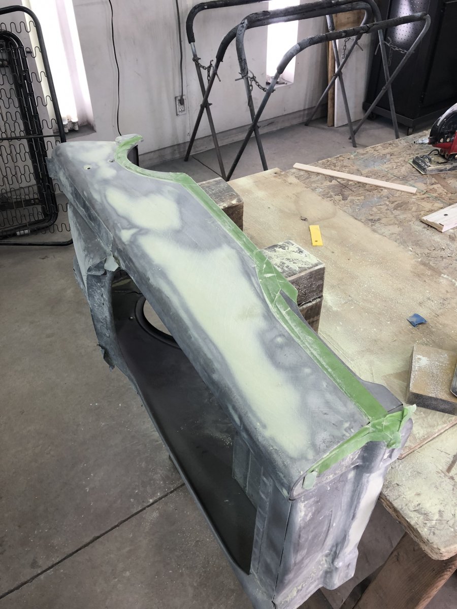

    Finally it was time for 2k epoxy primer.
    And then fixing spots we somehow missed after the car was one uniform color and you could see everything.
    Then finally high build primer and wet sand.
    The metal on these cars is very thin (.030) and hard get straight and stay straight. 17185608-5924-40CE-BE2E-C67125CFEFB1.jpeg

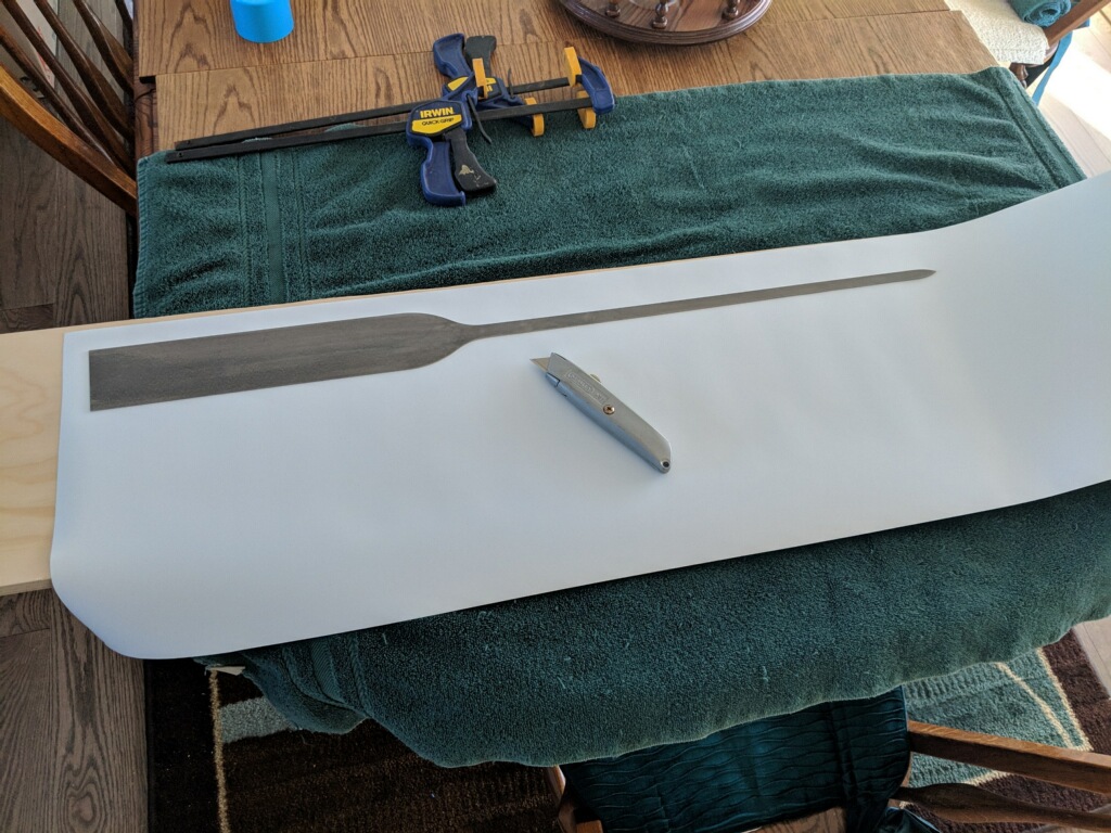

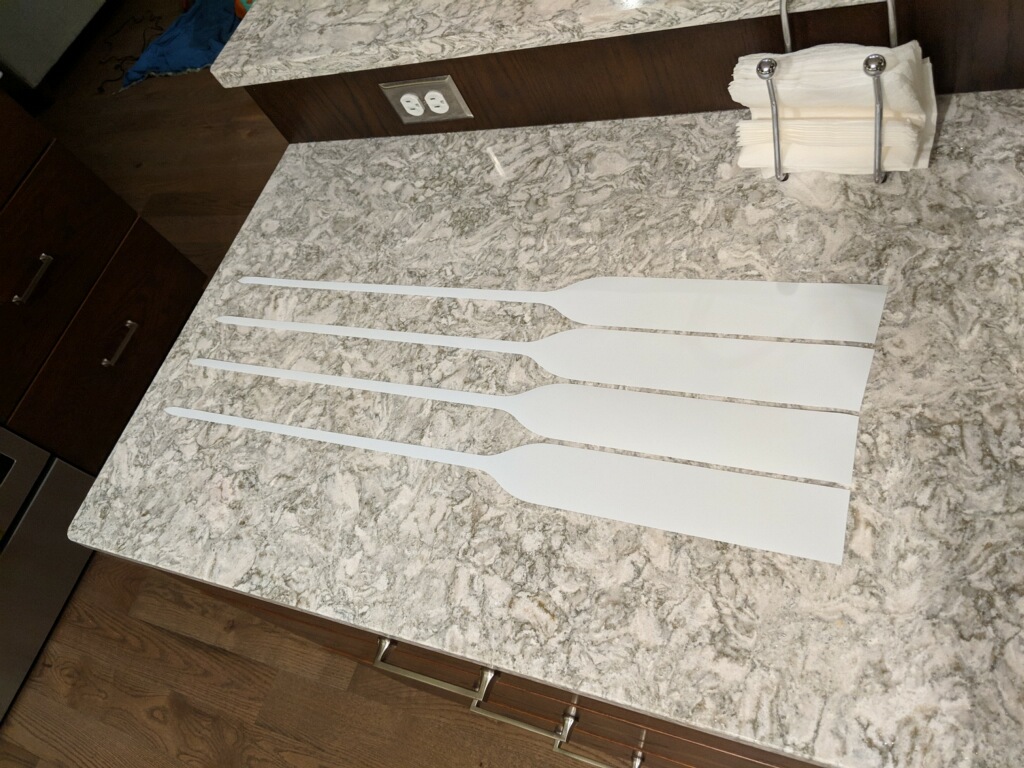

    Basically to make a 58 Star Chief we are putting side spears on like the picture above. My son drew up the side spear in CAD and sent it to a laser shop for a sheet metal template. Then he ordered some white automotive decal Material. With a sharp knife he cut out the decal.
    This is the sheet metal template.
    Here are the decals. (And 2 extras)

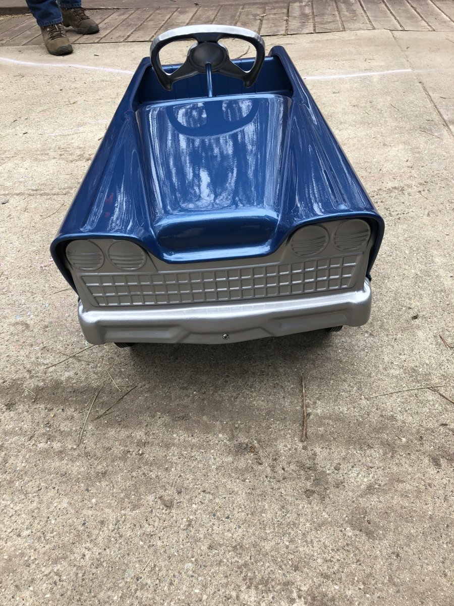

  7. Chief 64
    Joined: Dec 10, 2010
    Posts: 225
    Chief 64

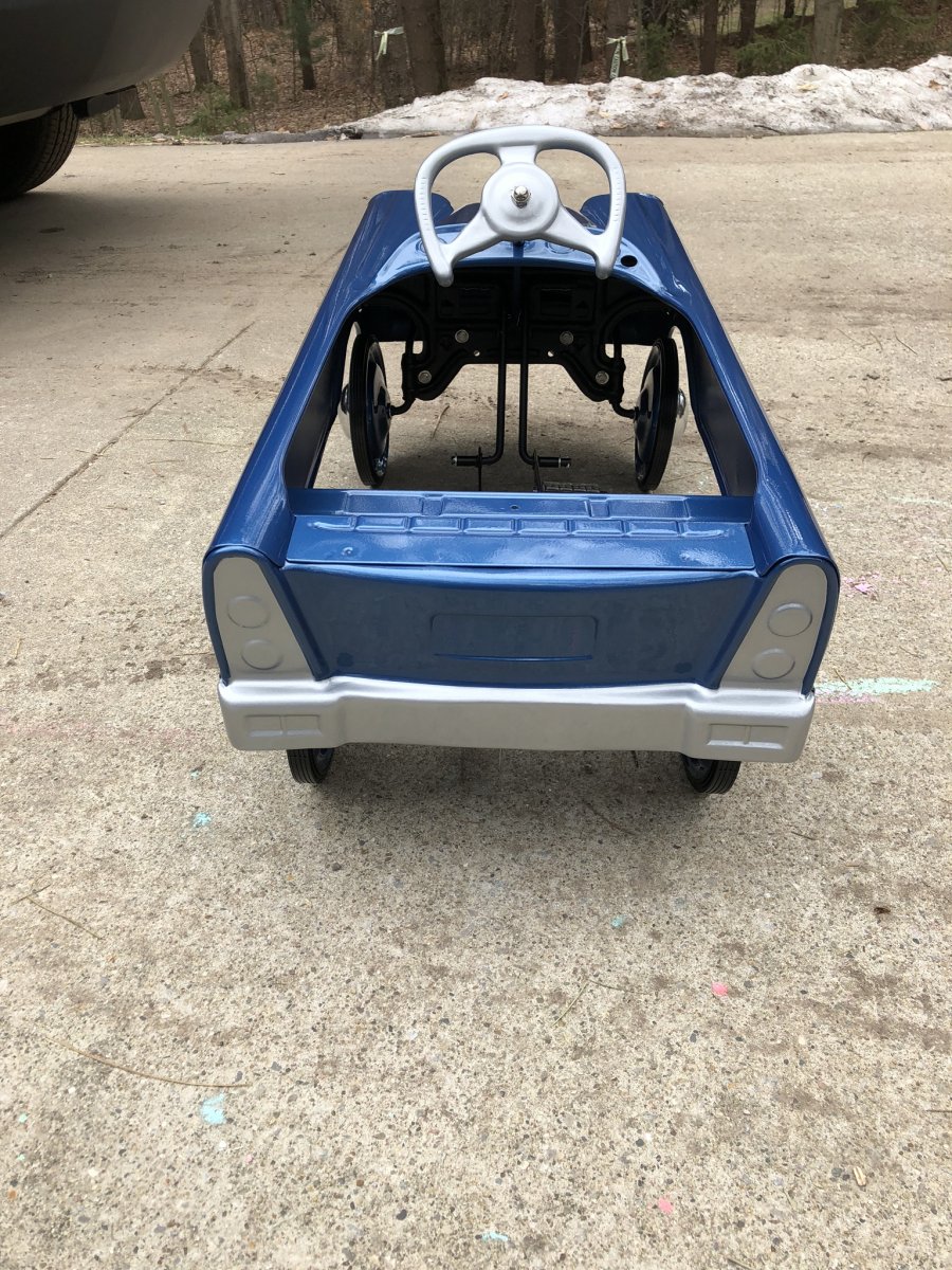

    Hi Guys,

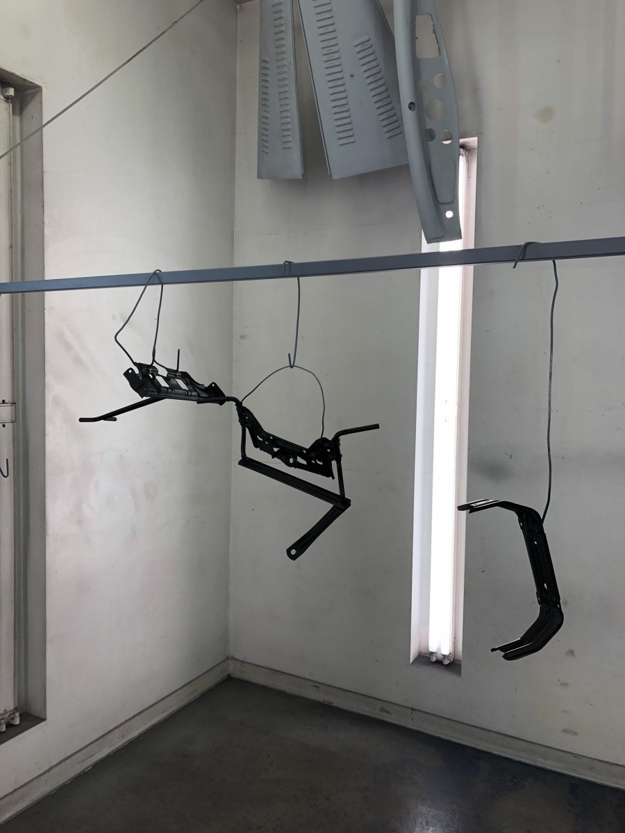

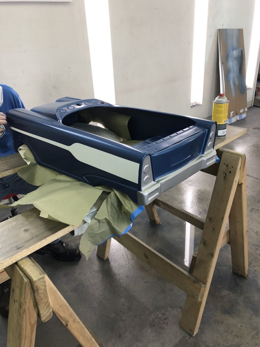

    Finally it was painting day. Geez... paint is expensive.... we couldn’t even afford to replace all the light bulbs in the paint booth after buying the paint!
    First it was blue paint.
    Then as soon as the blue paint dried we applied the decal and taped the front and back for silver paint.
    We used rattle can for the silver and black parts.
    Then after the silver dried we removed all the masking and did clear coat on everything.

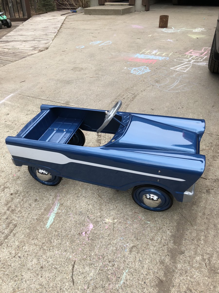

    Finally after a little assembly work, hopefully it looks like a 58 Star Chief.
    My son bought new wheels, tires and hubcaps for it and I think that paid off with the final result.
    All the hardware is new also, new SS bolts, nuts etc.

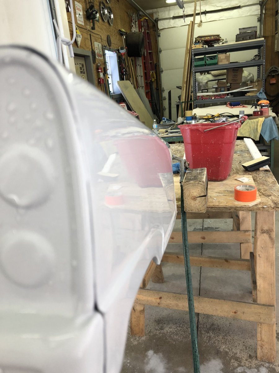

    Next step is to decide if it is worth wet sanding and buffing or to leave it as is. There are a lot of edges to burn thru the clear coat, and if that happens I will wish I left it alone.
    Next step is a cushion seat, some red decals for tail lights and an ignition key. If possible maybe some little chrome stars to put in side spears like 58 Pontiac had.
    Greg

  8. BamaMav

    Turned out real good!
