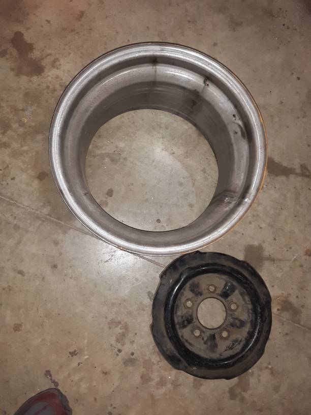

    Any of you guys know of a 15" rim/hoop with a 12" i.d. ? I've been told pre-disk brakes these were quite common. I have a set of old school centers that are 12" wide and ideally would like 15" hoops that would work with them.

    That hoop ID would be 13-5/8", and nobody makes that. There are some new ones at about 13-1/2" though. You would need to cut your center down.
    I've been searching for old wheels with the proper ID. I found a Chevy truck wheel with the proper ID, now I just need to find a match. I've got plenty of old Ford wheels with the right ID but I'm not cutting those up.

    The closest you can find in 15" would be 12.260", the only 12" I know of is 14" General wheels.

    This is all correct, 16" Chevy wheels of the same era have the same ID and can be found in 4", 4.5" and 5" wide. Also some 8 lug Ford truck wheels from the 80s have the correct ID and are 7" wide.
