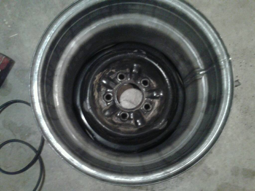

  4. I use my drill press for the rivets. Takes about 5 minutes a wheel. I'm putting wider hoops on these... 1114201537.jpg

    Done several sets. Make sure to move around the rim when welding it back together. Did one wheel and had runout dead nuts but welded to much on one side and now the wheel has a wobble. It’s on my singleseater project so it just adds to the charm of the car, looks like it got in a little rubbin incident with another race car. Haha!

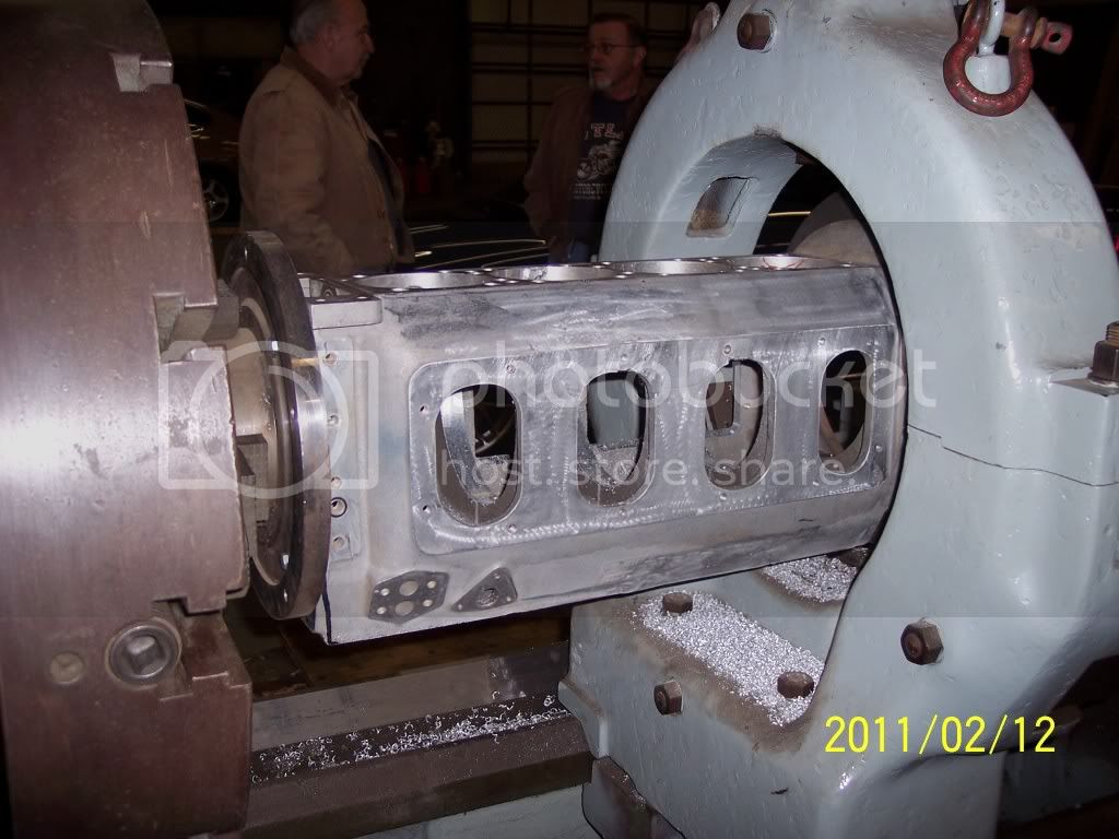

    or ask a friend if i can use his. that's an offy crankcase getting line bored
