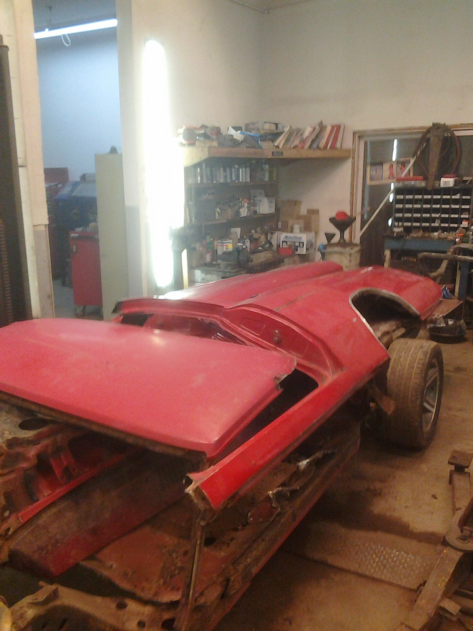

    I am currently doing a 2 dr longroof conversion on a car a year too new for a HAMB thread. So far it is coming along nicely. If you are going to do a conversion there are some things to consider.
    1. Have a design plan. I usually test my ideas by building a model or with pictures and drawings.
    2. Do what you are doing now and see how others accomplished their builds. There are a lot of good ideas out there that could be useful.
    3. Make sure you can get or make the parts you need. In my case I cut up an entire parts car to get some very necessary and hard for me to build parts for my conversion. Other parts got sold to help finance my madness.
    4. Be creative and have fun doing the build.
    Good luck to you and let us know about your progress.

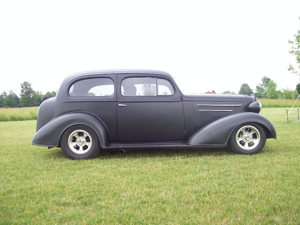

    Guys, sorry I did not be more specific. I've got a shell of a '36 Chevy 4 door and with what is there a 'coupe' length body is about all I could hope for. I think I've seen somewhere that the center section of a 4dr was removed and the front half was attached to the back. Thanks for the replies so far, guys, hopefully someone can remember seeing this done before.

    Not planning to make a coupe from a 4 dr, just hoping to shorten it to the approx length of one. Body is basically a rusted out old race car (circle track) shell and I'm just looking to salvage it for a 'spare time' project. But I appreciate any and all comments - not taking anything personally.
