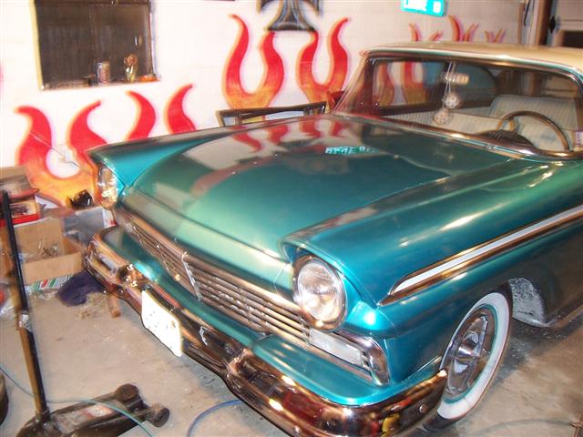

    So I blew up my engine about a month ago (bad thrust bearing walking crank, broke both ends of the crank), and have had some time to do some thinking about what direction to go in with the car, and what the next logical step would be. I've come up with a plan, and have since been gathering parts like crazy.
    I'm thinking of a late '50's kustom, say 1958-1959, built in the NJ style. Nothing too radical, but definitely the full kustom route; walk that line between mild and radical. Right now it's just too mild, and quite frankly, kinda boring me. So without further ado...here's the battle plan.
    -replace engine with low milage 383 I picked up this week ('65, 345 hp)
    -strip and detail engine compartment
    -repair all lower rust and rot (lower front fenders, inner rockers, lower quarters)
    -nose and radius hood corners, mould in fenders to front valence
    -clean up '56 F100 head lights
    -install 55 Plymouth grill (thanks Kustom?)
    -remount dummy spots and lake pipes
    -paint dash and window ganishes to match body color
    -dual frenched antennas
    -'58 Edsel Bermuda tail lights
    -factory style continental kit
    -57-58 Plymouth sport tone inserts inside stock 57 Ford side trim
    -hardcore reverse rake for the bad ass east coast stance (maybe with 4 link and air ride)
    paint will stay the same teal and white, maybe with a flip flop clear in the white. Mild scallops to emphasize body lines will also be added
    I'm leaving out a ton of things i also plan on doing, but these are the high lights. The plan is to debut it at the Road Agent's Rumble in 07. Here are some pics of some progress so far.

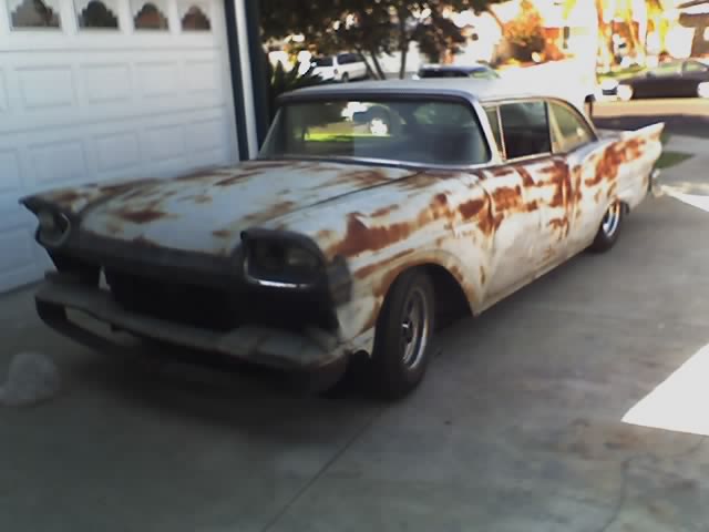

  8. hey Joe,
    I've got a 57 ford still in the works going to be full custom job. how are you going to get the bermuda light in? frenched? otherwise you lose you tail fin tip. I installed quads upfront on my ride, got some lucas flame throwers also. don't know about the rear yet, I think I've seen the plymouth setup upfront before, looks good.

    The Bermuda tail lights are literally a bolt in. They utilize the same 4 bolt holes that the stock 57 tail light buckets use. 2 problems that need to be addressed with the Edsel lights in the Ford: 1) The Edsel tail light has a cast in piece at the tip of the fin to continue the factory Bermuda side trim, which the custom/custom 300/rancheros do not have. and 2) there is a lower "fin" on the edsel wagons that he 57 ford don't have.
    My fix to these problems is as follows. I can either grind off the extension of the tail light to mate up smooth to the fin, whic is no big deal since they need to be rechromed any way (boy is my ass gonna hurt after that bill), or take the 57 fairlane tail fin trim (the dog leg that rounds the edge of the fin and tapers down to the tail light) cut off the curve, and mount it up on the edge of the fin, creating a similar effect as a 150/210 '57 chevy trim. either ill create a smooth transition to the edsel tail light. With the lower fin, I plan on moulding in a lower tail fin, approximately 12" long into the rear quarter (similar to a 61 cadillac, just much shorter) to finish the transition. I couldn't bear to french in a set of tail lights as bad ass as the edsels. Those are chrome and should remain chrome. With the said modifications, it should make the edsel tail lights appear factory installed.
    As for the continental kit, I've always liked the idea of the extended bumper kits, ESPECIALLY on 57 Fords. Reason being is that the customs and custom 300s are 7 inches shorter than their fairlane brethren, and since only the front clips are interchangeable between them, obviously they're losing the length in the mid and rear sections. To my eye, when looking at a profile view, they look too short and out of proportion. However, add 12" of continental kit, and the symmentry comes back and is much more pleasing to me. The cruiser skirts are a natural on 55-58 Fords, and since I'm making the continetal kit from scratch, the pans will be constructed in a manner so that the bottom edge of the skirt continues down the quarter, into the side of the continetal kit and terminate right into the bumper...totally smooth.

  11. Joe,
    what I mean on the bermuda tails is that in order to properly fit them you will lose that extra fin length only the fairlanes have. cutting that part of the bermuda housing is standard to make them fit, I have the original rod and custom article on this swap. I'll have to look for it but I know I have it.
    see attached for the cheap cell phone image.
    300c headlights and stude grille in the works
  12. 57JoeFoMoPar
    Joined: Sep 14, 2004
    Posts: 6,148
    57JoeFoMoPar
    wow abe, that thing is bitchin. The quad lights add a whole different flavor to the front end treatment, I dig it. A 58 hood would look killer with that combo as well. Post progress pics as they come along.
