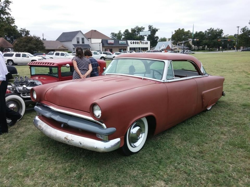

    This is true. once its in primer i wont be worrying about all the work i have to do! once its in primer I will want to be driving and showing it off!
    just gonna leave this photo here to give me inspiration every time I visit this thread. Even in primer these cars are cool!
