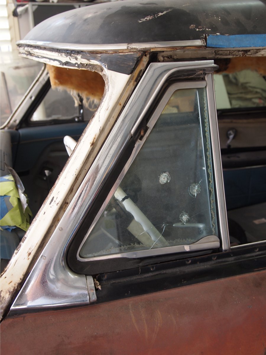

    I hate how life happens and then it takes months to make some progress on this thing! Had to pull drivetrain in my car and replace the clutch and replace seals to fix an oil leak and the broken fasteners and complications that occur when repairing something. I stopped school to be able to find a job and afford school again so I haven't had much time to get to this. But here is the progress...
    P1011807.JPG As you can see the door gap is pretty good but then looking at the vent wing area of the a pillar. P1011806.JPG
    Yeaaaaahhh not as good.. :( This tells me the hinge box area needs tp be aligned better and then the door adjusted.
    There was some actual progress made in repairing the rust and welding this brace back in which should help a lot with getting everything aligned correctly. This is like some kind of freakin 3d puzzle where everything needs to be in place at once for everything else to relate to it correctly. I think I need to relax and just get everything in place and tacked and then work from there adjusting things around.

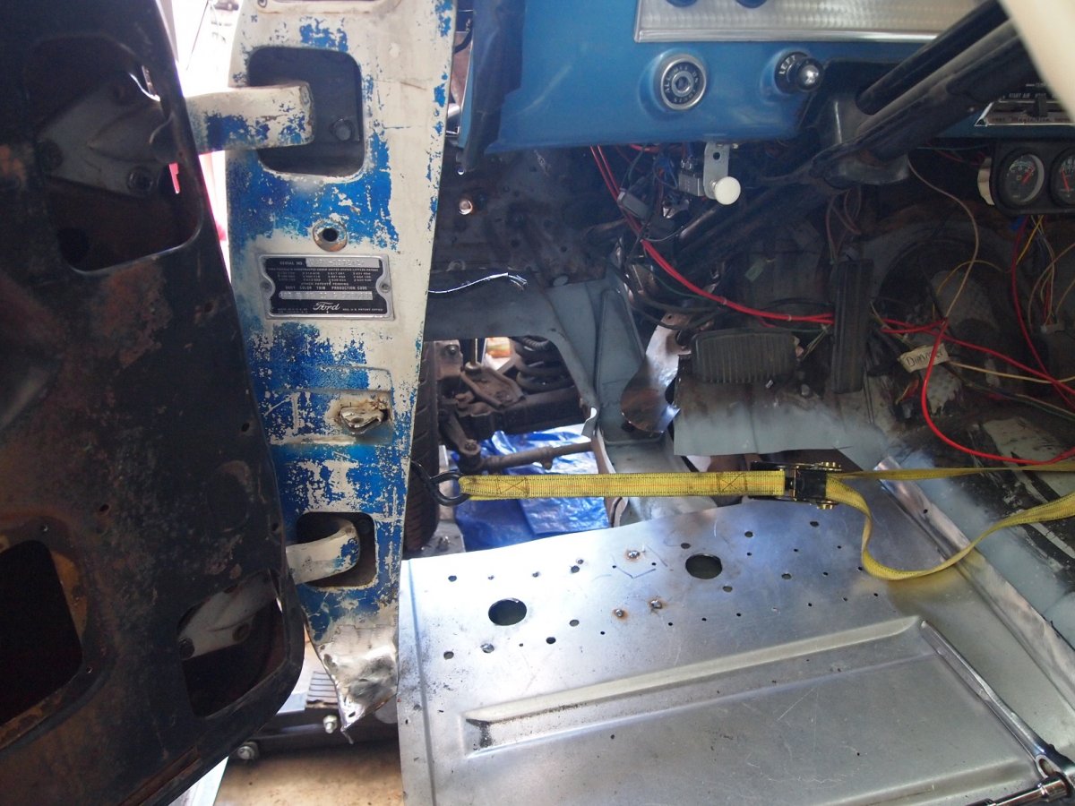

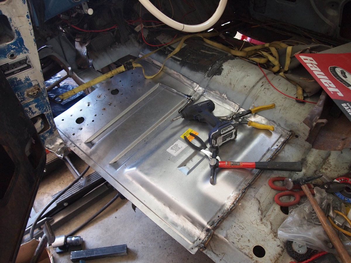

    I have started on this project again. Health problems other projects and crap has gotten in the way. I have the floor pan in and partially welded.
    Anyone have any tips for getting a door fitted in its frame when the structure the hinge mounts to is loose?
    As you can see the whole corner of the car is wobbly and don't want to weld anything solid until I am sure the firewall and door hinge structure is where it needs to be.
    I dont understand how it could be so far off at the vent window when it fits well at the back of the door and at the windshield which must mean the a pillar hasn't moved.
    I am thinking of welding up a form of thing metal rod or strap on the passenger door to index all the angles and such and use it on the drivers side to align everything.

    Seems as if the door is tilted out on top....may have to separate the welds at the cowl and pull the hinged side in a bit ...maybe a come along ..also remember that the gaps are adjusted at the body mounts by shimming...I'm thinking if I see this clearly that's what's going on....I have a 49 dodge wayfarer , never hit that's got a wider gap at the top of b pillar....you may have to pull the cowel down a bit....hope this makes sense..
  8. After seeing your door fit, I wonder if the body was knocked out of square or if the driver side quarter was pushed back. It appears that the A pillar needs to move forward at the bottom, but this would increase the door gap at the quarter if fitting the vent window to the pillar better.

    Thanks for the replies guys. Well it seems I have made some progress I measured the passenger side distance from the bottom of the A pillar/ hinge mount structure from the frame to it and compared it to the drivers side and set teh drivers side to be symmetrical to the passenger side and i think that is what is making the door not fit right. I assumed the passenger side would be correct but noticed it has had some crappily done weld repairs to the floor brace so who know where it should be. I pulled the bottom of the hinge structure further away from the frame and that made the door and vent wing fit much better.
    I measured as many angles and distances as I could bother using plumb bob and angle finders and tapes and it seems like it matches the door opening of the other side and all references I could use. I will temporarily weld a support in place and go from there. Hopefully in the end I will have a car that the door fits right and shuts nice and doesn't look like a piece of crap with weird gaps and stuff all over.

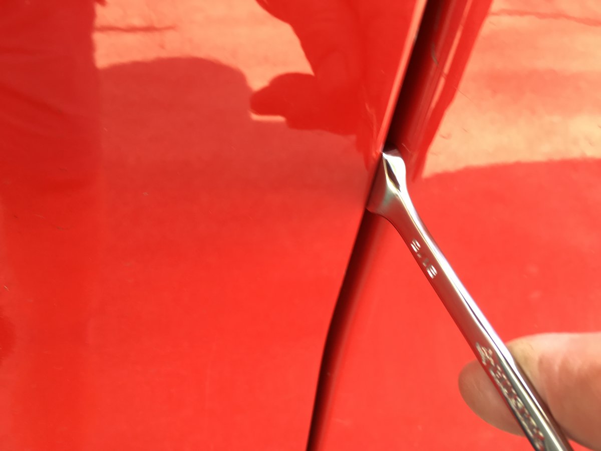

    IMG_5932.JPG IMG_0909.JPG Cars are like houses, they are built from the ground up. Check the door gap to rocker on the un damaged side , I use the flat end of a open end wrench because they are handy 5/16 or
    3/8 depending on the size of gap you want. Then put the rocker in with some screws and line the bottom of the door up to rocker and it will tell you where everything else goes.
    Stand back 20 feet from the car and look at the whole picture starting at the BOTTOM and working up. You will see if your cowel is laying back and needs to be pushed foreword .
    Just start at the bottom and the door will tell you where everything else goes.

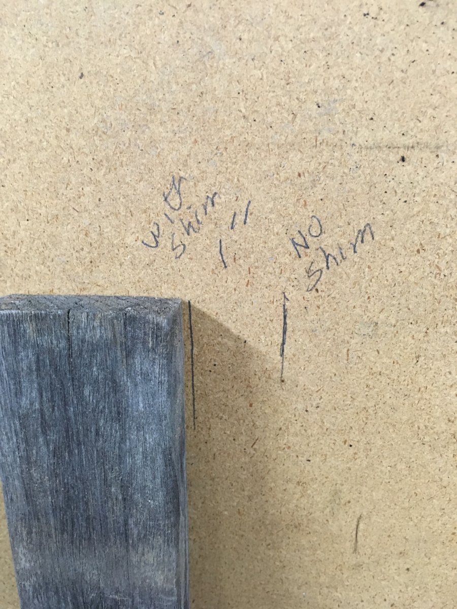

    IMG_0911.JPG IMG_0910.JPG To understand shims take a 2/4 about 5 ft. Long stand it next to a wall mark the wall where the edge at the top and bottom then stick a shim under the bottom corner be sure not move the bottom off the mark and see how much it moves at the top. This is a 1 by 2 that's 4 ft. long and it moved over 1 inch with a quarter older the edge, the longer the board or metal the bigger the variances It will surprise you. Frank
