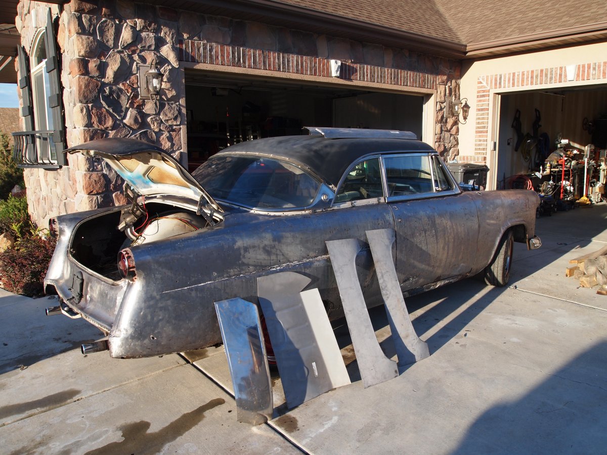

    Lots of work to do! But I want focus on the positive! It has good wheels tires suspension solid FE drive train and disc brake conversion in the front. The rest of the metal is in pretty decent shape and all the trim is in good shape. P9061297.JPG P9061296.JPG
    It hit a bollard on the door and tweaked the firewall and rocker it will be fun taking something this damaged and getting back together.

    This is my thinking and it looks a ton worse than it really is. New floorpan rocker and toe board and mostly there. Just need to find a 54 ford fender and a door. Kinda like a puzzle but more fun cuz more welding.

    Who cut out the door post and floor before they had the replacement parts in hand? Did they align the body before they cut it apart? Did it break the windshield?

    The windshield frame wasn't affected at all I measure the opening and it is square the windshield wasn't cracked or anything. My dad is the one who did the cutting I don't know why I would have tried to push it out with a porta power. Maybe he just assumed we would have to be using a donor car.
    I have all the parts to get it back together except a door and a fender Kinda the more important parts though. I got EMS rocker inner and outer and the floor and toe board. I figure it will be accurate enough to measure the door opening make sure its square and the door gaps are proper and the fender fits up well. Then just a matter of welding it up. I have factory manuals to help as well.

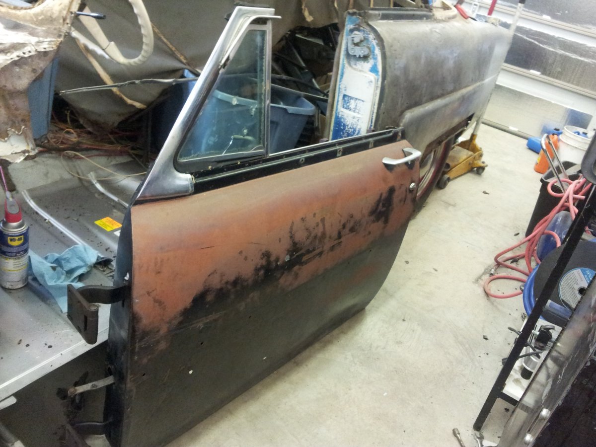

    A little progress!
    Got some doors. Were told they were 52 convertible doors but they look identical to the stock 54 hardtop doors. $100 for two. It looks like the vent wing assemblies are identical. I took measurements of the height and they measure the same. They are in great condition no serious dents or rust no previous crappy bodywork. They will need some rust repair patches in the front bottom corners but no big deal. Having the drivers door is essential to getting everything fitted together correctly.
