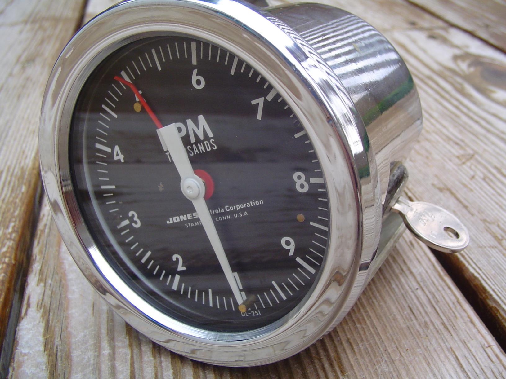

  11. Yep if you do not have a tach drive magneto this is your basic option.

    Stack makes some tachometers that are old-school magneto friendly. Some of them even look vintage.
