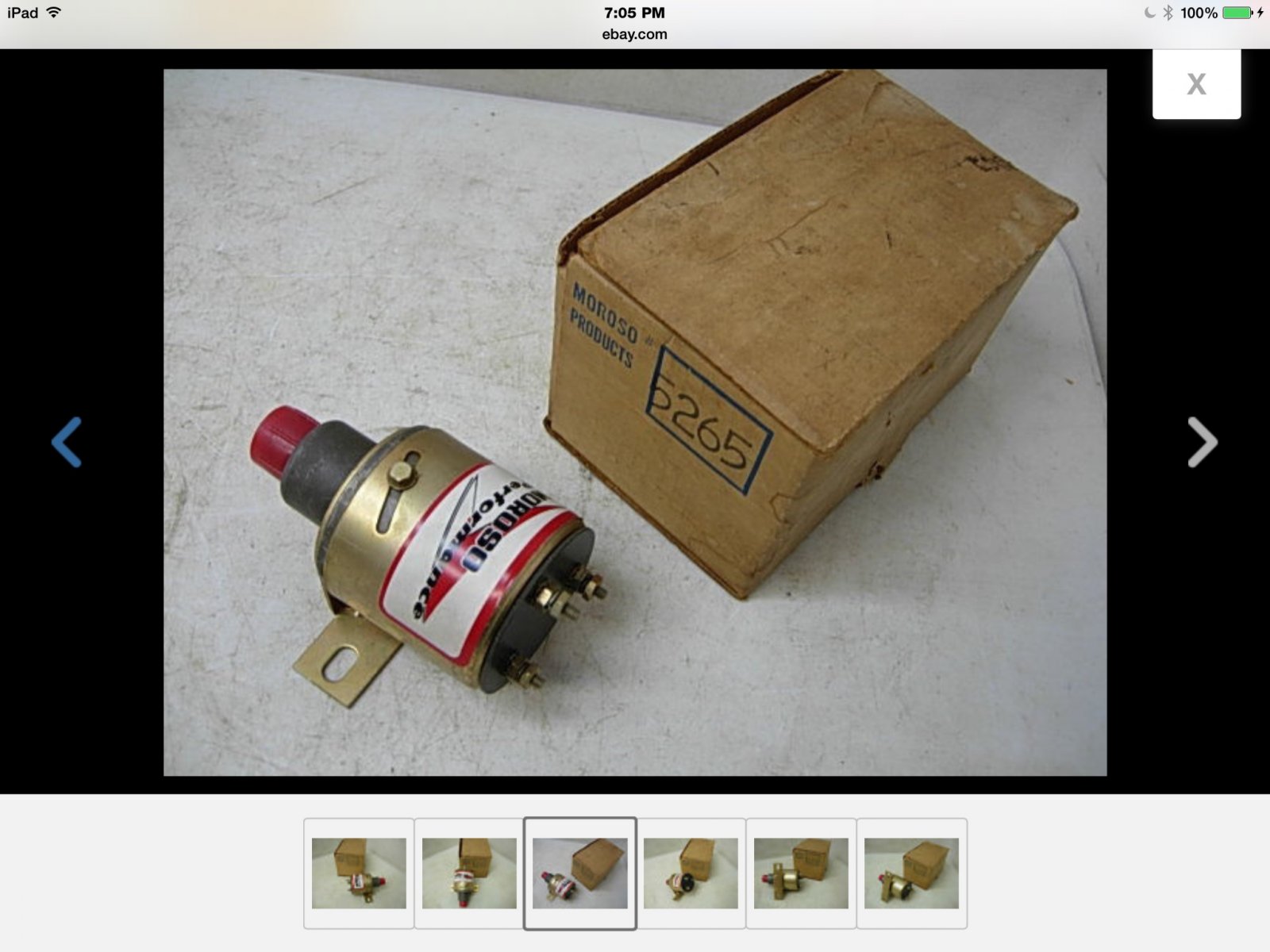

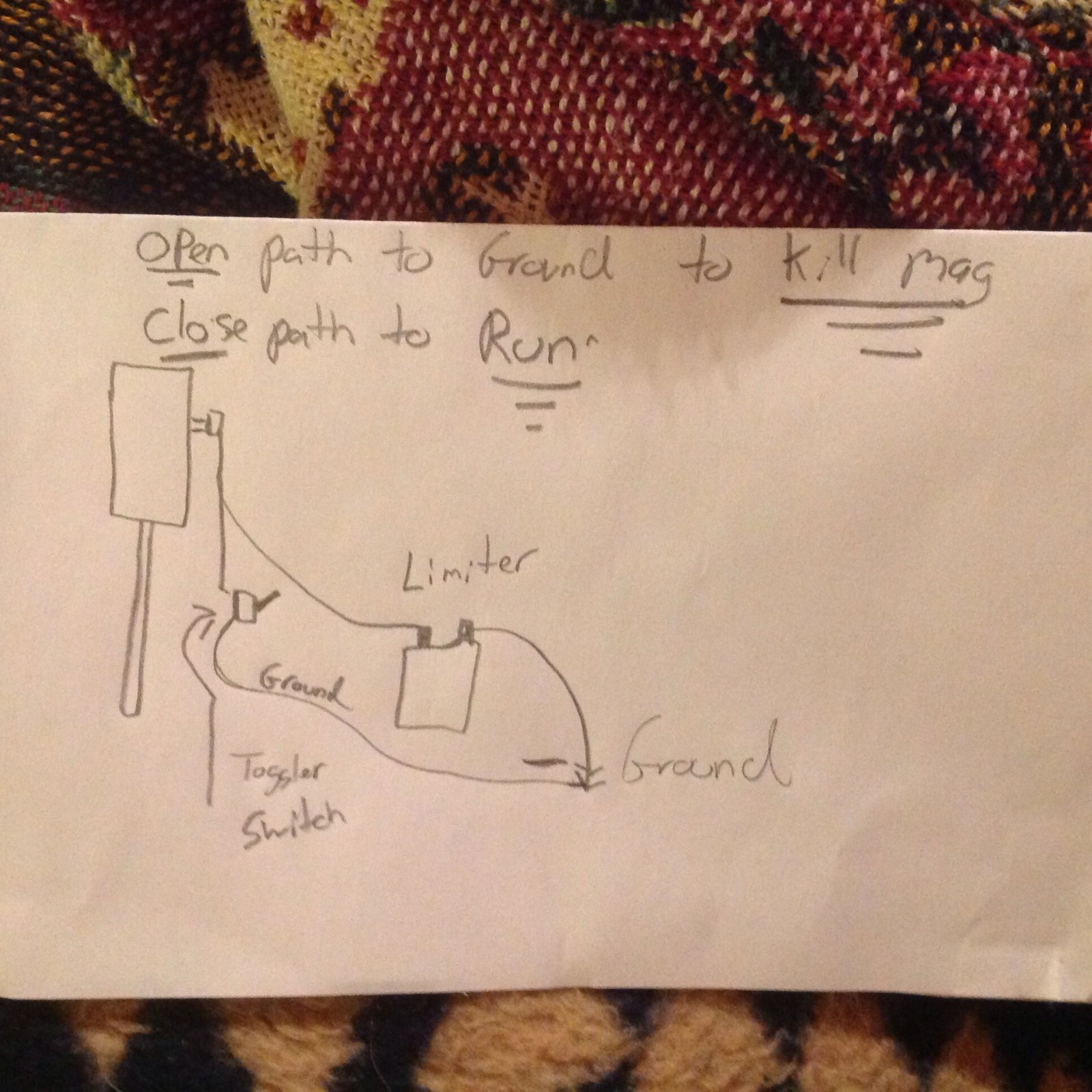

    image.jpg I am unable to see the top of the rev limiter ,
    I am certain that on top of the limiter there is two terminals ,
    One would be to chassis ground ,
    The other one would go from the other terminal directly to the magneto finger nut ,
    & you also woul put a Toggle switch to chassis ground the the mag finger nut ,
    Toggle open to ground out mag to turn off ,
    Toggle closed to run ,
    Very simple ,

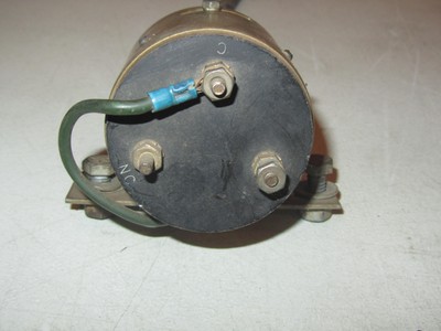

    This is the top view from their add

    Do you have a picture of the "wire" end of that limiter. I run a mag also and have an MSD box for magneto's that I have been trying to hook a shift light to. I saw something like what you have pictured only it was a transducer that converted RPM's to an electrical signal for a tach (I think). I have a 2 piece tach in my car with a sender that works fine but I want that shift light and be able to RPM control my air shifter.
    Pat
  8. UK Slingshot
    Joined: Feb 6, 2014
    Posts: 164
    UK Slingshot
    If you go via the add in my 1st post there are quite a few pictures from different angles

    Hhhhhmmmmmm
    I thank that Is Not aRevlimiter ,
    It's a cable driven Signal converter ,,!!!
    To run a regular 12 V modern tach ,
    falcongeorge likes this.

    Morose part ,

    Unit is not a pulse generator. I ran the exact setup back in the day in a D/Gas car. The rpm shutoff is adjusted by rotating the slot and lock screw on the side. Grounds the mag. Still have the Jones Motrolla tach.

  17. Very popular in the very early pro stock days. Loosen the set screw and twist the top. Thats what the slot is for. Never use heavy grease on the cables.
