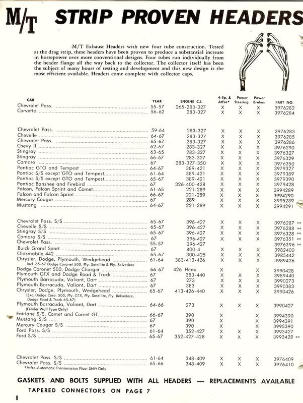

  2. M/T catalog, 1968........

    Wow, havent seen these since I put them on my 66 chevelle in 1970. It had a 427 with 12.5 L-88 pistons and cam. It sounded wild barking in those collectors.As I recall, they were painted orange. They really never sold that well. A local shop here in Chicago discounted them if you bought Mickeys valve covers with the headers.Thanks for putting the catalog on here.Brought back memories. You could cut up some long tube headers and make that collector.
  4. Cool. I dig the fig 1 illustration, looks like something a kid had drawn... it too funny!!!
