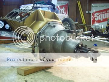

  2. Heres the engine put together....Chassis Research In/Out high gear box...

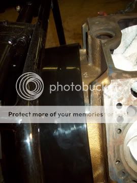

    Those ribs on the back of the block above the bellhousing had to go to clear the scattershield....so we got crazy with the cut off wheel....
    tight fit!

  4. Put the engine together....minus some internals just for a mock up photo...it will have a polished 6-71 case with an Isky front drive...and put the stubbed headers on there to try and start to get an idea for some pipes....

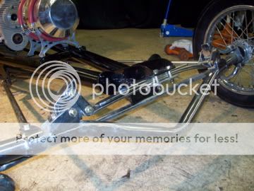

    Cleaned up the front end....made some spacers for the heim joints...and put all new hardware in...
    Remember fellas....this car will be run..HARD..

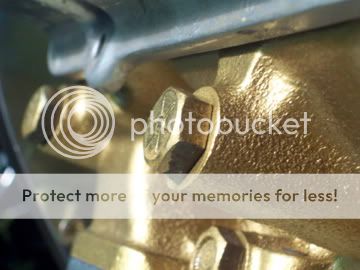

  21. Got the engine sealed up yesterday....
    Dig that NOS Chassis Research valley pan...

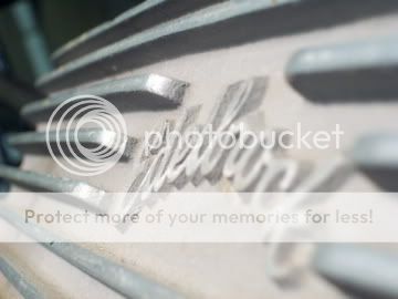

  22. Just some "close up" shots...playing with the lighting...
    T.Hilton
