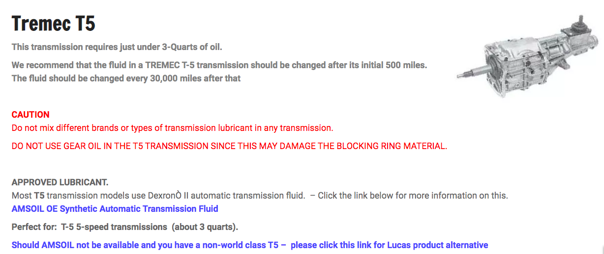

    This page (also printed and came with my brand new T5) has a note on non WC near the bottom.
    Is a Tremec any different than a BW? I don't know. So, I reckon one needs to do their due diligence and figure it out on their own.
    Also of note, the A833 4 speeds that came stock in my 70 Challenger and 72 Demon "back in the day" both had ATF in 'em from the factory. I changed both to conventional gear oil and neither one could be power-shifted after that.
