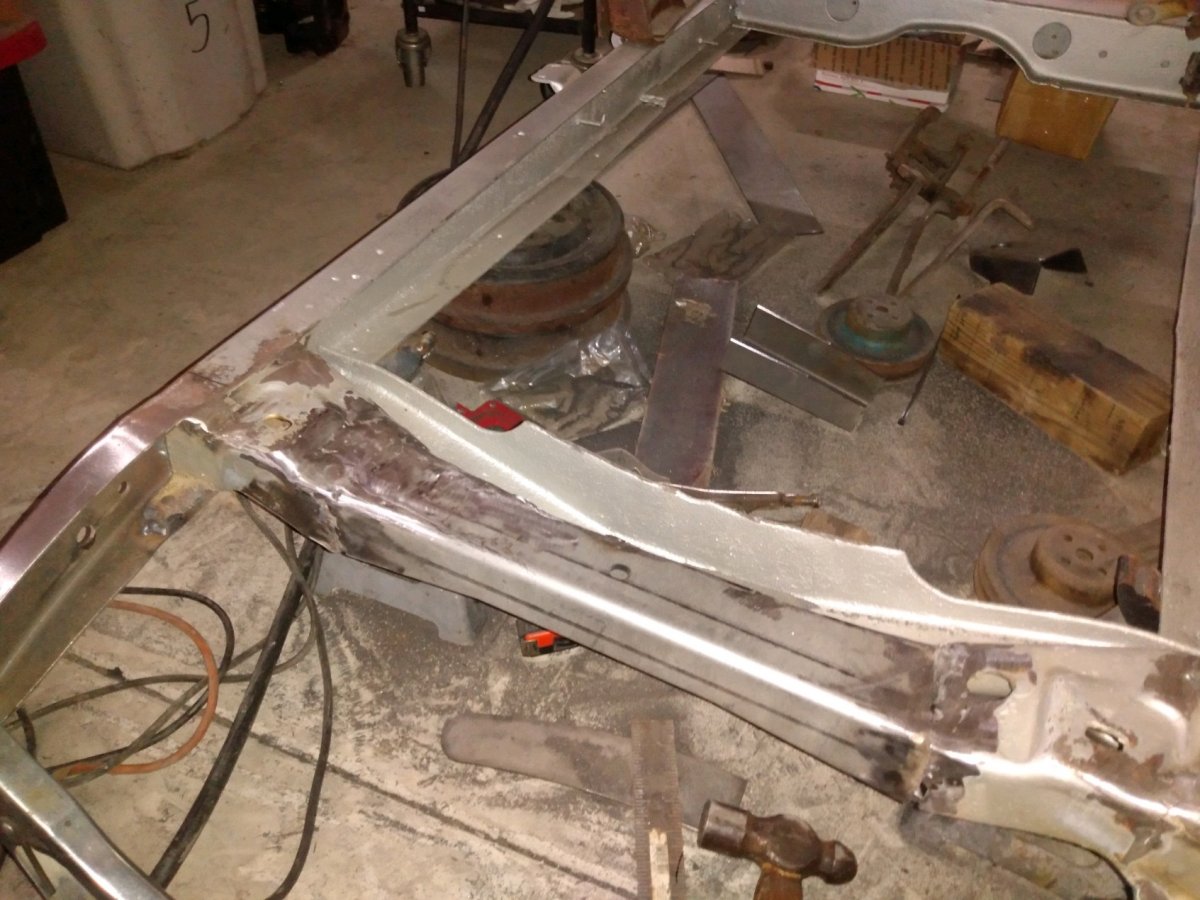

    from Maryland
    crossmember 2.jpg Stock A axle, but getting some lowering by moving the crossmember up and using a reversed eye spring. I looked at what was available as far as crossmembers. I didn't want to have a clearance issue, which I thought might happen with a total flat crossmember. So I cut the original crossmember and welded a flat piece in to give it some drop. I have a SmartCamber, so I was able to check the angles precisely before and after modifying the crossmember. My two frame rails were within 1 /10 of 1 degree of each other. I thought that was pretty amazing. I had heard the crossmember had about 6 or 7 degrees of caster. Mine had 5.6 degrees of caster. I cut the center of the member out, and welded in a straight piece. So there is still some drop to the member, but not nearly what was there. Plus I still have my radiator mount pads. I now have 6.4 degrees of caster after the piece was welded in. Welding is not done . . but it's all in place now.

    Never seen it done that way. Pretty intriguing. I need to keep watching this thread.
  3. A drop axle and reversed main leaf would've been way easier with no potential clearance issues between the frame and suspension. But since you've already jumped in, the only issue I see is that it looks like you butt welded in new metal to get your drop but now the load is just being held up by the welded areas, I would've had some mechanical support by lapping the joints so the new metal was pushing up into the bottom of what's left of the stock crossmember.

    Metal that is butt welded with the proper gap and bevel will be as strong as as the surrounding metal.
  7. mickeyc
    Joined: Jul 8, 2008
    Posts: 1,368
    mickeyc
    On metal as thin as a cross member A proper
    penetration is imperative a small gap is is all that is needed. When a part that thin is beveled little is gained
    if anything. t The photos are not clear on my screen.
    I do see what looks like a few flaws in the welds. Grinding the welds if not necessary for clearance is
    not needed. I agree with the over lap opinion on load bearing.
  8. PetesPonies
    Joined: Nov 6, 2007
    Posts: 402
    PetesPonies
    from Maryland
    What you are seeing is far away from the actual joint. I made wide fillet beads on top to get a curvature. The actual joint is welded, both sides. I do this work all the time, there's no problem with the weld strength at all.
    scrap metal 48 likes this.

  10. PetesPonies
    Joined: Nov 6, 2007
    Posts: 402
    PetesPonies
    from Maryland
    Also, I just realized that pic I posted was the first step in welding. That wasn't the completed pic. That pic was even before the underside was completely welded. Then the upper part was finished. I'll post an undated pic. It turned out good.

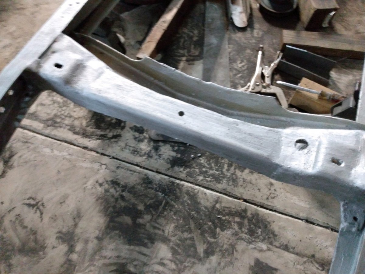

  16. PetesPonies
    Joined: Nov 6, 2007
    Posts: 402
    PetesPonies
    from Maryland
    Here's the pics of the metal finished. Then primed. So I was going to ask about the crank guide Was that to catch oil that flew out of the crank?? LOL So it's not needed at all? I see aftermarket members obviously without them.

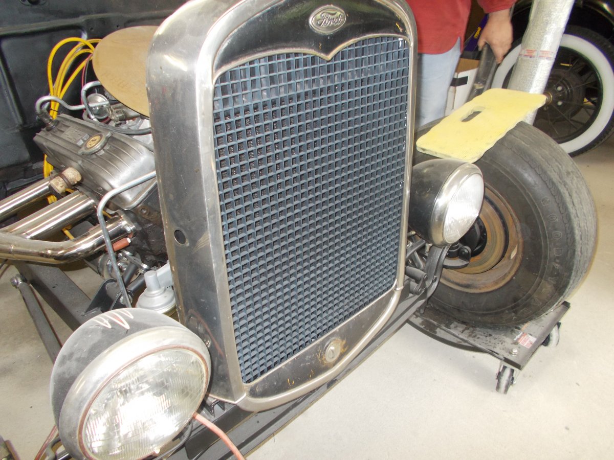

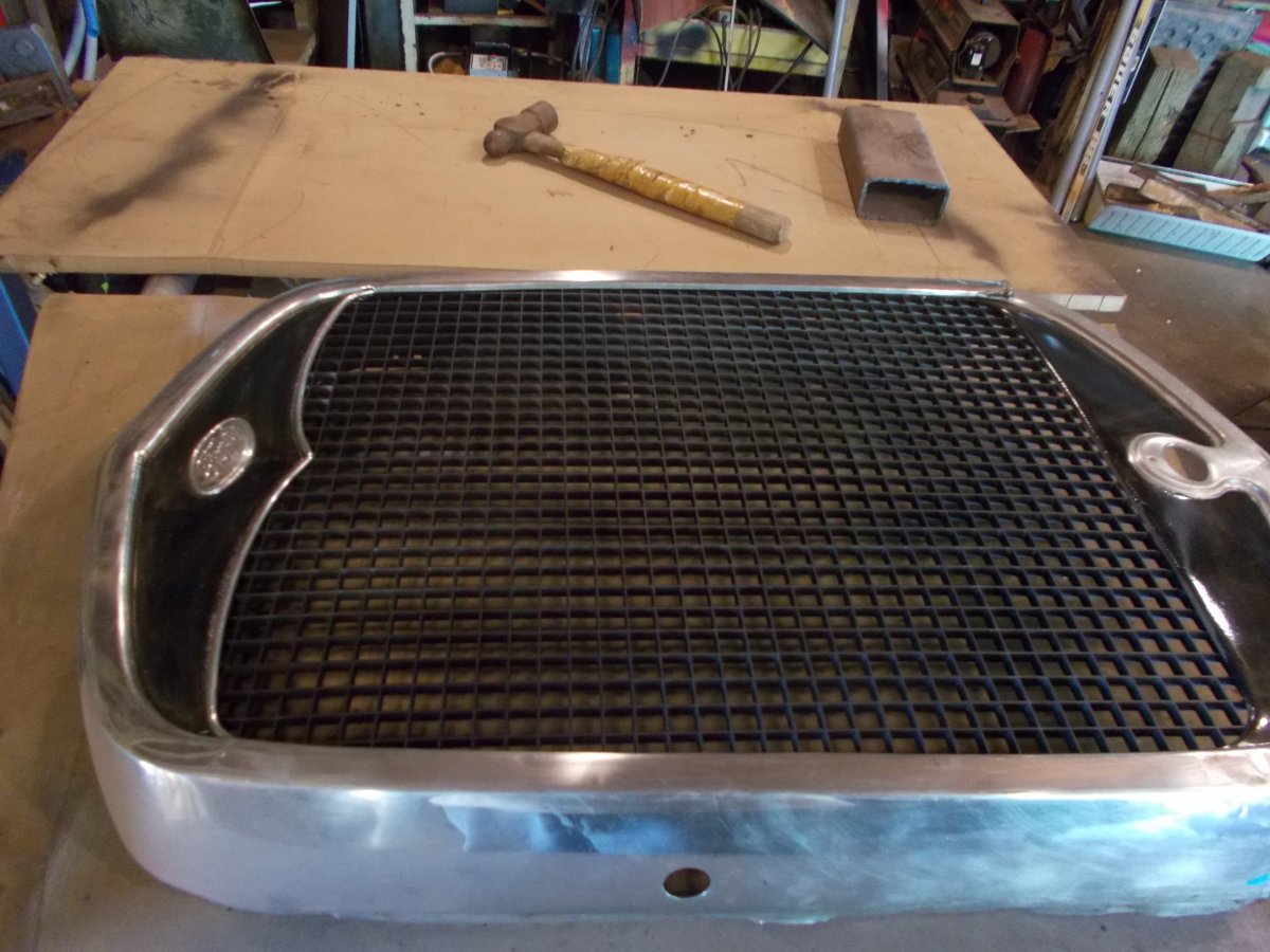

  18. sloppy jalopies
    Joined: Jun 29, 2015
    Posts: 5,256
    sloppy jalopies
    Modine # 397... '60s ford 6 cylinder pick up... cools my buddy's SBCs...
    *** heard they went out of production***
    ... if you want one, buy now...
    center fill, the top tank is trapiziodal, bottom tank is about 2" tall all the way across...
    originally mounted with a 3" wide steel flange on each side...
    trim most of it off, what is left gives a good spot to weld your grill mounts to...
    they fit in a '28 shell... part of the top tank shows... we use black painted plastic florescent light defusers… looks good...
    buddy got them for $125 apiece... I had to pay $155... did not bitch...
    my shell, '30 shell only...
    his shell with the 397 radiator... you can see the 397 top tank seam... flash makes it look grey... it is black... DSCN1074.JPG DSCN0820.JPG
  19. PetesPonies
    Joined: Nov 6, 2007
    Posts: 402
    PetesPonies
    from Maryland
    Thank you very much !! So, that radiator will fit a '30 shell too ?, is that what you are saying?
  20. sloppy jalopies
    Posts: 5,256
    sloppy jalopies
    Yes sir, the pic above your post shows it in a '31 shell...
    I feel you will need some sort of insert as the radiator looks kinda crude without one...
    '28-'29s grills are slightly wider than the '30-'31s... 3/8"-1/2"...
    the '30-'31s are about 4" taller...
    I think they used make a 3 core version …[4 wheel drive ?]
