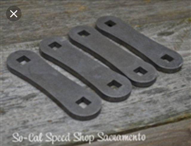

    Looks like SoCal has them
    I would say same thickness mild steel would work. Try to find some non Chinese steel if possible
