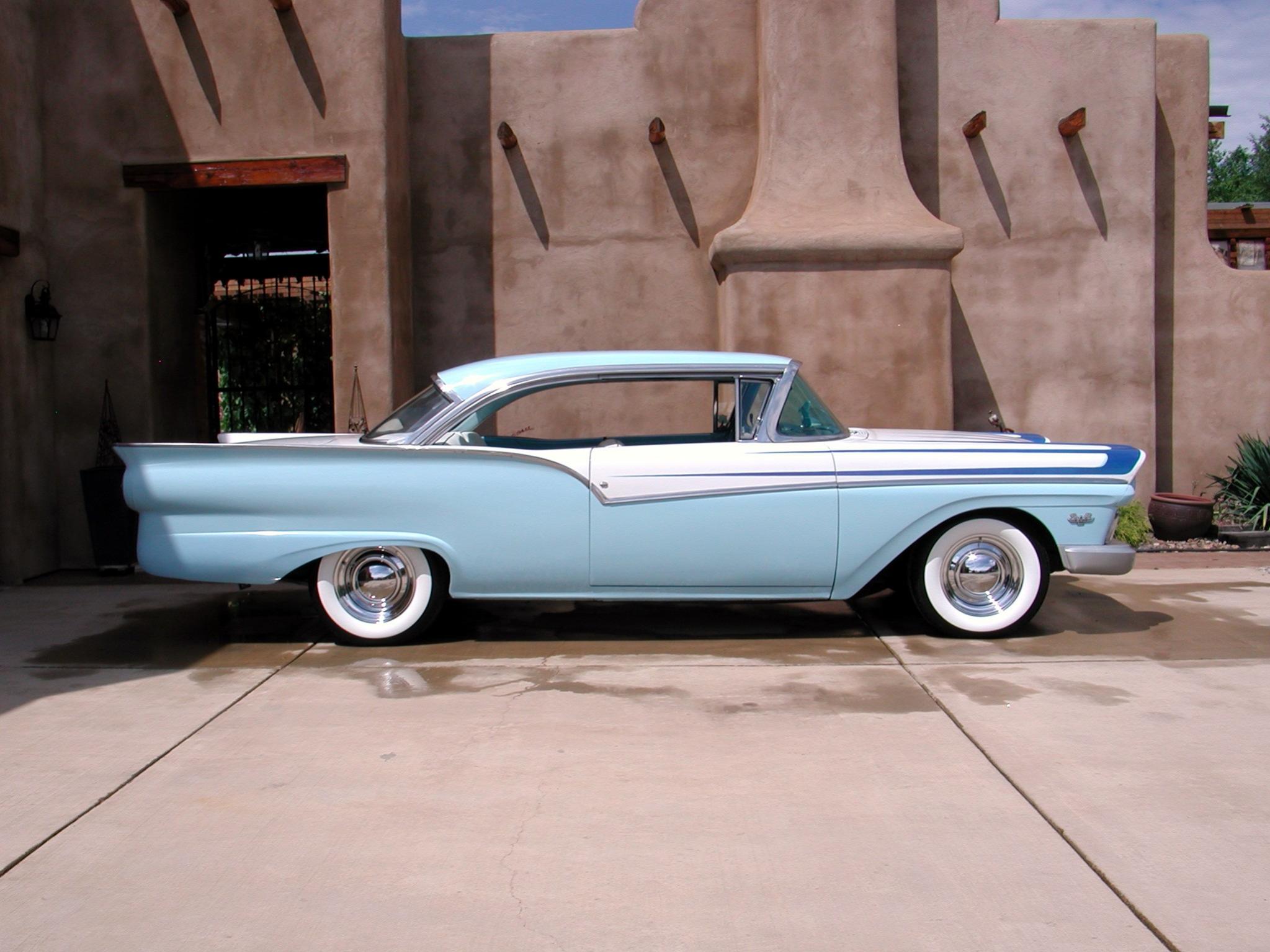

    I'd be happy with this...(this car runs same wheel/tire size as mine)...
    How do I accomplish this? can it be done without air?

    That shiny black 57 hardtop with the red side trim is sweet. Any more pictures or info.

    Thanks. They are from my vacuum mold. I hope to pull a bunch of sets this winter in red and clear and sell them.
