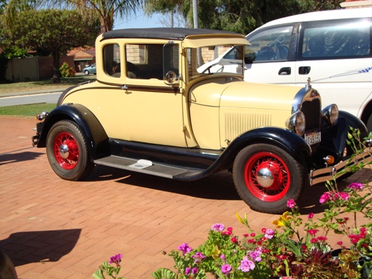

    Jan, looked at the attached image... To me, this is the stance you should be aiming for and you aren't going to be able to get there without a dropped axle up front and reversed spring eyes out back. It might sound intimidating, but it's not hard to accomplish. Just takes a little time and a little money.

    you have seen pics of my coupe. i used a 36 ford front axle ( 2 inch drop compared to a stock A), reversed eyed the spring and removed the very top 3 small leaves.. perfect drop, and a nice ride still,
    in the rear i removed 2 leaves and i was happy with the HOT ROD RAKE that it has... eventuall i will reverse the spring eyes also.

    Jan, attached are some pic's of my old stock Model A coupe that I just added 1935 front axle and removed the top small leaf from the front spring and similarly two leaves from the rear.
    Then got me a set of 1935 Ford wire wheels and what you see is how it turned out...
    I think the main leaf in the front spring did get the eye reversed.
    A 1935 axle does have a drop greater that that of the Model A stock item.
    Surely that would not cost much to acquire.
    I also used the 35 brakes for better heat disapation and stopping.

    That's a bitchin A right there! Nice!
